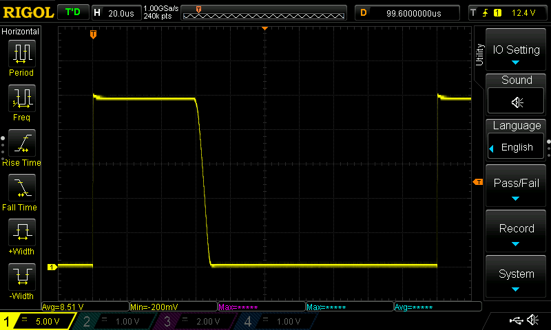

swapped out R57, gave me a super clean signal out, doesn’t change anything on the output though. following the signal through the FETs, I clearly do not understand what is happening. I send in a pwm signal and the first one spits out something odd, almost an inverse, then the second one spits out a pwm signal again. so crazy.
Not almost inverse, inverse (within the limits of behavior of the Q8 FET itself.).
The Q7 FET’s gate has to be pulled LOW to turn it on, so when you turn on Q8 you are pulling the gate of Q7 LOW, by tying it through Q8 to GND. Now that you’ve turned on Q7, it’s output on Pin 3 goes high to whatever you gave it on pin 2. Notice that the little arrow in the symbol for the FET points in the opposite direction, this is how you can tell if your device is N channel or P channel.

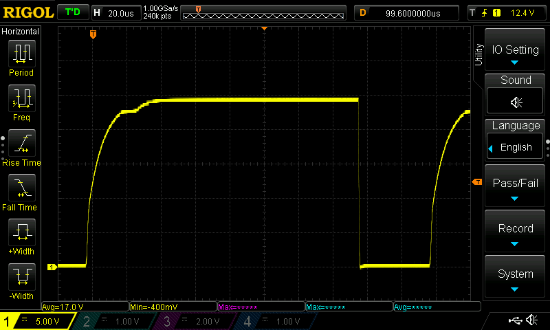

Had to try it at 24v, :grin:, rise time looks way better than the fall time still. The larger resistor on the gpio pin make that fall time much better. maybe I went the wrong way. the 1k-2.2k made the fall time better.
well, the rise time of the first inverse is horrible, completely rounded corner. I guess I will focus on this first FET then.
Yep. That’s all the detail Jono went through up above quoting semiconductor theory. This circuit as it currently is does not do fast switching well. (The Jackpot V1 circuit, however, does.)

This is the output of the first FET, guessing this is a major source of the issue.

If I increase the ratio of r6/r10 the gate will get a higher/stronger switching (Vgs). not sure if that will make it much faster though.
That’s exactly it. It’s a mildly inaccurate voltage measurement plotted vs very accurate time. Compared to the voltage range of a multimeter which is quite accurate voltage but the time part is kinda ‘now, ish, with a bit of averaging’.
There’s 3 we’re talking about. At the moment when the output MOSFET (just a switch, really) turns on, it connects pin 1 of CN2 to +V, but there’s nothing that forces that same pin to 0V when it turns off, so if there’s any capacitance there (which there always is), it’ll stay at +V for a while until it slowly drops. Adding a resistor to ‘pull down’ that voltage is one way to help that, which is just connecting a resistor directly between pin 1 and pin 2 of CN2. The other 2 resistors are R10 and R6. There needs to be 2 resistors there because the only options for controlling the gate on Q7 is Q8, which can only be on or off. If Q8 is off then R6 pulls the gate up to the same voltage as the source on the MOSFET, turning it off. If Q8 is on then it pulls one side of R10 to 0V. If there was no R10 and it was just a direct connection, the gate-to-source voltage would be the same as the supply voltage. The FET can only handle 20V so if we used it with a 24V supply, that’d get damaged. So R10 and R6 create a voltage divider meaning the gate will always be in a ‘safe’ voltage range, even when used with +24V.
I was just looking at the numbers on your gate dividers and I’d be changing the ratio on those a bit, at 5V you’re not really turning the FET on very hard at all, I’d be getting a little nervous of that. Vgs(th) can change over time and it’s often poorly specified, 3.3V on the gate is pretty low. That’s always going to be a bit awkward with that approach and I could see that Q7 burning if used for anything significant at 5V. Personally I hate high-side switching for tricky issues like that so I’d usually use something like a dedicated high-side driver IC for that process, or low-side switching. Is there a particular reason you’ve gone for the high-side switching here?
A near-term solution may be to clamp Vgs with a zener instead of just using the divider. It’ll be less efficient but will solve that particular problem.
Bear in mind that Q7 doesn’t switch on from 0 to -5V on the gate, it starts switching from off to on at Vgs(th) which is -0.8V to -2.2V and then is probably turned on completely by the time another volt is added (well, removed in the case of the P channel). So your important part of the gate waveform isn’t the whole thing, it’s maybe -1.5V to -2.5V, that’s the bit you need to be fast.

I assume you mean change the divider so it applies more voltage to the gate? That will work because your critical point is the -1V to -4V range, so given that you’ll always get that same RC time constant shape, having it end at a higher voltage means you’re transitioning through the 1-4V range faster. The downside there is that you’ll lose the ability to work at 24V without blowing up the gate on your FET. The compromise there could be a zener tacked across R6 to limit Vgs to ~15V or so but that needs some care because the zener will then be dissipating some power which means R6 needs to be sized carefully as it will have potentially 9-10V across it. Not impossible, but it’d be easy to make it a bit ugly.
