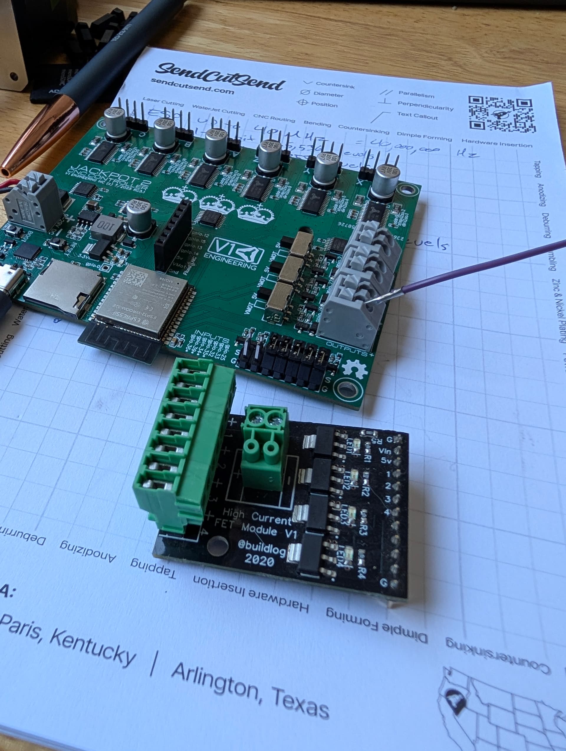

Well I guess I should have looked around more. Bart does have one, Quad MOSFET Module · bdring/6-Pack_CNC_Controller Wiki · GitHub but it looks a little questionable at 5V I think. I bet I even have one here.
Edit… dang it.
I can test this at 5v to see how fast it is. Going to feel real bad if this works fine.
Would one of them work for the laser? Or are all of them being used since I have a pendant?
All of them! This module I just found should work fine, or he has another one for low voltage specifically.
Don’t buy anything yet, let me try to make it right first. I will make sure the first of you that have a jp2 will get a fix or replacement.
That FET module looks like it’s low-side switching. It’s a slew-rate limited driver which is nice at 2V/us turn-on so won’t be super quick but should still be fine, but 0.8V/us turn-off which could be a bit slow without a solid pull-up on it.
It is not working at 5v unless I am doing something wrong.
Sorry, what is not working? Bart’s MOSFET board?
Edit: Oh, never mind, I didn’t realise you had one in front of you.
One comment about that, when Ryan was working through features for the new board, we talked about using the upper two GPIOs of the expansion module for the pendant interface, which leaves “Most” of the expansion boards able to to be used with the pendant installed.
The quad MOSFET board would be a little sketchy because… it uses all 4 GPIO, the upper two of which are shared with your pendant ineterface.

Correct. I gave it 5v from the board, there is a good signal at the right pin, the other side of the mosfet is a weird 0.5v pulse.
Do you have a pull-up on it? It looks like it’s an open-drain output so it has the same issue as your outputs, just upside down.
With the open-drain output it can only be in 2 states, high impedance or low impedance to 0V. If you’ve got a scope probe on it, both of those states will look pretty similar.
Oh dang. No pullup, just as is. If this is the future jp2 route I can solder on some pull ups.
From what I remember it was more of a issue with having output voltage on the pins at all times, from a “don’t pop the board” situation. I came up a handful of times I just don’t remember specifics.
So yeah, that’ll then have the same issue but opposite. Fast turn-off, slow turn-on depending on the pull-up strength. Low resistance pull up will be faster but waste power/get hot while the switch is on, high resistance will be slower but more efficient.
