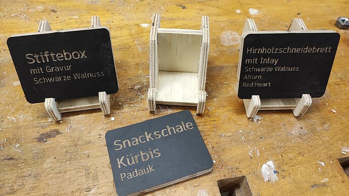

Cheers everyone, as promised in my Schneewittchen thread, I am going to publish the plans for the French Cleat I am building as I go along. I didn’t find good dxf’s on the Internet, so I decided to make my own. Some of the plans have not been cut yet, because I just created them. As soon as they will have been cut I am going to take pictures.
I use 10mm multiplex for most of the holders, the small boxes use 6mm thickness.
Clampholder: I cut this one, but it is a little too deep and is a little wobbly. Still works. You can see it in the picture above. Schraubzwingenhalter groß.zip (21.3 KB)
The new version, not cut yet. Schraubzwingenhalter klein (neu).zip (21.5 KB)
Screwdriver holder: Works pretty well. See big picture. Schraubenzieherhalter.zip (21.4 KB)
Chiselholder (now Fileholder): Holes weren’t big enough for my chisels and I can’t count to six, so I am now using it for files. New version for chisels below. Beitelhalter.zip (24.9 KB)
Chiselholder (New and working): Beitelhalter New.zip (24.7 KB)
For hammers: Hammerhalter.zip (21.1 KB)
Little boxes: I use them for screws at the moment. Kaestle 80x80x100.zip (3.6 KB)
Bitholder: Bithalter.zip (23.9 KB)
Pencilholder holder. Stiftehalter.zip (22.2 KB)
Wrench Holder: Schraubenschlüselhalter.zip (24.4 KB)
Tape Holder: Rollenhalter.zip (27.3 KB)
Folding Rule Holder: Zollstockhalter.dxf (147.9 KB)
Cordless Drill Holder: Akkuschrauberhalter.dxf (167.7 KB)
Drill Bit Holder: Bohrerhalter.dxf (144.2 KB)
No picture yet.
Bin Tray Single: BinTray Single 100x80.dxf (97.6 KB)
I also created a second version that you theoretically can reach into better (haven’t cut it yet though):
BinTray Single More Open 100x80.dxf (97.7 KB)
Bin Tray Small Double: BinTray Double More Open 2x60x48.dxf (108.9 KB)
Box for gloves: Handschuhbox.dxf (125.6 KB)
Small shelves to put stuff on (two sizes): Regale.dxf (133.3 KB)
Holder for signs (or actually, a mobile could also work): Schilderhalter.dxf (123.5 KB)
