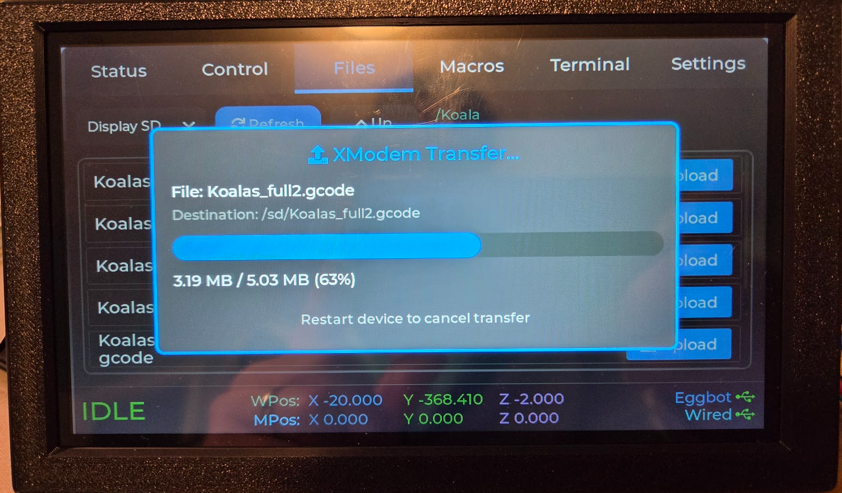

Tonight I was intrigued to implement uploading a file from the display SD to the controller when using a wired connection. I’m not sure I’ve seen a wired pendant do that. Wirelessly, it’s just an HTTP request but that doesn’t work wired. It required using XModem for the upload like FluidTerm does. I told Claude to use XModem and referenced FluidTerm. It did a little research, looked at the FluidTerm code (which is Python), and had the upload working in one shot, with other minor things to tweak. Fun.
[vader voice] IMPRESSIVE. MOST IMPRESSIVE. [/vader voice]

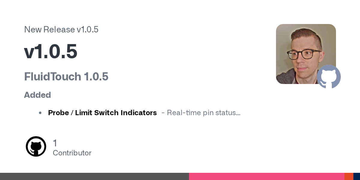

FluidTouch Release v1.0.5
  • Probe / Limit Switch Indicators: Real-time pin status — probe indicator on Control → Probe and the Status tab; per-axis limit-switch indicators on Control → Actions and the Status tab. Triggered indicators stay visible for 500ms so brief activations are easy to see
  • Terminal History: Terminal tab retains command history — recall previous commands for re-sending
  • FluidNC Version on About Tab: Settings → About now displays the connected FluidNC controller’s firmware version
  • M7 + M8 Coolant Display: Status tab now correctly shows both flood (M8) and mist (M7) coolant when active simultaneously
  • A-Axis is Per-Machine: A-axis enable/disable is now stored per machine instead of as a global setting, allowing mixed 3-axis and 4-axis configurations
  • Library Updates: LVGL 9.5.0, LovyanGFX 1.2.19, ArduinoJson 7.4.3
  • ESP32 Platform Branch: Switched to Arduino/IDF53_gcc15 after the previous upstream branch was removed/renamed

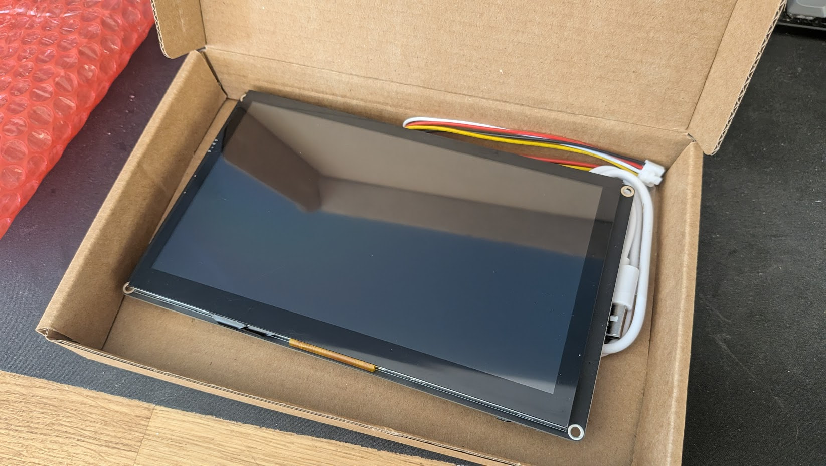

I ordered an advanced a few days ago, switches, and battery are here. Just need to print the case before the screen shows up.

Hey! Look what showed up in the mail today! :slight_smile:
OK, now need to read some stuff cause I ordered this without event knowing what it was about, just supporting a fellow v1e member :stuck_out_tongue:
If you have anything you need from the v1 shop I have a spare switches I can throw in.

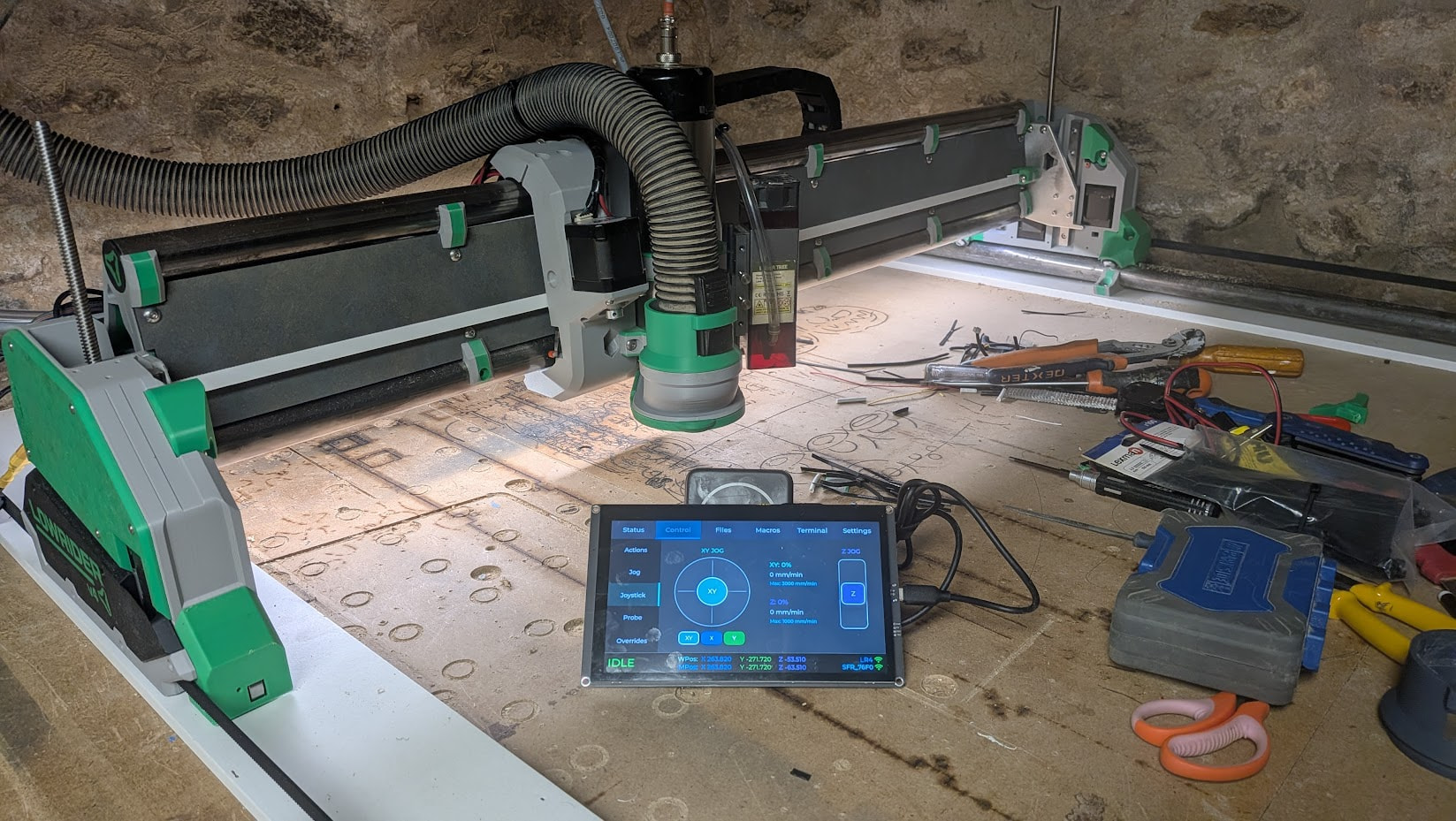

Me, literally 10 minutes later, having read absolutely nothing… just googled “install fluidtouch”, connected an usb cable and clicked OK…
@jeyeager, sir, you had me toroughly impressed!
Ok, I started reading….. but then a friend came by with a beer bottle….
Now I’m trying to read… again… and it’s much harder :smiley:
Jokes aside… made a few search on printables and on this topic, I’m looking for a case/stand that could take either a direct USB power source, or a magsafe external battery (from which I’m powering the tablet in the picture)
Did anyone model something like that?
f not, does anyone have a link to the dimensions of the panel so that I can make and share one?

What I’d like to achieve is making the crowpanel “fit” in the magsafe ecosystem
Let me explain…
If I have a panel case with a magsafe-comaptible “input port”, I can power it by just sticking a magsafe external battery behind, or stick the panel on a magsafe supprort connected to an USB charger.
Some external batteries even double up as makeshift “stand” which is very handy…
Better yet, if the panel/case has a battery, it can be charged by the magsafe charger stand, or even the magsafe external battery.
It’s a totally transparent/flexible system, plus you can leverage existing stands and solutions rather than re-inventing/re-printing everything
In the end, the elecrow panel would act just like an iphone/ipad, seamlessly charging/powering from ubs/battery, and being fully compatible with an existing ecosystem
I’m curious how that plays out. I tried using a wireless charger and that didn’t work. If you have a battery that plugs in via USB and that battery can charge via magsafe, maybe that would work? I spent longer investigating battery solutions than I cared to.
