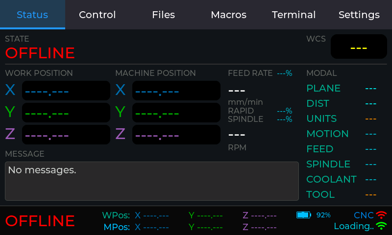

@jeyeager Here’s the pull request for the battery meter using the board I mentioned: Add Battery Meter Support by anant-singh · Pull Request #46 · jeyeager65/FluidTouch · GitHub . There are unfortunately multiple issues with this approach as well.
  1. When you plug it into charging it takes a while before the meter changes to show that it is charging.
  2. Even at full charge it only shows up as 92% charged for my battery. Don’t know why that is yet.
  3. The board with the standing jumper cables are huge for the case I printed. So it’s currently dangling outside the enclosure. Need to either find ways to flatten it or print a different enclosure.

Ok, when I get a chance, I’ll order one of those battery meters and see how it works. For the simple voltage divider, I removed the cap and it still didn’t charge long. I need to try with 100k resistors on that. So, I probably won’t merge anything until I sort out how all of this goes together. I’m not sure where yet, but that battery indicator will need to go somewhere else since that blocks longer machine names.

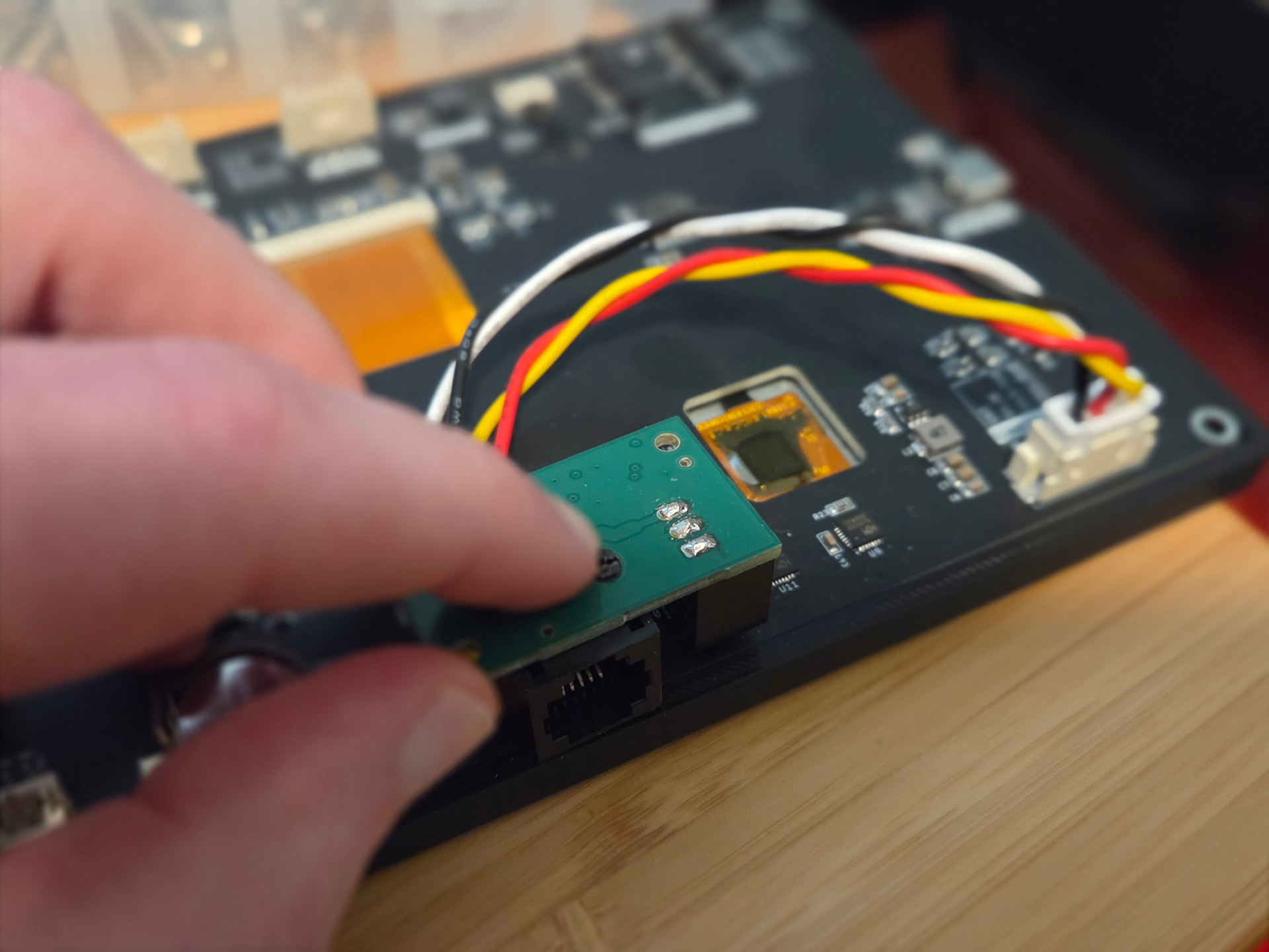

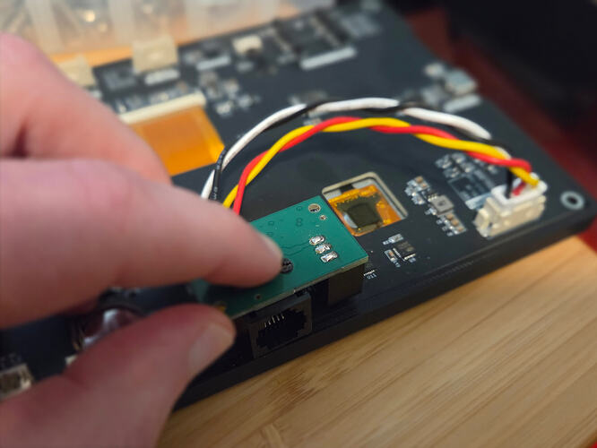

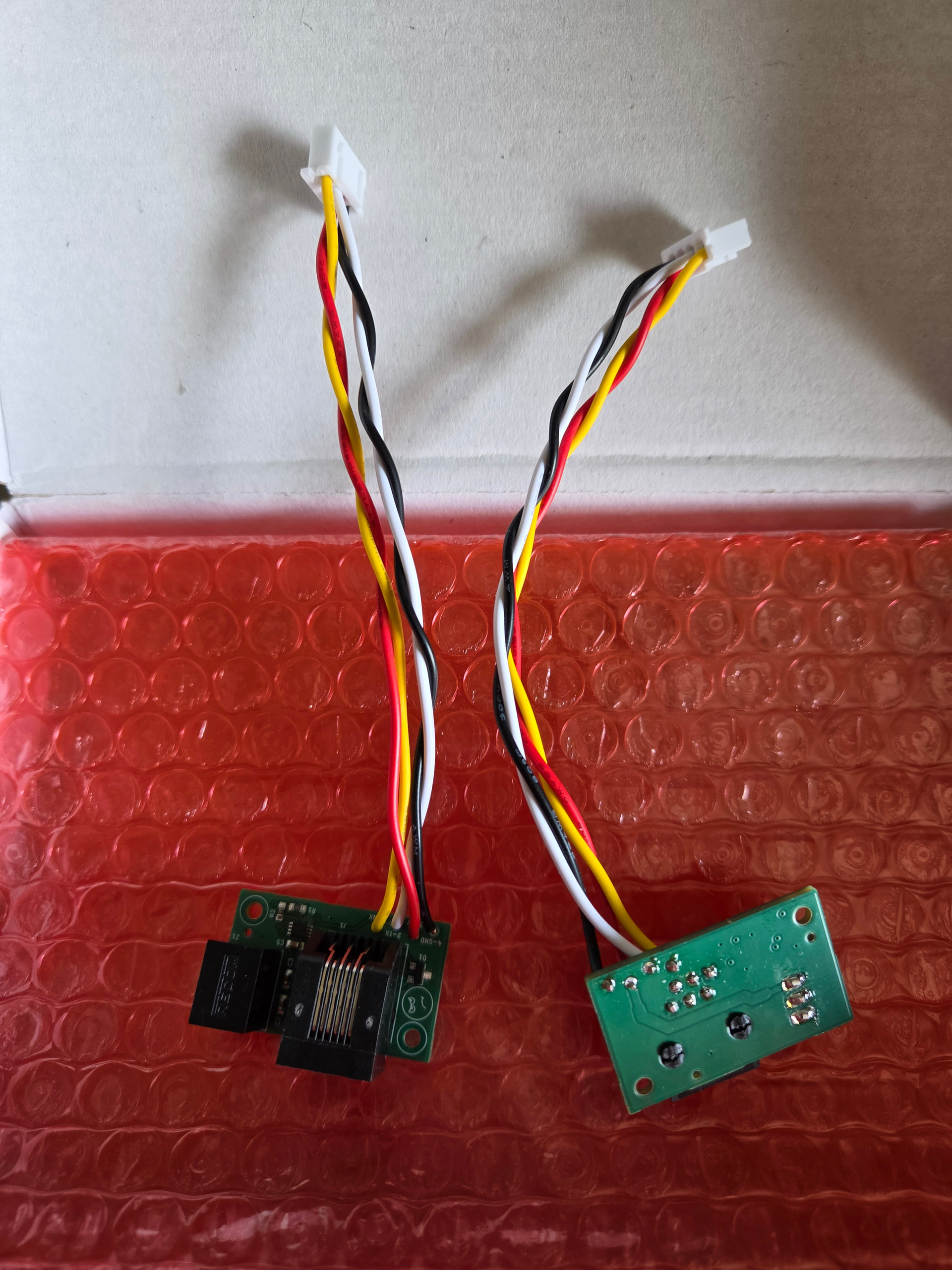

Someone is also sending me a little PCB this week for a wired connection, so I hope to mess with that a bit this week as well.

I still expect most people to use wireless mode. But there are certainly places where a wired connection is needed. Too bad I didn’t have this ready for RMRRF.
You are a feature wizard. Super cool to have the options. I think I am going to ditch my tablet in favor of your system once I print the case for it.
Thanks for all the hard work.

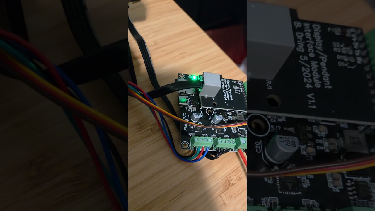

I didn’t do anything with the hardware side of the wired adapter. Someone on the FluidNC Discord offered to help and sent me a couple. It uses the 12v/24v from the pendant connection and steps it down to 5v so voltage drop isn’t an issue. I designed it with this idea in mind, but Claude still did most of the software work. It’s a fun project and I’ve learned a lot.
It looks great!! How can we supply that hardware?
