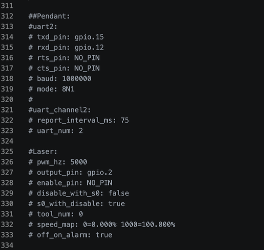

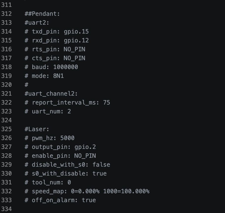

Pendant:
and I think it should be commented. I removed both ## and I think that causes the troubles.
This is how it should be I guess:
#Pendant:
I will check tomorrow when Im Back at home.
Thanks, I think that’s the problem and I will try this $$ thing. never done before….
How do i do this $SS output thing? Never done before sorry for asking….
There is no pendant tag at all. Sounds like something AI made up.
You just enter $SS in the terminal in the WebUI.
Hi this is the screenshot from the config at FluidNC_Configs/MPCNC/Jackpot3/JP3_MPCNC at main · V1EngineeringInc/FluidNC_Configs · GitHub
Guess my mistake was that I removed both ## from pendant…. Now it make sense when you say it shouldn’t be there at all.
ill try that tomorrow
Thanks, for your quick replies, I appreciate that a lot.
If there is a # at the start of the line, that line is commented out and has no effect.
Yep i understand that but I removed the # before Pendant completely. And so I guess this causes the issues. I let u know tomorrow if it worked.
Hi Jason,
it was the mistake that I removed the # before Pendant. now all is working perfectly.
