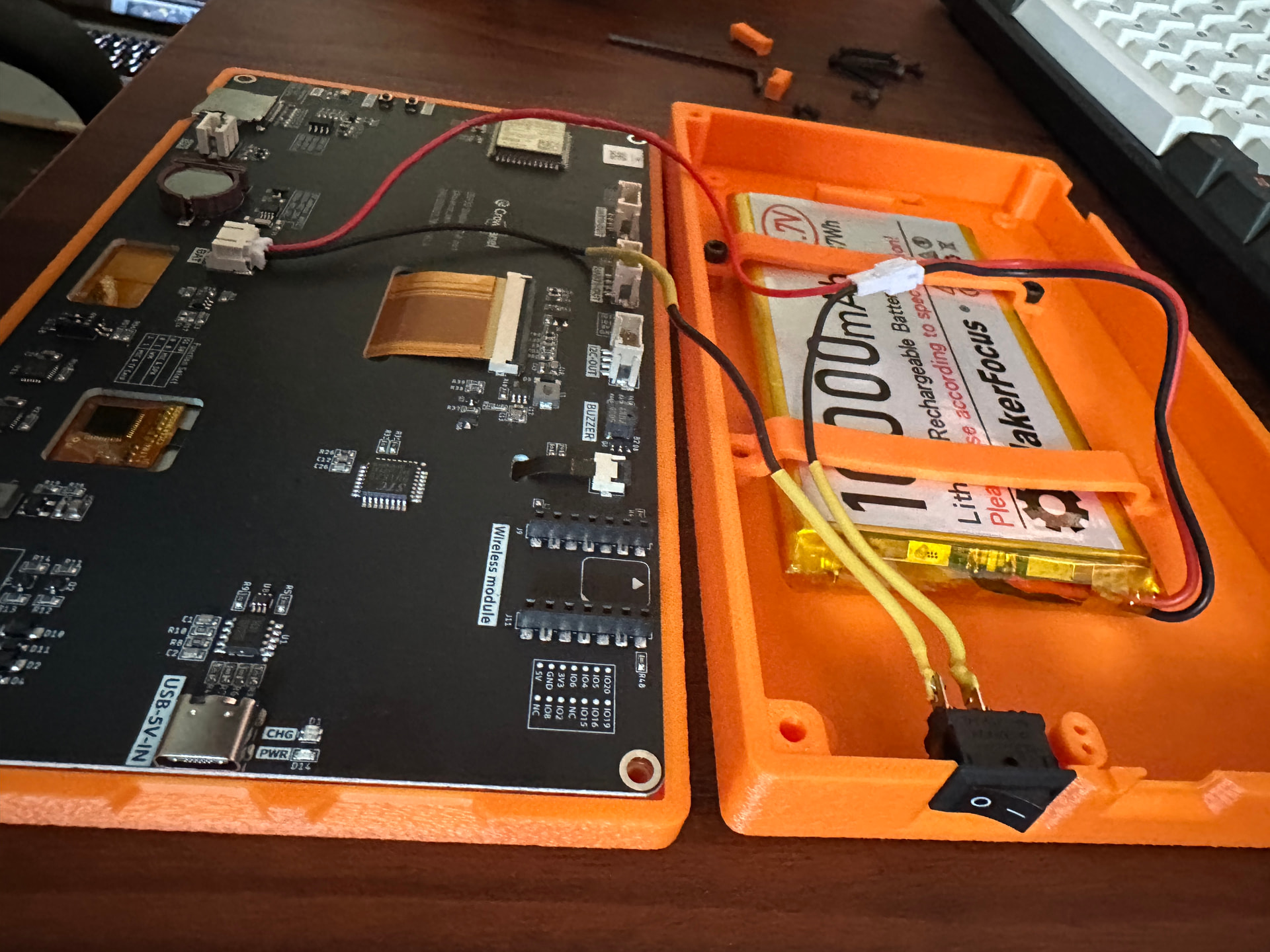

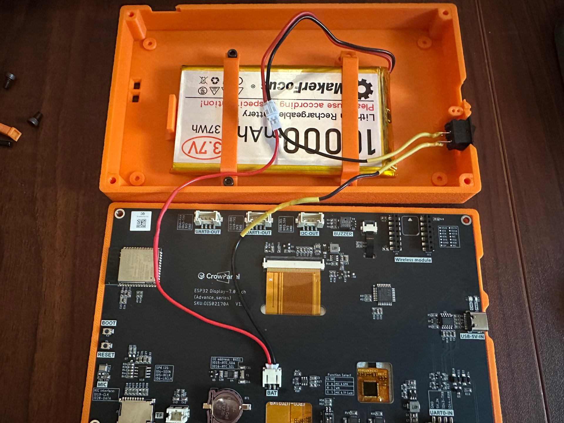

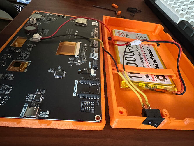

I’m having a little trouble with my pendant build. Specifically, even after charging (red light on) for over 24 hours, the switch does not turn on the device on battery power. It does function wired and I was able to flash the software with no issues.
I’m wondering if I’ve misinterpreted the photos and polarity statement.
Photos of wiring:
Please let me know if there are further details I can provide. Thank you!

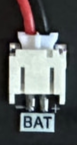

You have the polarity backwards. Red is positive.
Notice the + and - on the battery connector.
Thanks! I will take some time today and try to fix the wiring there. I think this statement is throwing me off and had me thinking that the polarity should be reversed: “*** MAKE SURE THE POLARITY IS CORRECT - ALL BATTERIES AND WIRE COLORS ARE BACKWARD TO DISPLAY BATTERY PLUG ***”
”Backward” might be the word that is causing my confusion.
That connector does not guarantee proper polarity?
The connector only goes in one way but the battery and board assume differently. I swapped the wires in the battery connector.

Reversed the wiring and everything works now. My eye is twitching at the wire colors being wrong, but quickly fixed by closing up the case :laughing: Thanks again!

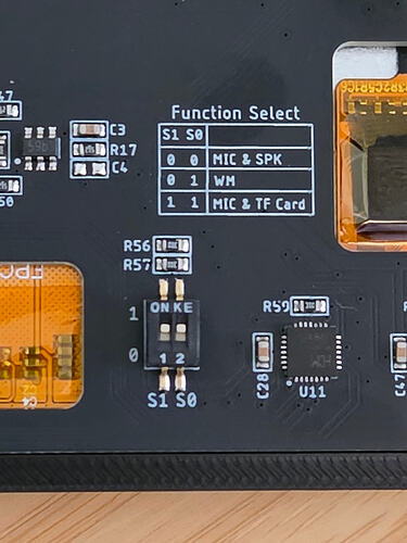

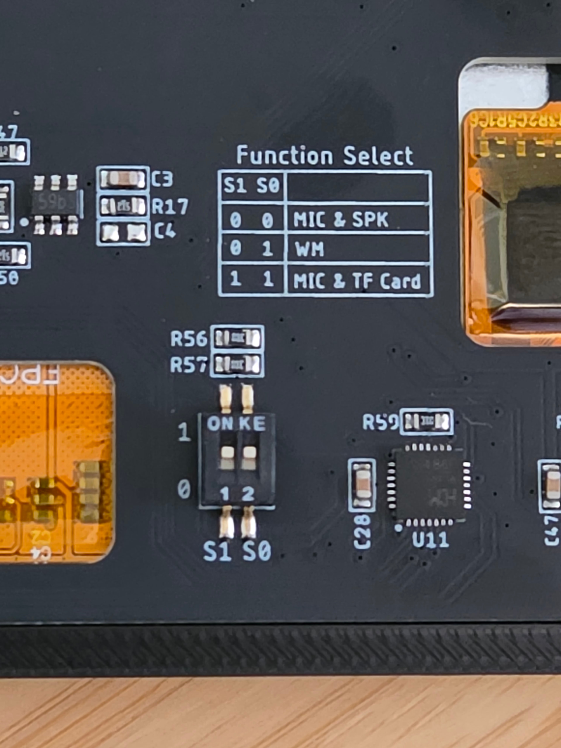

I used for the first time my new 1.4 screen with 1.0.4 FluidTouch. The same SD card I was using with the 1.3 version of the screen it is not recognized anymore. Any idea?
I’m guessing you just need to change both of the switches. They both need to be 1 for the SD card to work.
