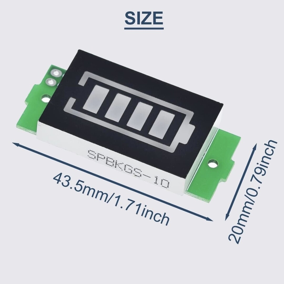

You’re right that we don’t need continuous monitoring. The ones I’ve seen are pretty large though.
I wonder if these would work…
https://www.amazon.com/DGZZI-Lithium-Battery-Indicator-Capacity/dp/B0FRF5X4BX
Those are the ones I’ve used, but I thought I’ve seen much smaller ones, or at least designs to make smaller ones.
When I get a moment, I’ll try to find something again.

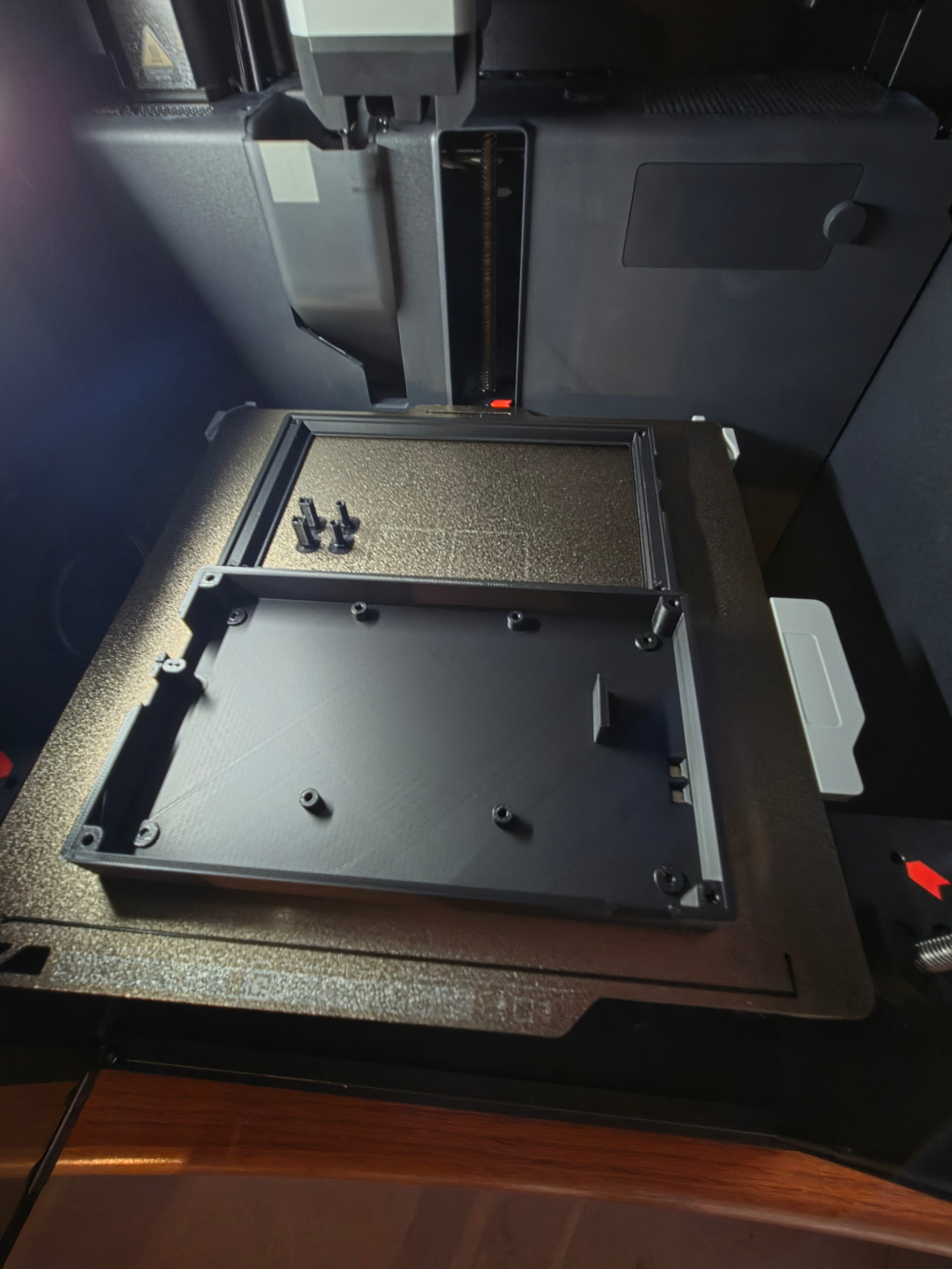

I just started a print of the whole case. Then I’ll see where I’m at.

Mmmm… hot off the printer.

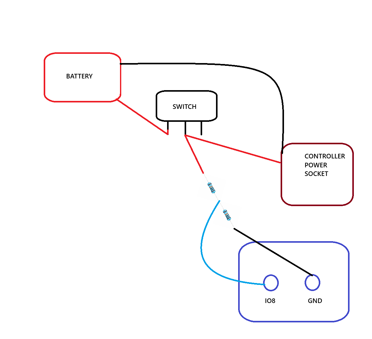

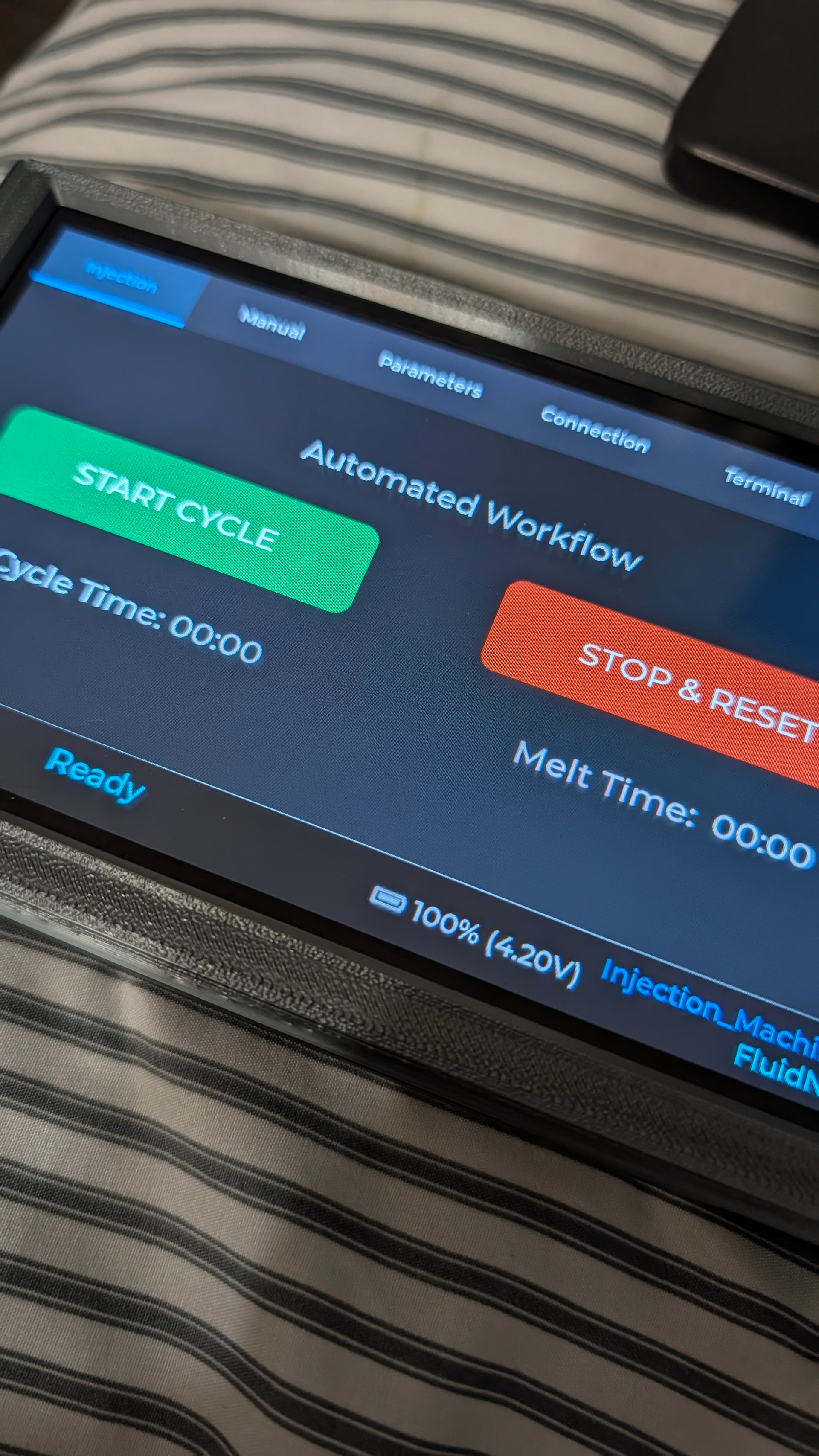

I connected two 100k ohm resistory paralel switch and connected and resistors IO8 and gnd in wireless module. It reads a percentage from the battery but i am not sure if it is correct. I havent charged also. I will test it these days.
Yea, ultimately we’re translating voltage to percentage. I guess it’s not linear though. I also saw that the voltage changes when it’s charging too. It’s probably better suited for a rough gauge.
My main problem is that it seemed to mess up the battery charging from USB.

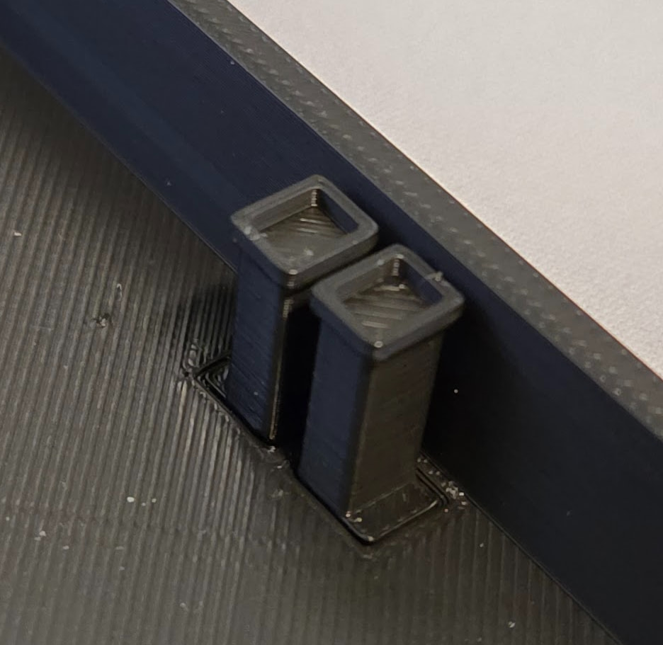

Give this a try.
ElecrowCase_20260402-Button-v1.4.3mf.zip (14.3 KB)
Like the other one, it probably needs a brim. I set the brim-object gap to 0.5mm to help it come off a bit cleaner. They should sit in the openings (without getting stuck) and then just put the case on top.

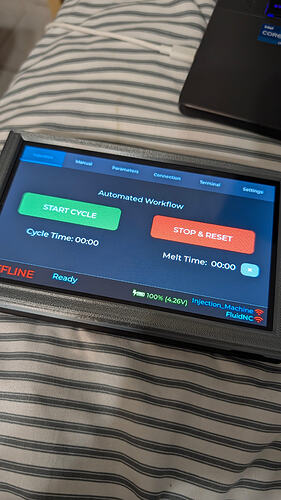

I just started testing. Now it is fully charged. Lets see.. If you guys want to try, I added a note file that written by ai. You can ask AI to integrate for your build. 2x 100kohm resistors used.

Does the battery still charge properly from the USB port? Mine charges for less than a minute even though it’s not full and then the charge light goes green. The differences are I’m using 1M resistors instead of 100K to reduce power usage. I also have a capacitor to smooth out the ADC readings. I’m also using GPIO2 instead of 8, which I knew was another alternative.
Can you show a picture of how you have it wired?
It is early for me to say something but it looks like it is charging. I forgot the combination I think first switch on so it will use battery then plug in.
