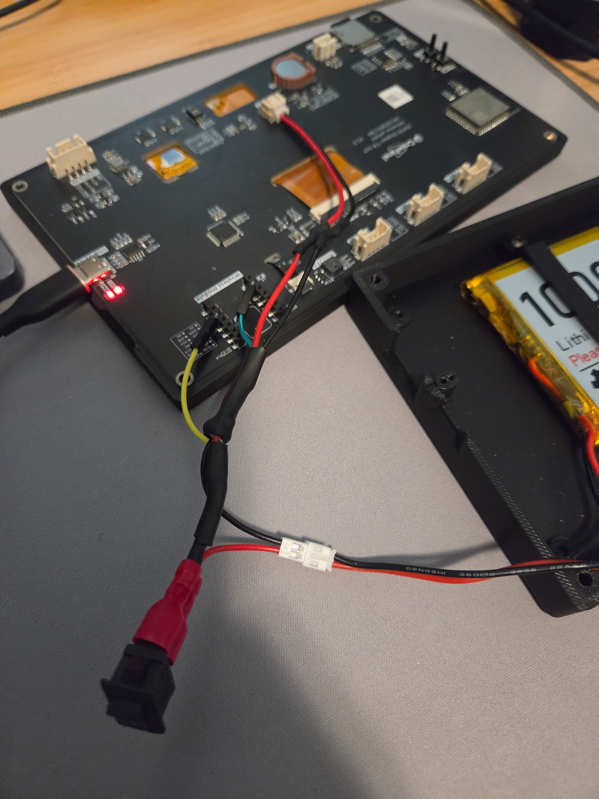

There’s a charging light that turns green when fully charged. I’m going to try adding a voltage divider so I can read the voltage. That should be possible on the advance display but not the basic display.

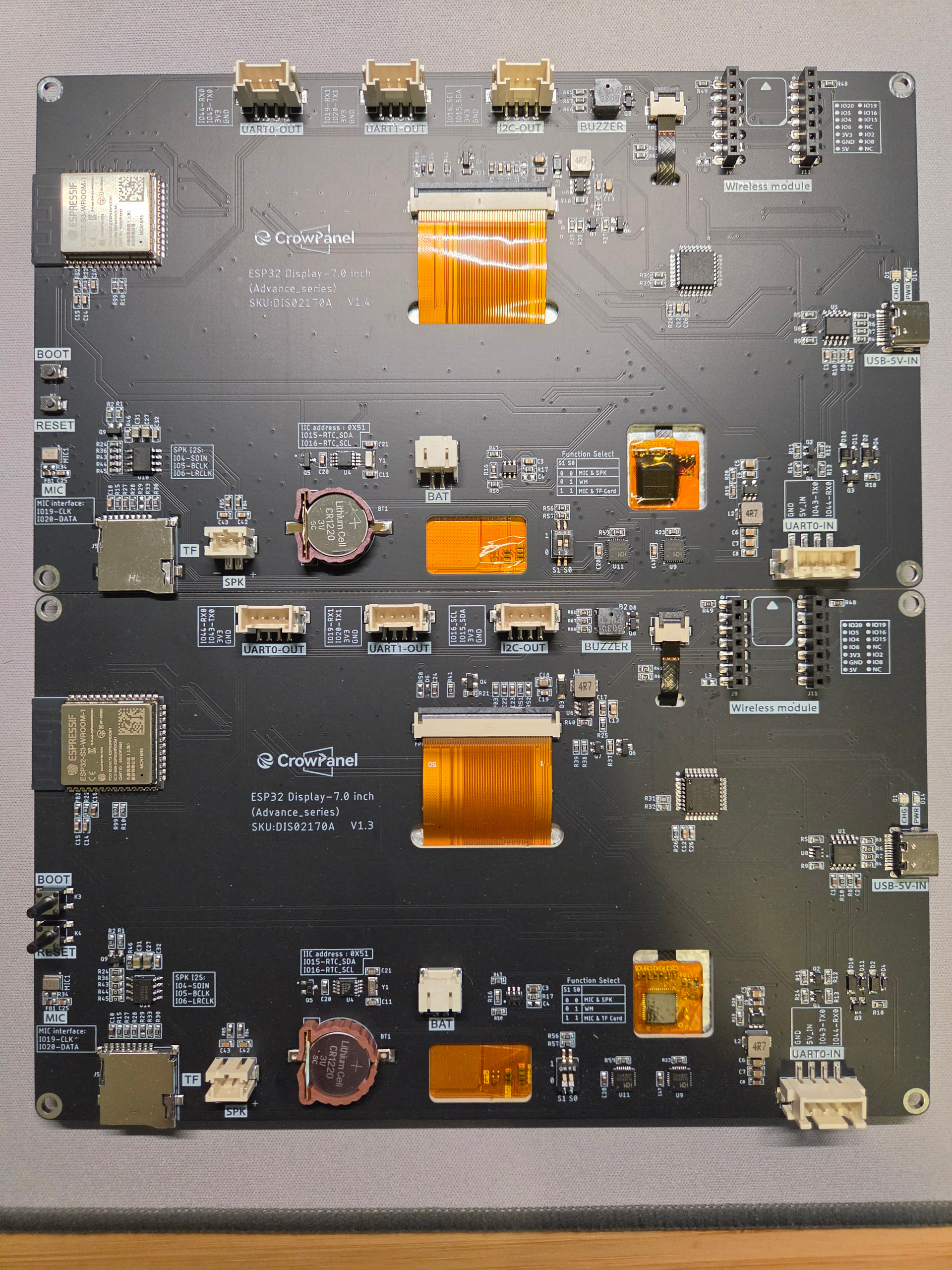

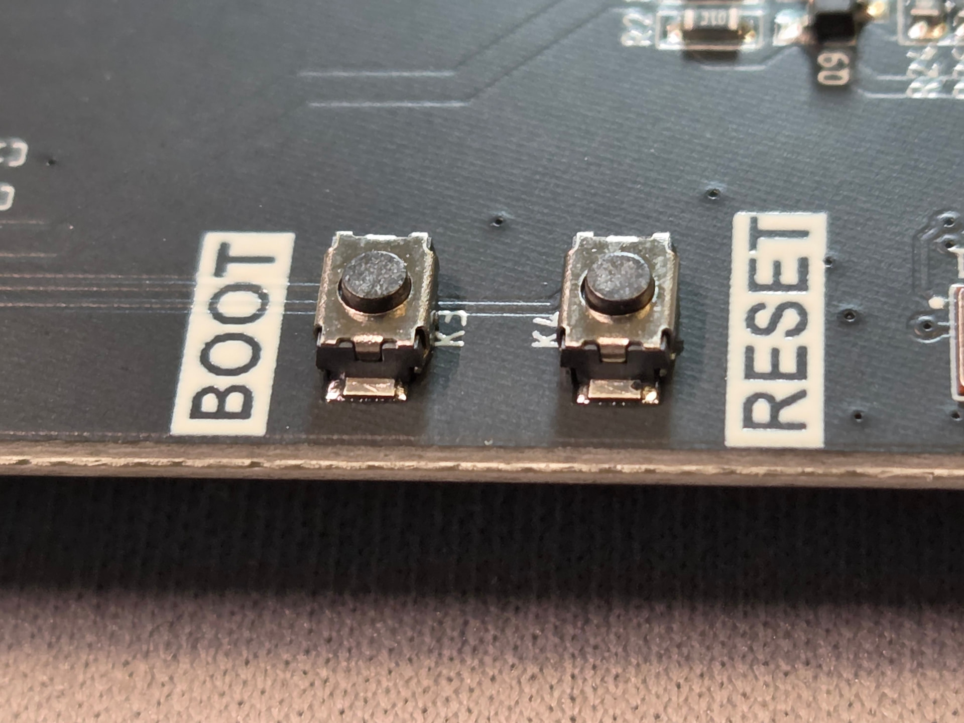

After a close look the only difference I see between v1.3 and v1.4 is the boot buttons.
But ugh why did they have to use such tiny buttons. Might need a new button strategy for my case.
My second is v1.4 too, but on the website was written 1.3. Was yours withouth safety foil?

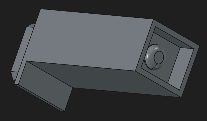

It looks like I should be able to just make different buttons for v1.4 with the same main parts of the case. It needs some more tweaking but I need to print another full case.
I should receive a 1.4 in the next days as well. Happy to test the buttons.
I added two boxes/channels on the bottom plate which cover the buttons on the board, so it guides the pins and keeps them in place. And I made the printed buttons longer so I can still press the short buttons. They a bit loose in the case, but it works. However I think some kind of 3d printed spring buttons would be better.
Same - I got the boot switch replaced and ripped all the pads off the reset being stupid removing the broken switch. The pads on the Elecrow are a bit fragile.
My guess is they were getting a lot of people ripping the old version of the tall switches. The ones on the 1.3 are way too easy to break off. I didn’t even realize I had broken them off at first and was quite gentle assembling the case. Both switches were wrecked and unusable. Stuff happens.

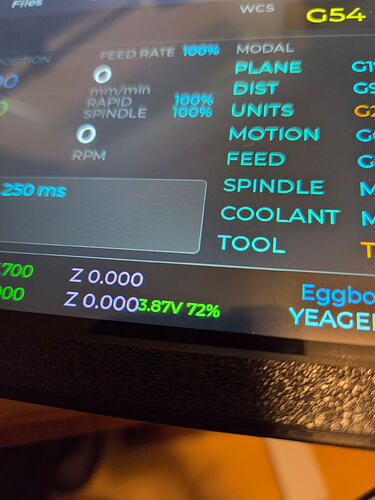

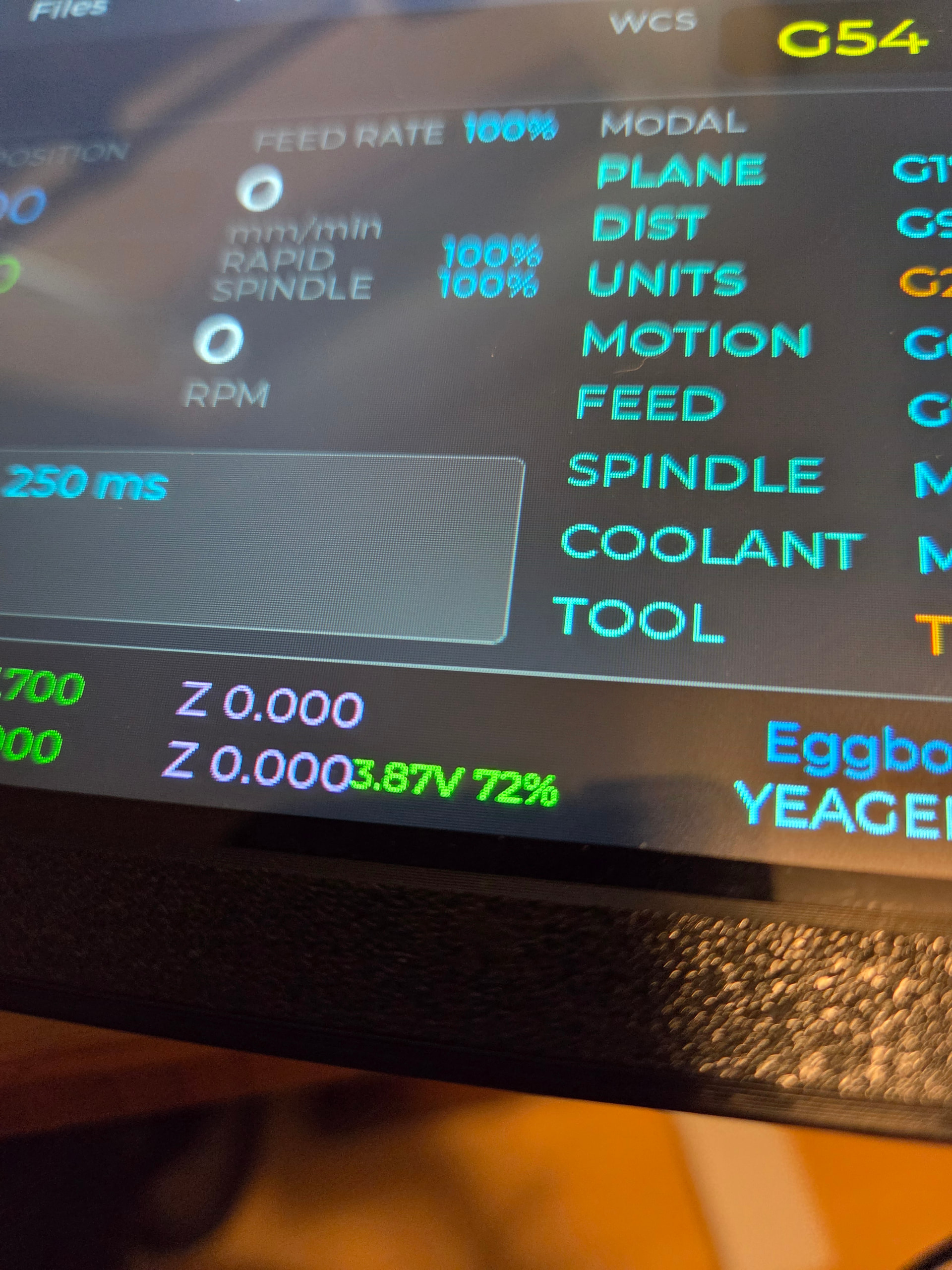

Well, good news and bad news on measuring the battery. The good news is I can do it despite my crimes against electronics. The bad news is that the voltage divider messes with the onboard charging so it will only charge for a short time. So, I think that kills the idea.
I used 2 1M ohm resistors and a 0.1uF capacitor.
