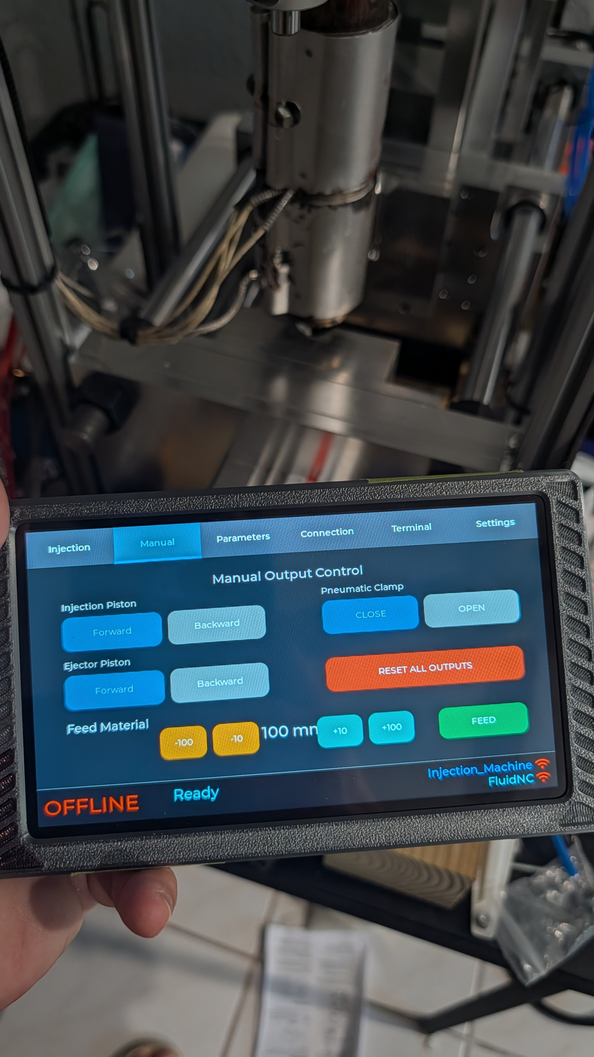

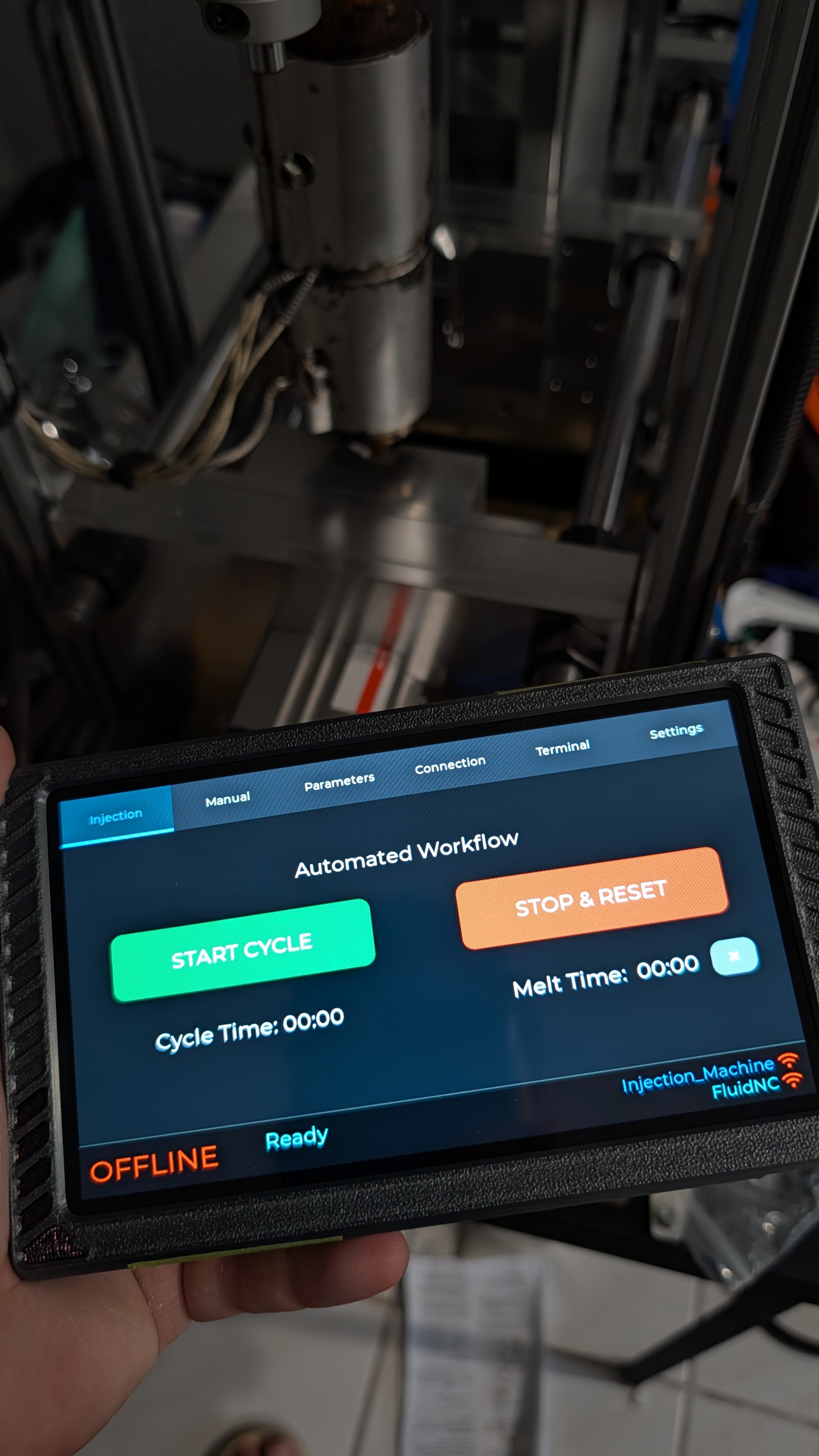

Thanks for you efforts. I am printing the case now. Also I would like to share my modification from your ui. I tested and it works great. I used port 80. I connected the lipo battery but it dont have the switch yet. Do you mean wired directly to the Jackpot3 controller? That would be amazing too
Nice! Hopefully that simplified making a custom UI.
Yes, someone is helping with a custom board to connect via the pendant connection on the Jackpot. This might be awhile yet.

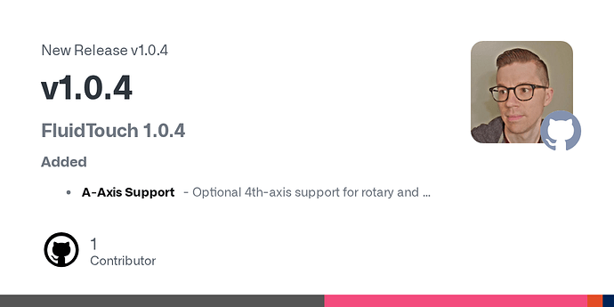

FluidTouch v1.0.4 is released. If you are already using v1.0.4-dev, it’s the same thing. It’s just documented now.
Changes since v1.0.3:
Added
  • A-Axis Support - Optional 4th-axis support for rotary and A-axis machines (#34)
    • Enable/disable via Settings → General → Enable A-Axis (takes effect after restart)
    • A-axis position display in status bar and Status tab (orange color)
    • A-axis jog section in Control → Jog tab (mirrors Z-axis layout with its own step buttons)
    • Z/A toggle on the right slider in Control → Joystick tab when A-axis is enabled
    • Zero A button in Control → Actions when A-axis is enabled
    • A-axis max feed rate and step size configuration in Settings → Jog
  • Configurable Jog Steps - Per-machine jog step button values now configurable in Settings → Jog
    • XY, Z, and A-axis step lists are fully customizable (comma-separated values)
    • Changes saved per machine
Fixed
  • File List Out of Memory - Resolved crash when browsing directories with large numbers of files (#35)
  • Message Display Filtering - Status bar and Status tab now only show informational and error messages, reducing noise from status report data
  • Wakeup Touch Suppression - First touch input after wake from deep sleep or display-off state no longer triggers unintended UI actions
Changed
  • Serial Input Forwarding - Commands entered in a serial terminal (e.g., Arduino IDE Serial Monitor at 115200 baud) are now forwarded to FluidNC for debugging convenience

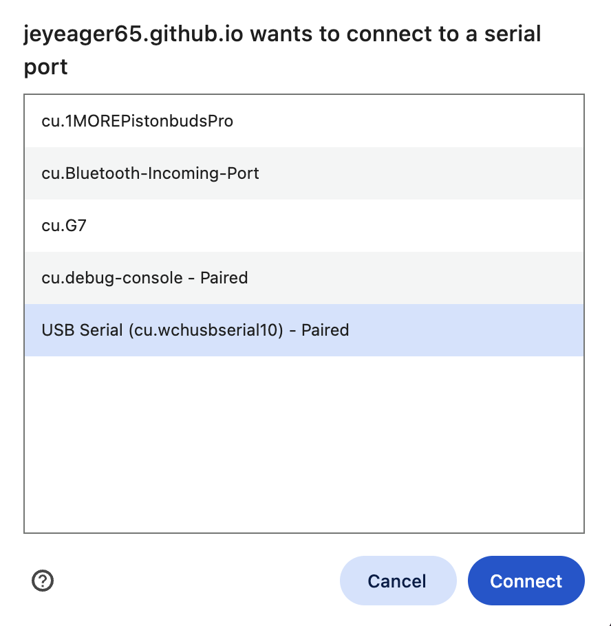

Just received my panel hardware v1.4. It boots normally into demo mode. Pressing boot button on power up, web installer pairs, but is failing to install - any ideas?
Message: Failed to initialize. Try resetting your device or holding the BOOT button while clicking INSTALL.
I’ve never had to press any buttons to install. My v1.4 display should be here in a few days.
Does it show any logging data?
Mine kept saying that until I figured out I needed to install the CH430 driver. After installing the driver it worked.
Never been able to have the webinstaller to work esptools always works. Never had to press any button
no logging data - beside bluetooth devices the only port i’m seeing is /dev/cu.debug-console (i’m on a mac) - which does pair using the web installer.
from esptool - running:
esptool --port /dev/cu.debug-console write-flash 0x10000 Downloads/fluidtouch-advance-v1.3-1.0.4.bin
results in:
A fatal error occurred: Failed to connect to Espressif device: No serial data received.
I’ve got a win10 device floating around - i’ll try from that and let you know
I’m pretty sure you need to do this then.
Got it - needed to enable Driver Extensions under Mac | Settings | Login Items:
Installed and working perfectly! For my needs a fixed mount is fine with local USB power. It’s so nice being able to just power up and immediately have access and control…. Bravo Jason!
