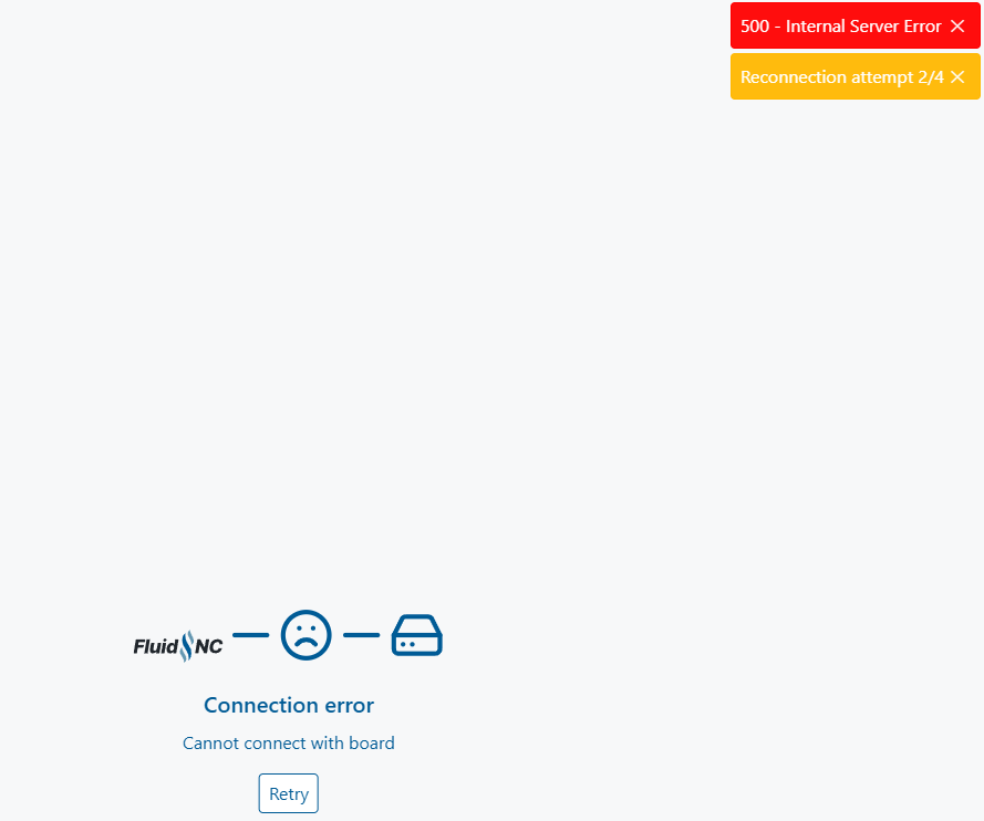

I’m having trouble getting the the FluidTouch to connect to my Jackpot V3 board.
The wifi is connecting fine (green wifi icon) but I get the “Machine Connection Failed, could not connect to machine MPCNC URL: fluidnc.local:82” screen.
I can browse to the fluidnc.local:82 URL from my PC (on same wifi network as the JackpotV3 FluidTouch), so it is up and accessible.
The Jackpot and crowpanel both responds a-ok when I ping them
Actually I may have been premature in saying I can browse to the Jackpot 3, I just went to the page again and it only stays open for a few seconds before I end up with this screen
I haven’t tried WebUI v2 on FluidNC v4.0.2 but it shouldn’t matter. Is this something that keeps happening?
What FluidNC version are you using? If a v3.9.2 version, port 82 is good. If v4.0.2 (which isn’t tested/recommended for V1 machines yet), it needs to be port 80.
I would turn off FluidTouch and restart the controller to see if you can connect. On FluidNC v3.9, when both the WebUI and FluidTouch are connecting to the websocket on port 82 (which is true for WebUI v3), they will only allow 1 to be connected at a time. If the WebUI works once FluidTouch is disconnected, they may be fighting each other. For me, there is a clean disconnect/reconnect on both FluidTouch and WebUI. But if you’re not actually getting connected on FluidTouch, that could be something else.

4.0.2 → I was eventually able to change the port back to 80 and save before the connection error screen from fluidnc.local:82. This has stopped those connection errors I was seeing in the browser.
Since changing back to port 80 (and editing the machine profile on the FluidTouch back to 80 too) it now connects fine, it even connects while I have the Webui open in a browser this time which it didn’t do the first time around, weird.
I’ll downgrade to 3.9.2 now
Edit: Seems i cannot downgrade. “Error! Unable to flash device. Try a lower installation speed (baud rate).”
I didn’t mean to say 3.9.2. If downgrading, go to 3.9.9.

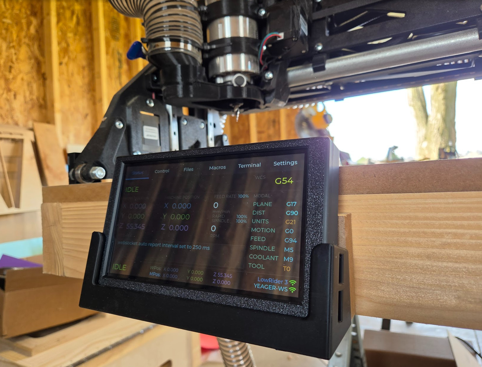

Here’s the FreeCAD and .3mf file. I do plan on uploading this and the case to Printables/MakerWorld and putting on the FluidTouch Github but there are a couple things pending at the moment. One is to see what I need to change once the v1.4 advance display I ordered comes. There’s also a wired option I’m working on that may result in a slightly thicker case.
FluidTouchStand.zip (1.2 MB)
And here it is mounted to the front of my table:
