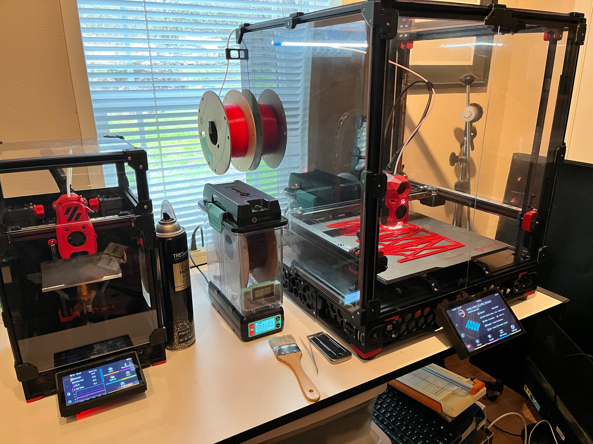

Totally sold! Display has been ordered. This is exactly what I was hoping for, a great interface that compliments my Voron Klipperscreen panels

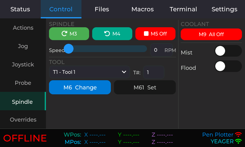

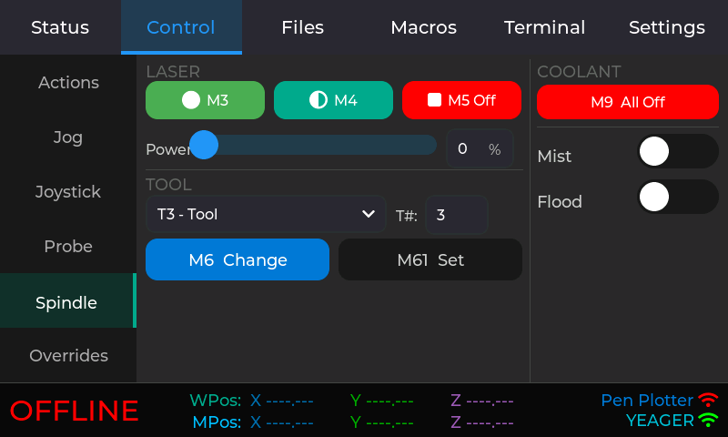

I haven’t figured out quite what to do with the spindle/laser page. Here’s an unpolished look at me trying some things. This doesn’t all make sense yet.

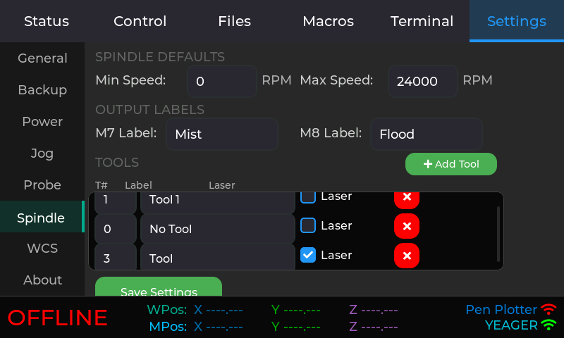

Settings - To FluidNC, a laser is another spindle. Allow for labeling M7/M8 purposes.
Control - Select a tool from a list. Set labels based on whether or not it’s a spindle or a laser. M6 changes to that tool (assuming you are using M6 tool changes - which you are probably not - but my pen plotter does). M61 just says that is the tool that is already there without doing a tool change.
Selecting a tool doesn’t necessarily make sense either. You would do this through gcode so I’m not sure this serves a useful purpose. Also, when you define spindles/lasers in config.yaml, it’s really specifying a tool number range for each spindle/laser. I’m not sure where I’m going with all this yet, or if it’s even useful.

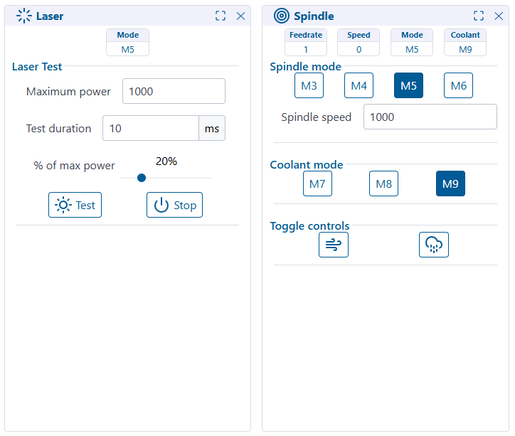

In the same way, I’m not sure how useful the corresponding panels are in the WebUI.
If anyone has any thoughts, I’m all ears.

I put spindle/laser functionality on hold since I wasn’t sure it was overly useful. It seems to be highly dependent on your specific setup and macros should cover it.

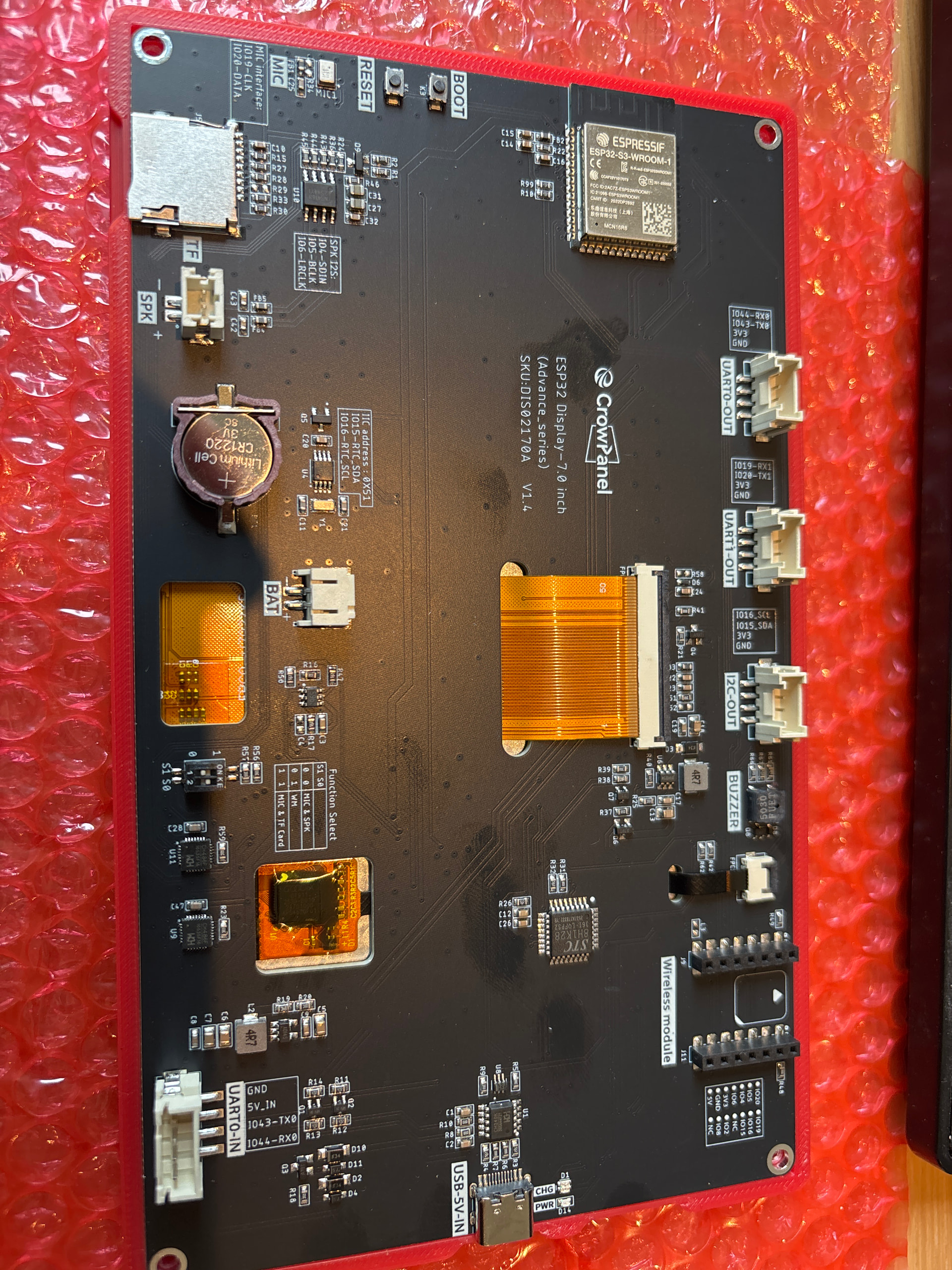

It looks like Elecrow updated the Advance display to v1.4. There aren’t any details available yet but at least it appears to work with the Advance v1.3 firmware (thank goodness).

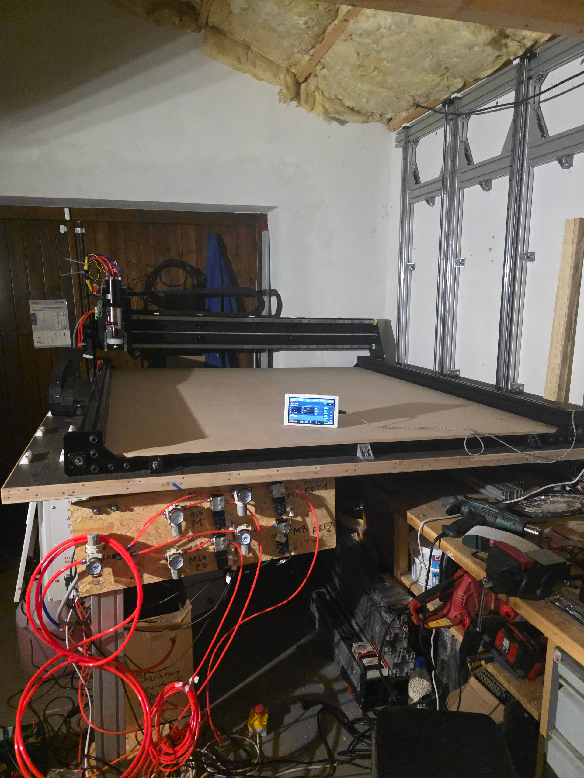

Ist that a Jianken ATC spindle?

I have the 1.4 version. First difference I notice is that the reset and boot buttons are smaller.

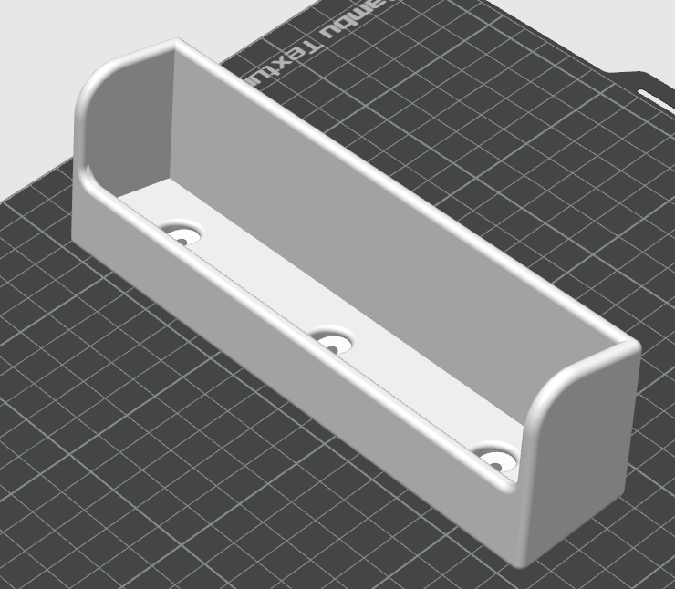

I’m thinking about adjusting the case with 2 channels to hold the pins.

Hmm. Well I was working on a modified button to handle the post I broke off before soldering a new one on. I imagine I could probably make a modified one for these new buttons.

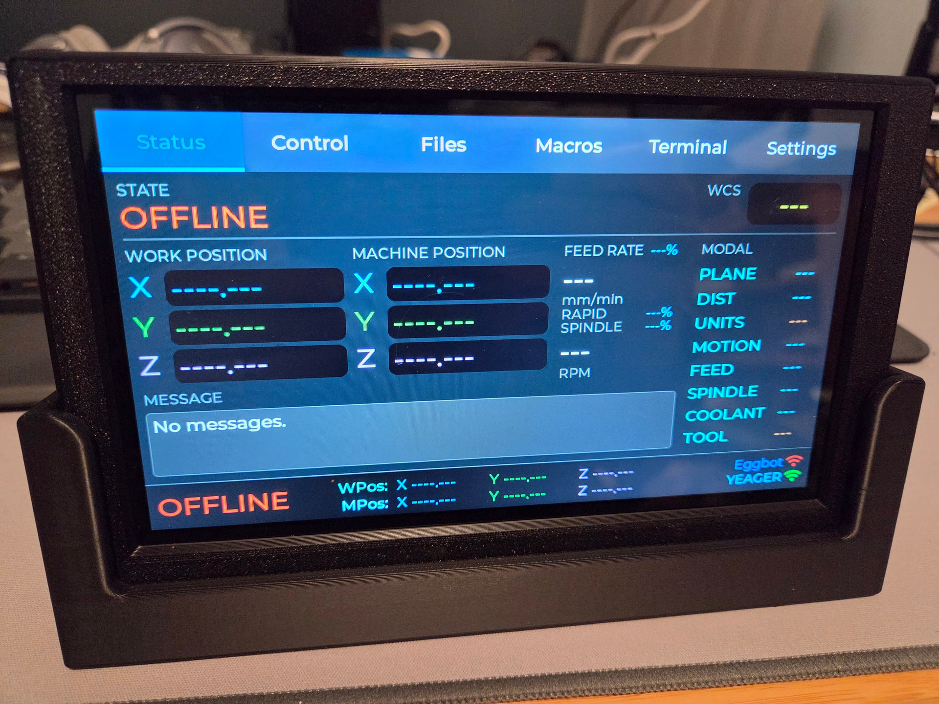

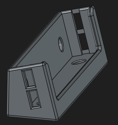

Going to try out this stand tomorrow. This attaches to the top of the table and angles it back a bit. Not sure if this is what I want, or if I want something attached to the front, still angled back, and probably make the top of the case at or below the top of the table. I’ll probably make a design like that as well.
Made a few changes. Have holes on the back or bottom depending where you want to mount it. If you mount it on the face of the table, you probably need to use a block so it’s out far enough. I added front side holders to make it more difficult to knock off the stand. I lowered the front lip and added side holes so it still works if you have it rotated 180 degrees and so you can still access the power switch. It really only needs a single side hole if rotated, otherwise not at all. There’s a channel so you don’t flip the switch when putting it on the stand. Printing now.
I couldn’t get a button to work on my broken boot button but only because the button didn’t work pushing on it. I soldered a new one on. I ripped the pads off the one side so I don’t think it will work but I also haven’t needed to use that button when flashing firmware.
I ordered a new advance display to see what I need to change for the case to work with v1.4. I also ordered a 9 inch ESP32-P4 version to play with - that won’t be supported by FluidTouch anytime soon. Someday, I might rewrite it in ESP-IDF at which point I might. I’ve also toyed with the idea of making a web version but again, not happening anytime soon. I was playing around trying to get something that scaled well depending on window size.
Edit: Yea, I like that better.
That would be great. It would also work for those of us who broke off the post(s) on the switches. Those posts are crazy fragile, and it would be much easier to replace them with more ‘standard’ switches like is shown on the 1.4.

yes it is
