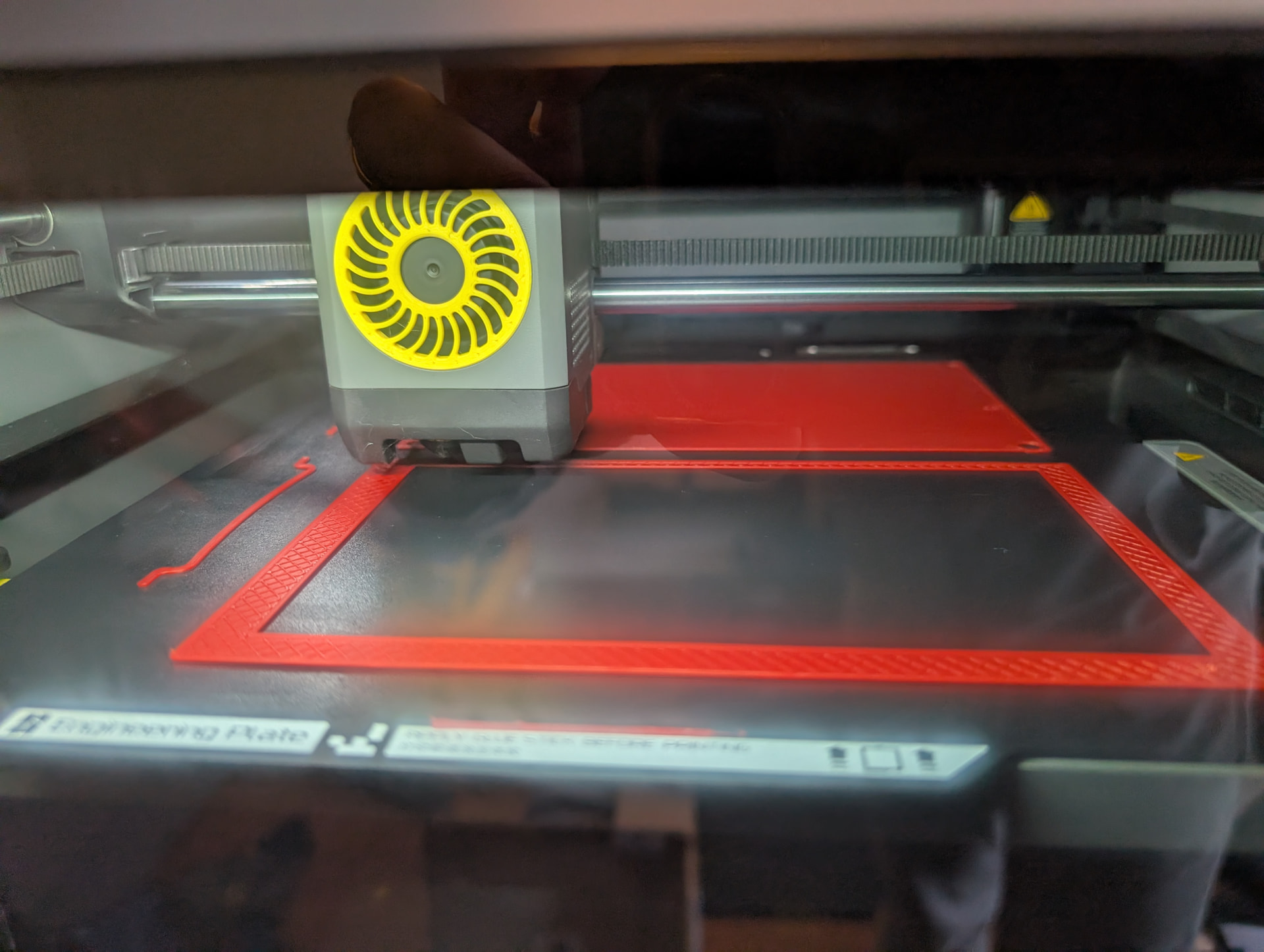

I took a bit of a break on it but picked it back up a couple days ago. Last print needed some tweaks (fit of the switch, depth of the display into the top, and battery bracket updates). I have a top printing now. I hope to finish it this weekend.

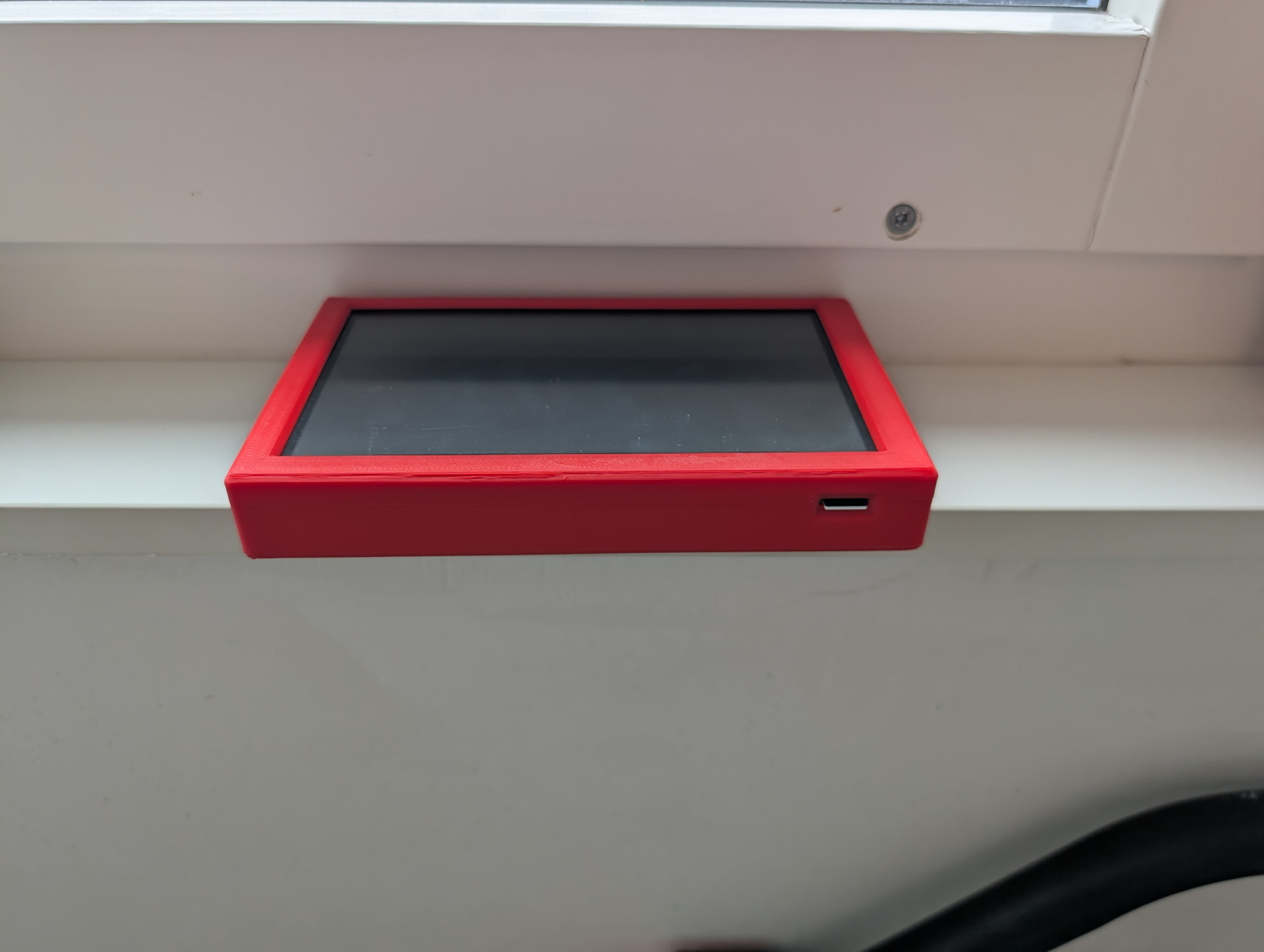

Here’s the current version of the case. Everything is fitting well for me. This only works with the Advance version of the display.
Here are .3mf files and the FreeCAD project (done in v1.1.0 RC2):
ElecrowAdvance7Case.zip (3.9 MB)
Here’s some rough documentation for now:
General Notes:
- Nothing needs supports. The bottom has a single layer where the countersink is so you can just poke through that.
- I printed everything on a Bambu P1S with PLA with a 0.4mm nozzle, 0.20mm layers, with 3 walls and 30% infill.
There are 4 parts to print:
- Bottom - Print flat side down
- Top - Print top side down
- Button - Print x2 with the top of the button down - Needs a brim - May need to clean up with a razor
- Battery Bracket - Print x2 sideways - Tested with 8000 mah 126090 and 10000 mah batteries.

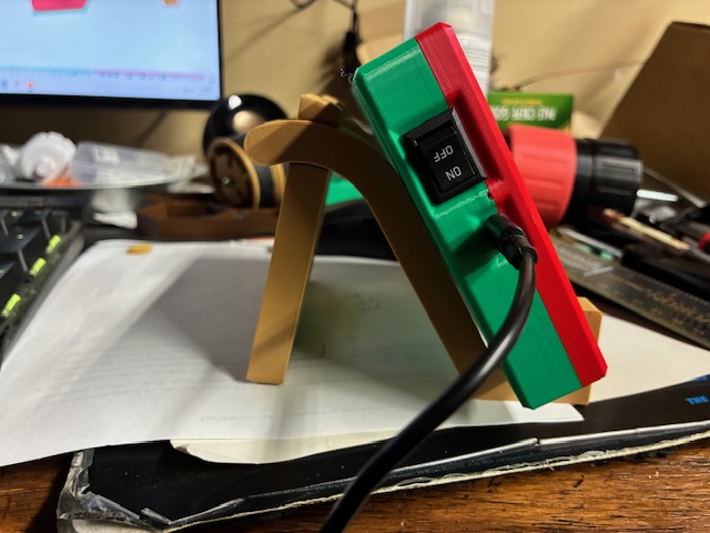

Switch Wiring (you need the switch but the rest can be done multiple ways - I’m still sorting out the easiest way to do this)
*** MAKE SURE THE POLARITY IS CORRECT - ALL BATTERIES AND WIRE COLORS ARE BACKWARD TO DISPLAY BATTERY PLUG ***
- 1 - 15x10mm rocker switch
- heat shrink tubing
- 2 - 0.187" spade terminals – these crimp to the wire and plug into the switch terminals — or just solder wires to the switch
- JST PH2.0 male and female connectors – or you could cut the wires on the battery and use that connector and splice wires – or if you hate yourself you can crimp the JST PH2.0 connectors yourself)
- 22 awg wire

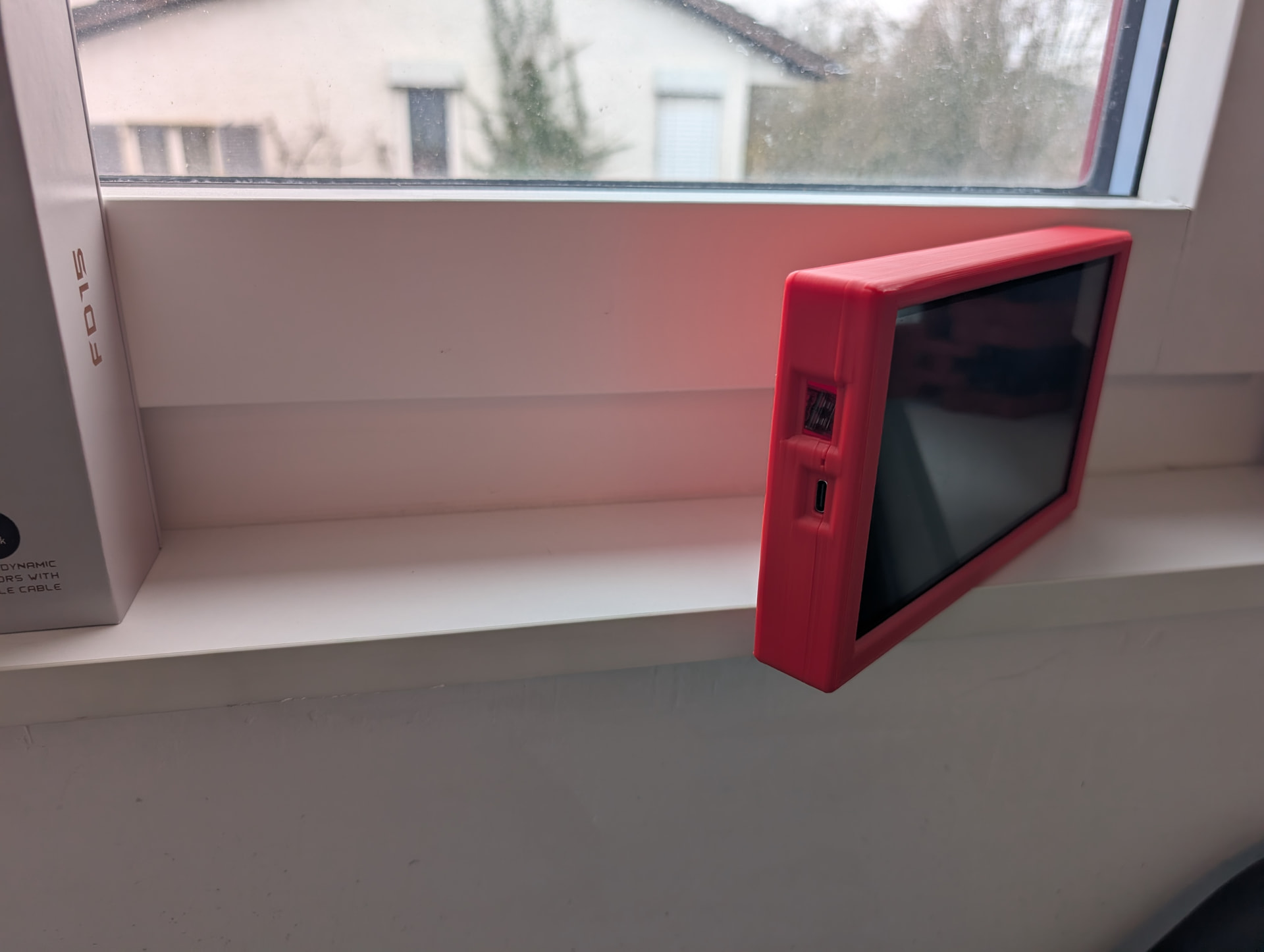

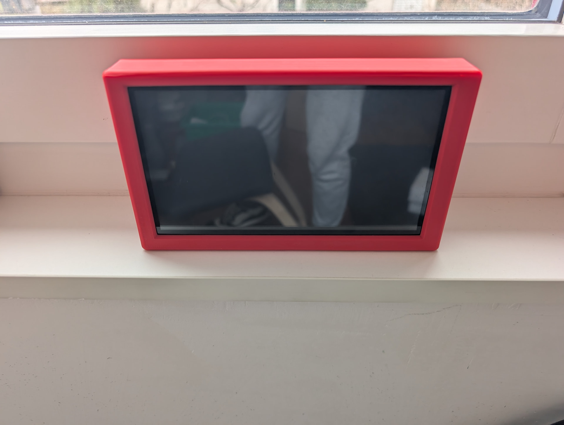

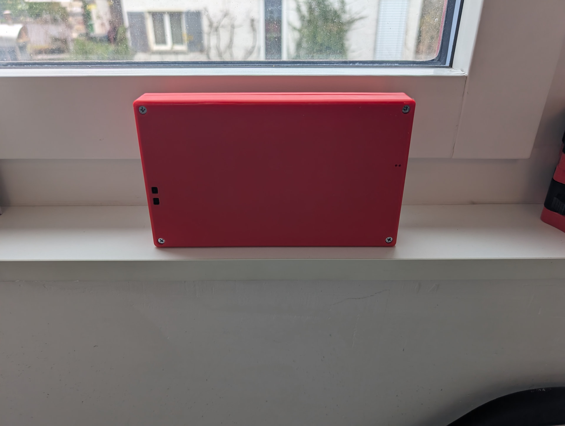

Initial feedback: the buttons were pressed by the case. I had to sand a little be the buttons and the holes and while doing it I broke the small piece of plastic of the reset button. Nothing dramatic.
Depending on the printer and the filament used the result might be different.
You could put your step and cad files in a hardware folder in your GitHub.
Oh no. I broke one too but it’s because the button is supposed to just sit on that plastic piece but I had it too tight and forced it before adjusting the part with a bigger hole.
Yea, that’s my intention when I add more detailed instructions.
Really not a problem
I already ordered new (shorter ones). Just need to play with my soldering iron when I get them.
But now everything sits perfectly.

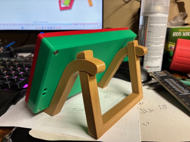

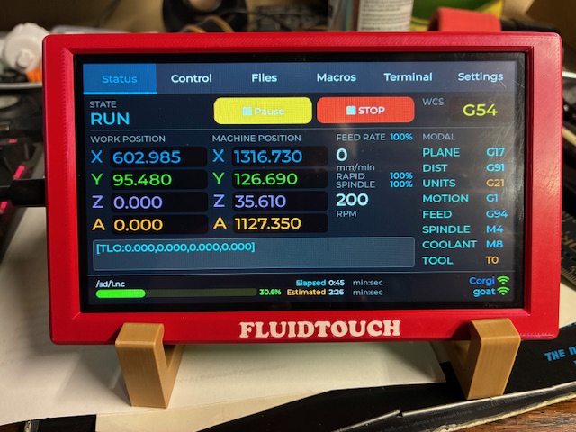

Just finished case and designed a stand.
Here the stl for the stand
FLUIDTOUCH STAND.zip (97.4 KB)
thanks Jason love the FluidTouch
Looks great!
