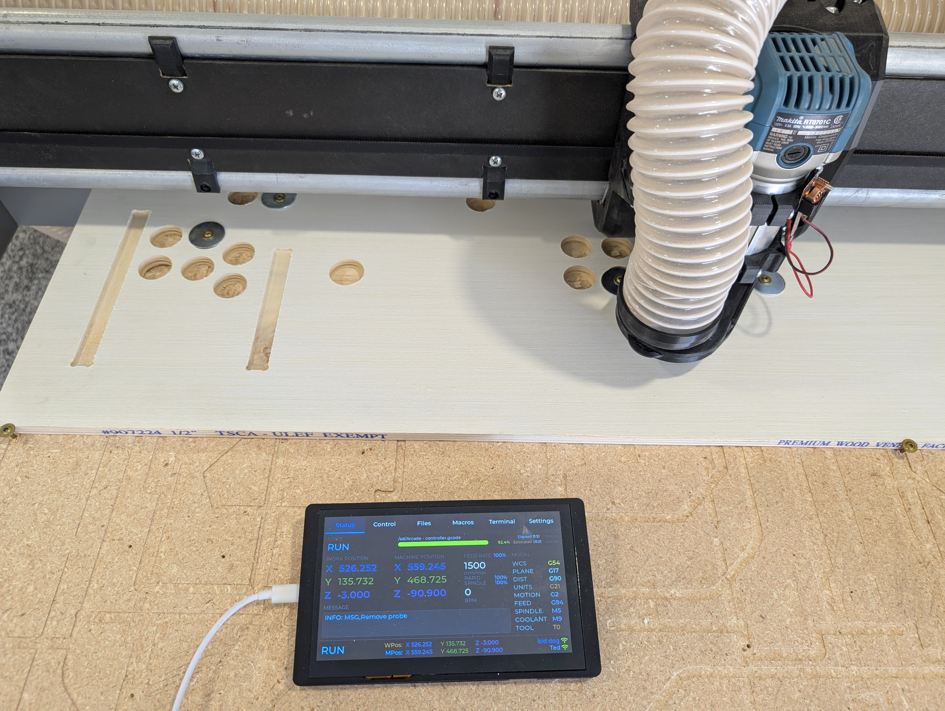

(and, by the way, have I told you recently how much I really enjoy this application? Even though I don’t push any limits on the Primo, the ability to launch a project and then go work on something else in the shop, taking the FluidTouch with me to the laser or workbench or LR4 or whatever is just the “bees knees” if you are old enough to know about that… :smile:

I have to say, thank you again. Fluid touch is pretty nice, every time I use it I like it a little more. I was waiting since RMRRF, for my new screen to show up so I could give it a try. I couldn’t wait any longer so I started cutting this job and no joke the delivery guy showed up with the screen. Well it was cool to give this one a last run.

Interesting combination of material and cuts… :eyes:
Finish up the arcade… :crossed_fingers:
Although now I am thinking about lasering in some labels. There are button combos to exit and menus and stuff. The laser would look good but I might just hide a button for that stuff. Basically I need to make up my mind before I do anything that is not easy to change.
Eh, can always do it again. I heard you are in possession of a machine that can repeat the same task over and over again. :face_savoring_food:

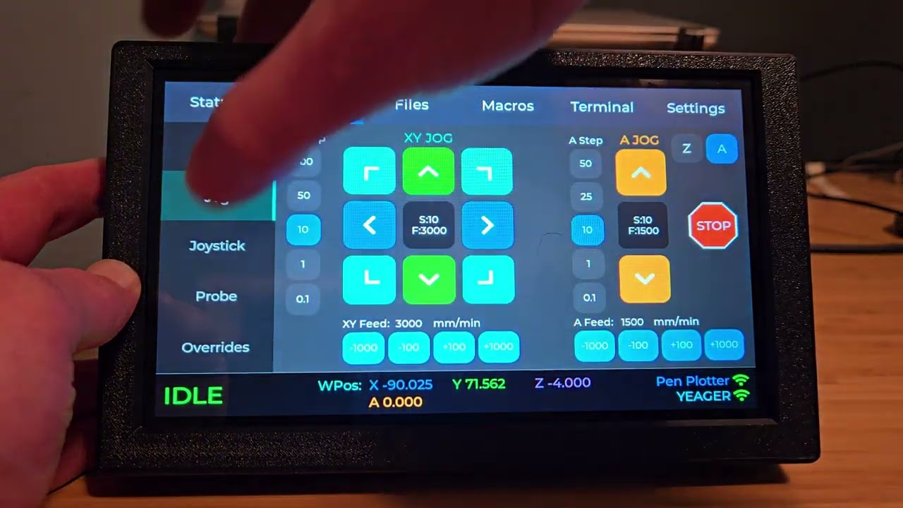

Great job, what about users with more axes (4 and 5)?
I added support for an A axis in v1.0.4. I don’t currently have plans of adding a 5th axis since that’s pretty rare (and I’m not sure where I would put it).
You are amazing, after my comment you made a video in a few minutes that you were working on an additional rotary axis.:wink: But seriously, I’m glad you’re working on this. Thank you!
