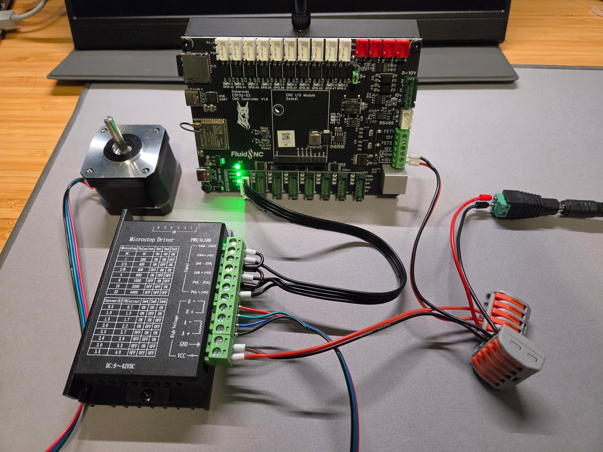

Got the Doberman setup for working on USB CDC support. Wow, wiring up external stepper motors is a pain and I only have one. I have a new appreciation of the onboard TMC drivers on the Jackpot.

So all of that is only for 1 stepper motor? You would need 4 more of those for an LR4??
WOW
Yep. I’m using a cheap driver so I could run it at 12v, same as the board. But chances are on real machine, you’d run the steppers at a higher voltage so you’d need a second power supply. Then there are dip switches to set amps and microstepping, instead of it being set in the config. Blah.
You need to set the switches and the config. Double the fun. :stuck_out_tongue:
My first one used 24V, the one now uses 36V for the drivers (though I could fo 48V) and 24V for the board, so yeah, I need two power supplies now. -_-

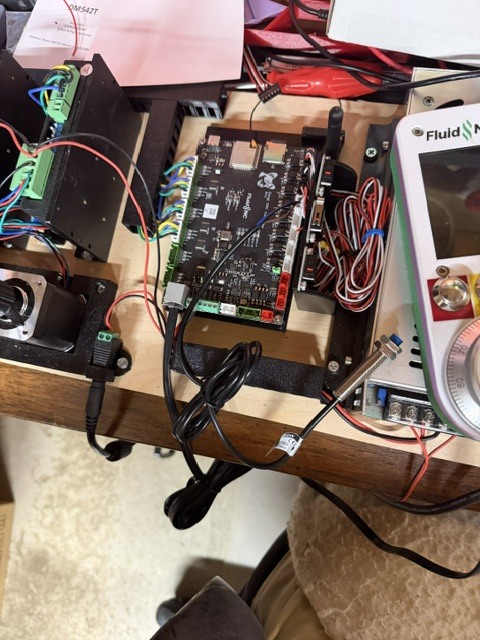

here my test stand Corgi on 12v and 48v to steppers 3 reg end stops one npn prox.

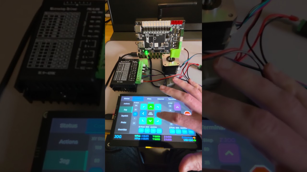

I’ve got some things to sort out but I’ve got it working. I needed to make some FluidNC changes because it was falling back to CDC ACM instead of using the CH340 VCP. (I didn’t know what that meant either before today.)
