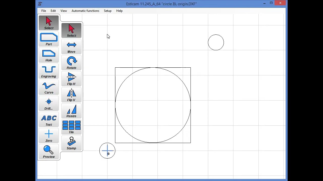

With v11 Insert the actual drawing origin (circle center in examples 2 and 3) of the Opened file doesn’t matter, but the Inserted file has to have an embedded (set in CAD) origin (center of the smaller circle) that will register with the default Estlcam bottom-left origin of the Opened file. It’s interesting that Insert is not limited to the Opened X+/Y+ quadrant (3/4 of that small Inserted circle is outside it).
V12 Add is not working. All Added files are aligned on the Opened Y axis, but shifted to the right of the Opened drawing instead of also lining up on the Opened X axis. Consistency here would require the Add file origin be at the bounding box bottom-left (no going outside the Opened X+/Y+ quadrant like v11 allows). The second v12 test is odd in that the origin shifts upwards, close to the embedded origin of the Opened file (center of the small circle next to the origin) - unlike v11, that top-right origin is affecting the outcome.

Update is for reloading the source file to update the project drawing with changes made to the source drawing. With v11 it works fine so long as the source drawing stays within its original X+,Y+ quadrant. Correction: With v12 the the drawing changes can be anywhere and the project origin won’t move (unless its a PLT file).
Insert/Add is for adding additional source files to the current project (e.g. for Adding a custom SVG engraving to an Opened/reusable project file). Known to work file types in v11 are DXF, e10 and SVG. My test only shows that the v12 Add function is broken, it is not a good usage example in that using the Update function for adding that circle would have been more appropriate.

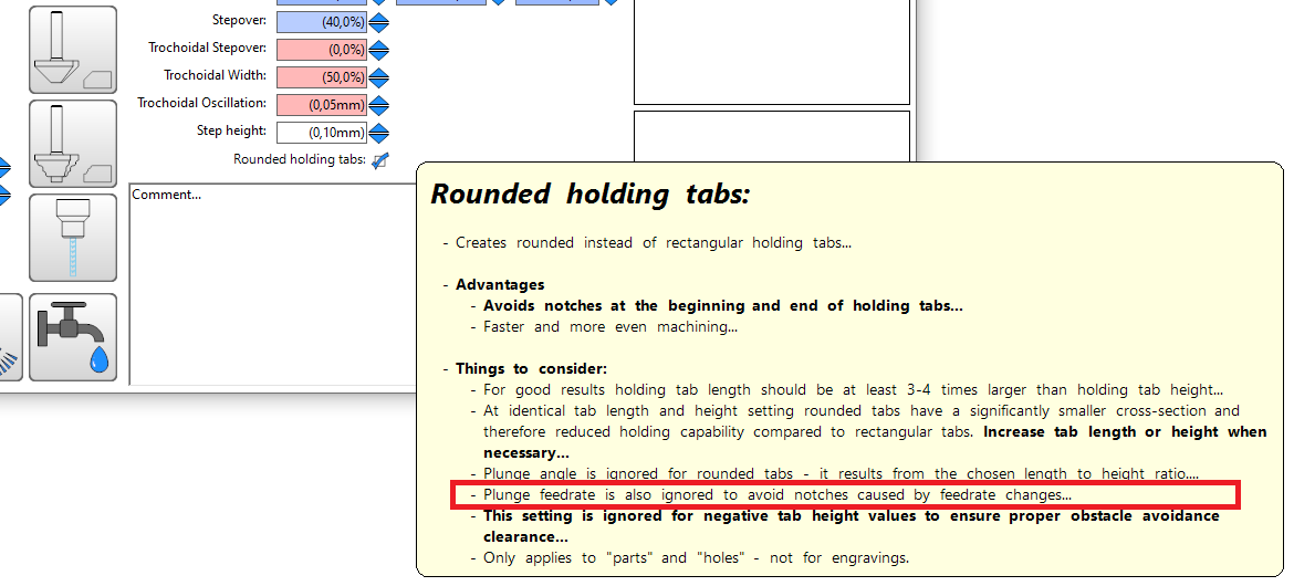

First one is - The new rounded tabs feature is great, it does seem to break the plunge speed though. Using rounded tabs my machine dives in the material at full speed initially and when cutting the tabs. It seems like is should still obey the plunge rate set, I understand it skipping plunge angle? I would prefer to have control over how fast the endmill plunges, bare minimum at the initial plunge but ideally at the rounded tab as well.
Hello,
rounded tabs are intended to avoid ugly notches at the beginning and end of tabs by maintaining a uniform cutting speed.
Plunge feedrate is intentionally ingored as those changes also create notches (not as bad as plunging at a 90° angle, but still usually very visible):
Christian
It even ignores it at the initial plunge nowhere near a tab, If that is your intent that is okay I will just use regular tabs. In metal the plunge is much slower than the cutting rate.

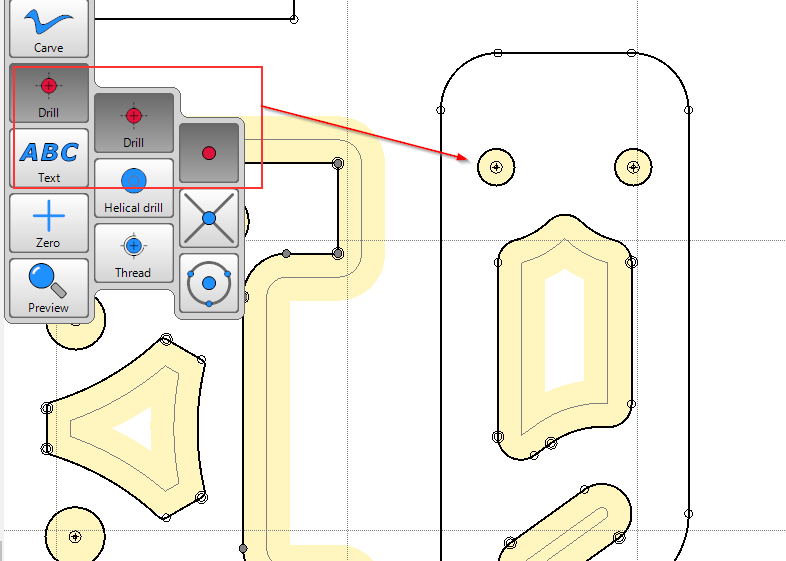

Also when I have a bit set up for Trochoidal Milling and also have the Drill section set up it ignores the tool path depth for drill and just does a straight plunge with no pecks. Is there something I need to do differently for this to work?
