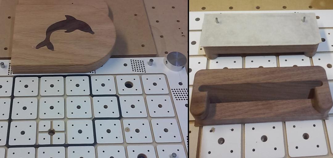

Example of using Insert for relatively simple tiled layouts. Both projects have unidirectional climb (t/r + b/l corners) and conventional (t/l and b/r corners) cuts which, last I checked, is also not possible w/ v12. Neither project can be done as a single project file because Estlcam doesn’t honor group level machining order. This is an issue in both v11 and 12, but it’s worse in v12 (multi tool pockets forced to the beginning of the program/G-code).
