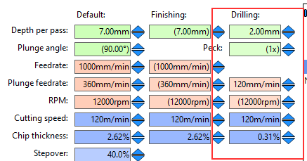

did you have to do anything special for Peck settings for drilling?
I have mine defined as
Then I use just a regular drill function
When I run the preview, it just goes straight down…
I guess I need to check the Gcode…maybe it’s a preview problem??

(No. 1 Drill machining: Drill 1)
G00 X216.2598 Y57.2452 Z5.0000
G00 Z0.5000
G01 Z-5.3000 F120 S12000
G00 Z5.0000
That’s the whole drill segment…just straight down to 5.3mm in one go
