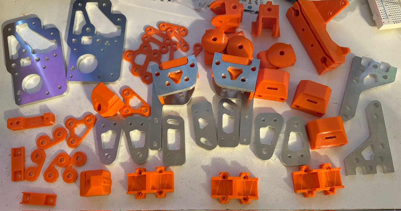

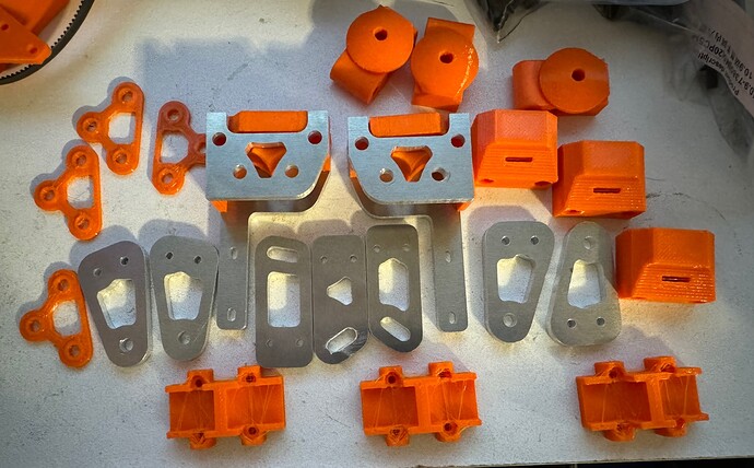

Dang, looookkkksssss GREATTTTTT!!
Jonathjon
(Jonathan Jones)
March 14, 2024, 10:11pm
50
Man those parts look SO much better than mine.
azab2c
(Kyle Reese)
March 14, 2024, 10:57pm
51
Nice looking parts! Nice seeing printer parts CNC’d from your 3D printed CNC. very cool.
Curious is your Alu measuring ~4.76mm thickness, or something else?
I only have single digit calipers, but they are reading 4.8
And they just added an 8% coupon for the sheet I bought…
