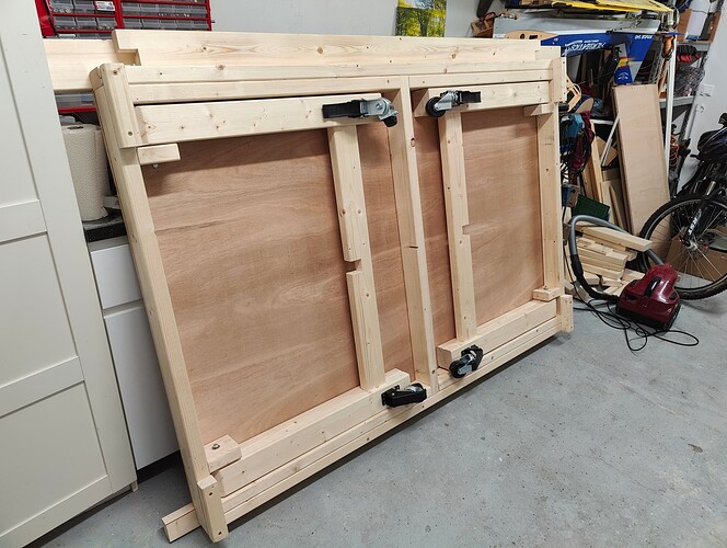

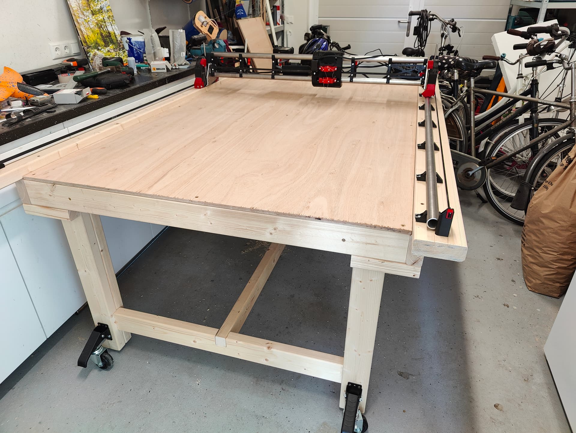

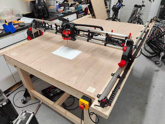

Also, the table is as good as finished. Really glad that is is foldable and has wheels. I did not realize how big this machine was going to be. :grin:
I (and my girlfriend :wink: ) cannot wait until it is also wall-mountable.

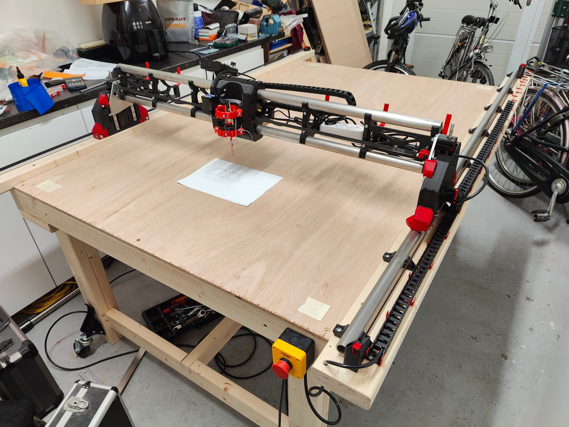

Is there a best practice to get the cable from the core to lay down neatly into the gantry cable/hose channel? In my case, the cable keeps snagging behind other components. It does not stick up, but lays a bit flat. I’m willing to test some, but I’m sure that I’m not the first and that others have a more creative mind than I have.
At the moment I’m not going to install a dust suction hose, so I cannot connect the cable to that hose. This is a concious choise; I will be holding the hose manually to make sure that I stay with the machine and don’t wander off during operation. I saw some sub-optimal results on this forum when the machine gets stuck. Would really like to prevent that.

Attach it t the vac hose, that makes it simple. If you are not using a hose try the tape measure trick.
Well, that settles that just try the tape measure trick.

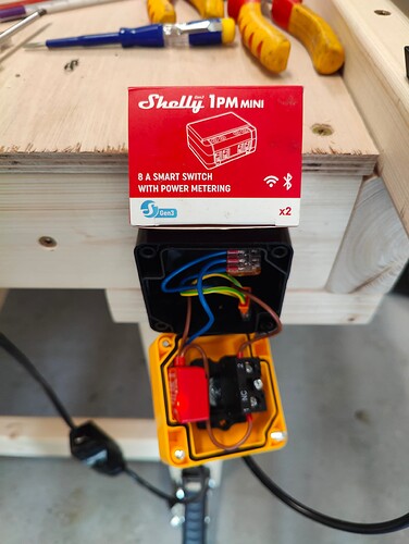

I have seen some pictures here where a fire was started because of some issues with CNC machines. This is something I really want to avoid.
I would like to get the opinion of all you experienced users;
My thought; if there is an issue with the CNC machine and the router gets stuck, it will take up (much) more power (Watt) then during normal operation.
I have some Shelly power monitors laying in my drawer (Type 1PM mini gen3). I now put one within my E-stop button (between power supply and E-stop). There I’m thinking of disconnecting power when the watt’s go above a preset value. I can set this up in the Shelly app (or within my home assistant, it connects automatically).
Is this idea making sense or stupid?
Thanks for the advice in advance!
I don’t think that’s necessarily true. Just a bit spinning in wood with a router that’s barely moving if at all could start a fire.
You could also trigger false positives if you hit a knot or something.
This also doesn’t eliminate the need to watch it.
That makes sense.
It was not to make me able to walk away, just an extra safety. Think I still keep it in there to have some logging in Home assistant (not sure yet for what purpose).

I tried the tape measure trick to guide my cables, but the cable sleeve has no room to put a tape measure in there together with the cables. Tried to tape the cable on top of the tape measure, but that does not work well.
Therefore , I would like to use a cable chain.
I have seen a few posts mentioning that with the MPCNC and the Lowrider V3. Does anyone have a design for the Lowrider V4?
Use your vac hose as the cable chain. They both travel the same direction and it works really well
I printed a cable chain, but only for the y axis, for x I use the vacuum hose!
https://makerworld.com/models/197887
It is a bit oversized but it works. Also made a mount for it, if you need it I can share it.

This table looks awesome. Is the table stable and does not wobble in any direction (especially the long axis) ?
I like the gen 3 stuff. Makes me wish I had waited to install shelly in all my light switches.
The stepper motors actually don’t use extra current when they stick. The router might, but it would also use more when working hard. If you have a router without a speed control, I’m not sure if it would use more or just send the same amount of power all the time.
Interesting idea. I am very wary of safety features that are not bulletproof. I would want to make sure I don’t trust something that isn’t as reliable as me. Otherwise, it makes it less safe.
Just tested it: on the short axis it is very sturdy. On the long axis it wobbles a bit. I don’t yet know if this is an issue during carving (speed and weight of the Lowrider will be relevant for that). The design that i used as inspiration uses a diagonal beam. If the wobbling is a real issue, i also will put a diagonal beam between the legs.
It’s addictive; everything that can become smart…
I hear you; it’s better to know that there is only manual safety, then thinking that there is an automatic safety that in practice does not work.

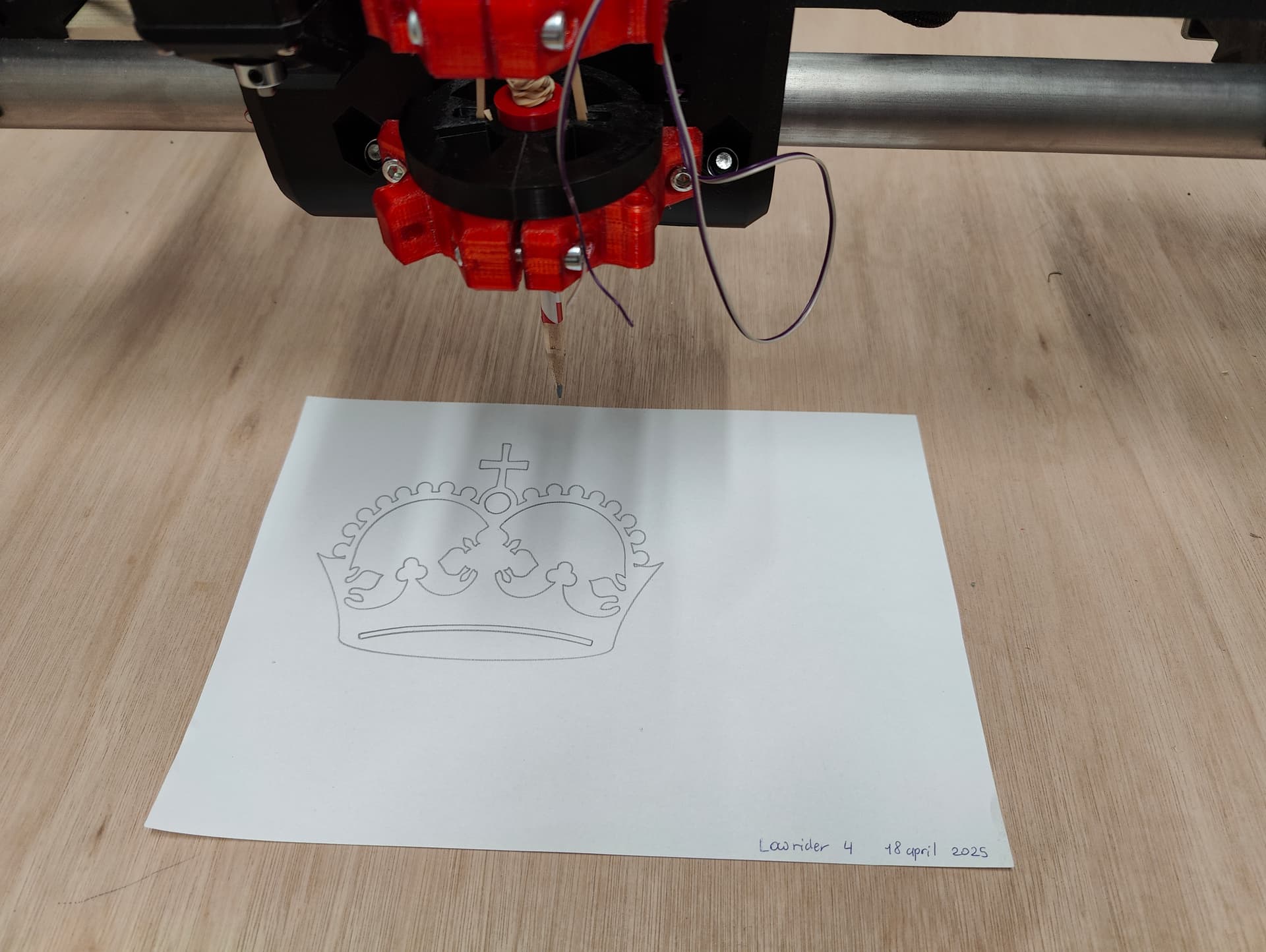

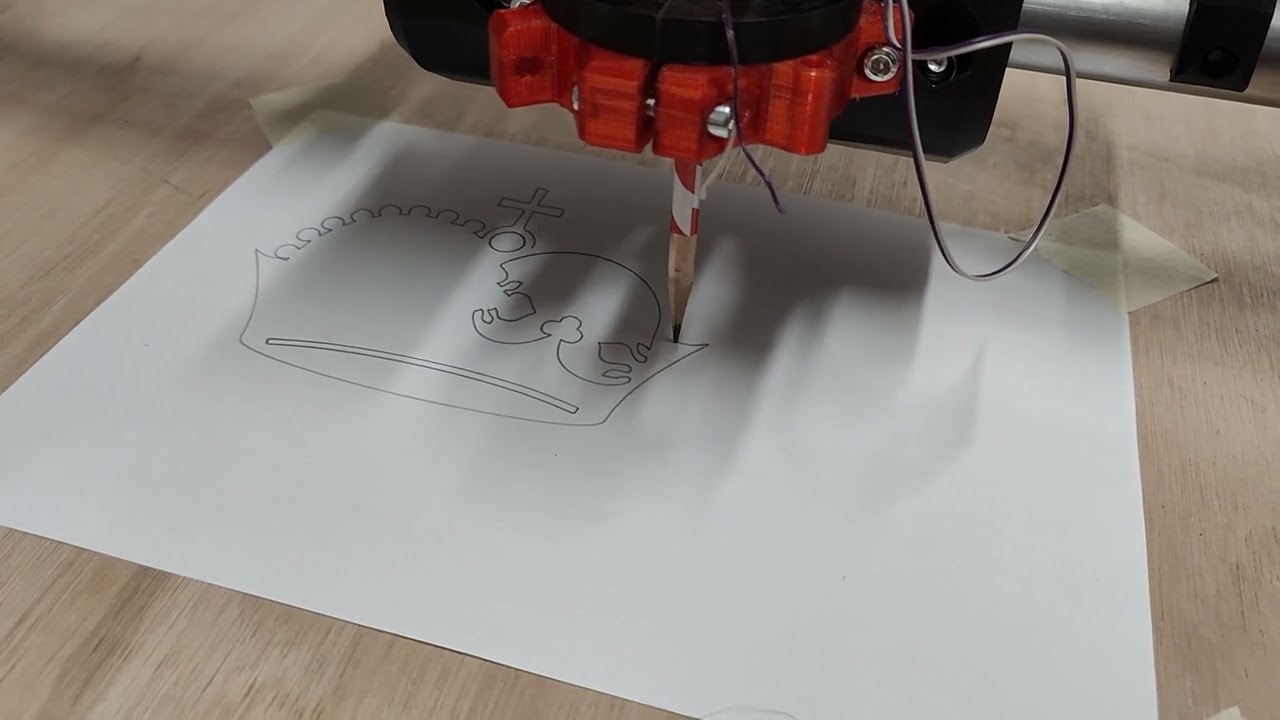

The first crown is a fact :grin: :exploding_head:
This one is going to have a place of honor in my workshop.
The sound is a bit of nails on a blackboard, but once the router is spinning, that will be unnoticed. The Z-screws also will get some more lubricant.
