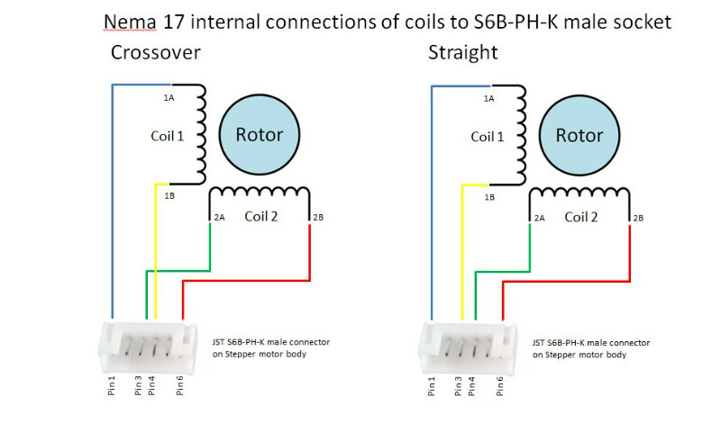

Wires - colours don’t really matter.
Plug your stepper directly into the board - If you plug the stepper in the wrong way round it will go the wrong direction. No problem, switch off, flip the plug and it’ll go the other way.
Extensions just need to be straight through.
Occasionally the motors can come with crossover wires - you can tell because the motor will just shudder not move. If that’s the case you carefully release the terminals from the plug using a pin and swap them.
Here’s a diagram of that
With the motor unpowered and unconnected to anything else if you short 2 pins together and get resistance when you turn the shaft - those 2 are on the same coil.
I can’t remember for sure but I would make the same assumption as you about the Y motor order. When I built mine I connected all the steppers to the board directly on the bench to ‘prove’ them, worth doing before starting to assemble imo.

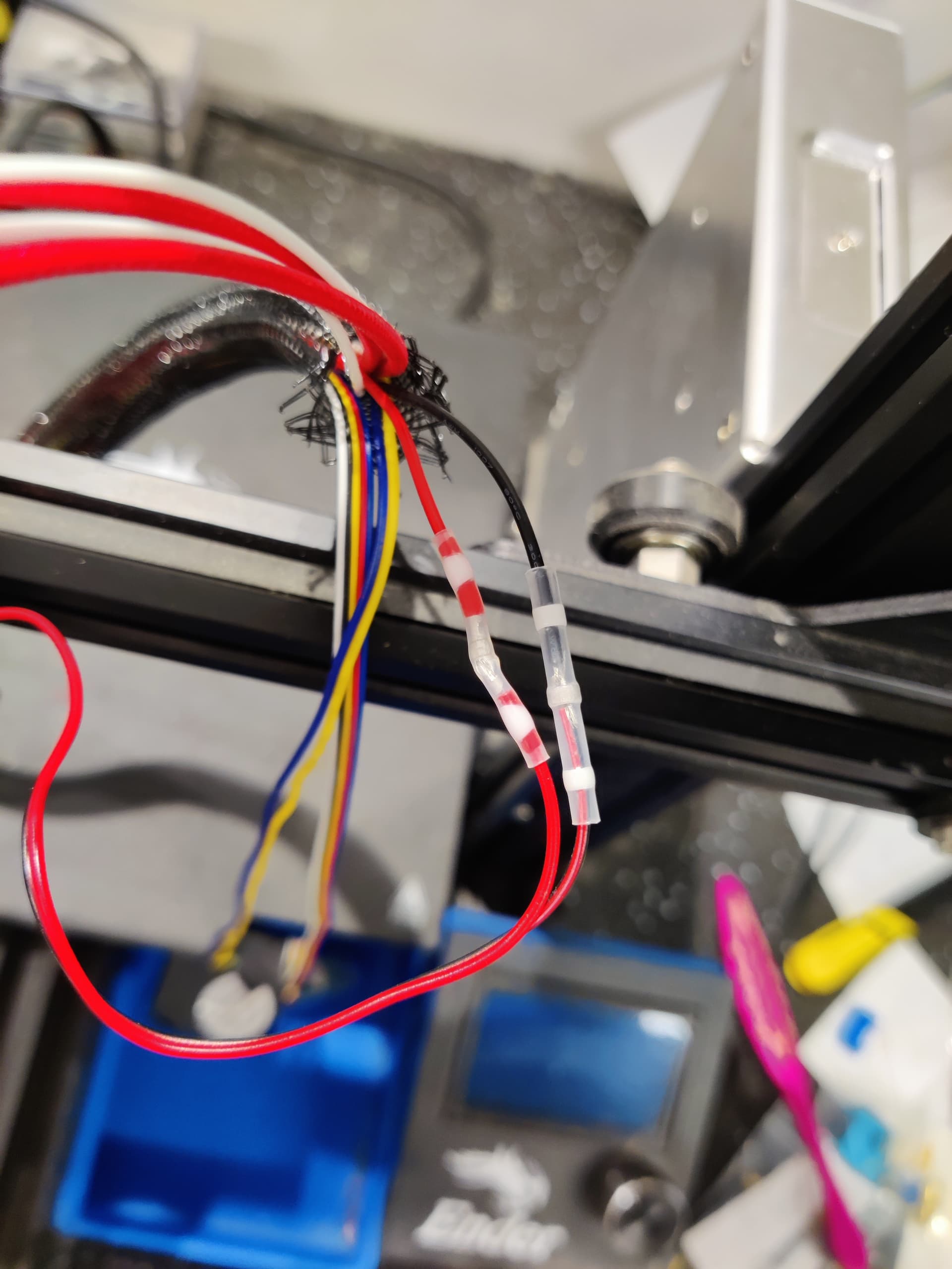

I also used DIY connectors so I can make all wires at the correct length with proper connectors. Already had them lying around, so they are not listed. If you need links to them, let me know. Then I will find them.

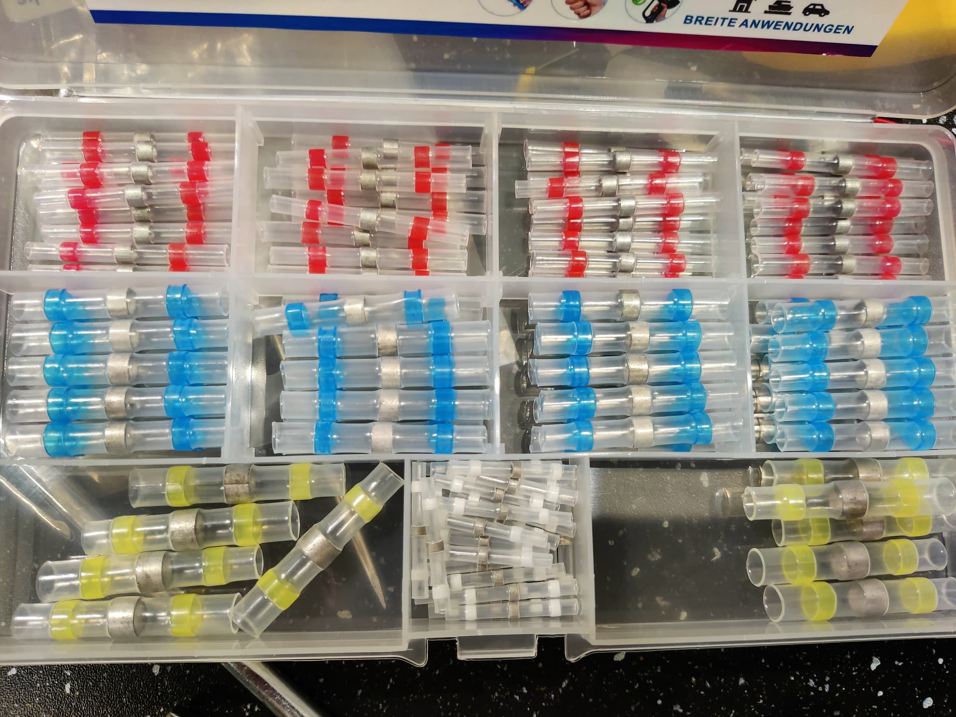

Also some realy handy solder - shrink tubes (Amazon link).
With these connectors, you twist the wires together, slide the shrink rube over the bare wire and apply some heat with a heatgun. This both melts the solder (thus connects the wires) and shrinks the tube. I really like these and use them a lot. They claim it to be water tight. I trust this a bit more than taping connectors together. Had some experience that connectors can vibrate loose over time with other projects (pictures are from the 3D printer). I also expect some vibrations in the lowrider.

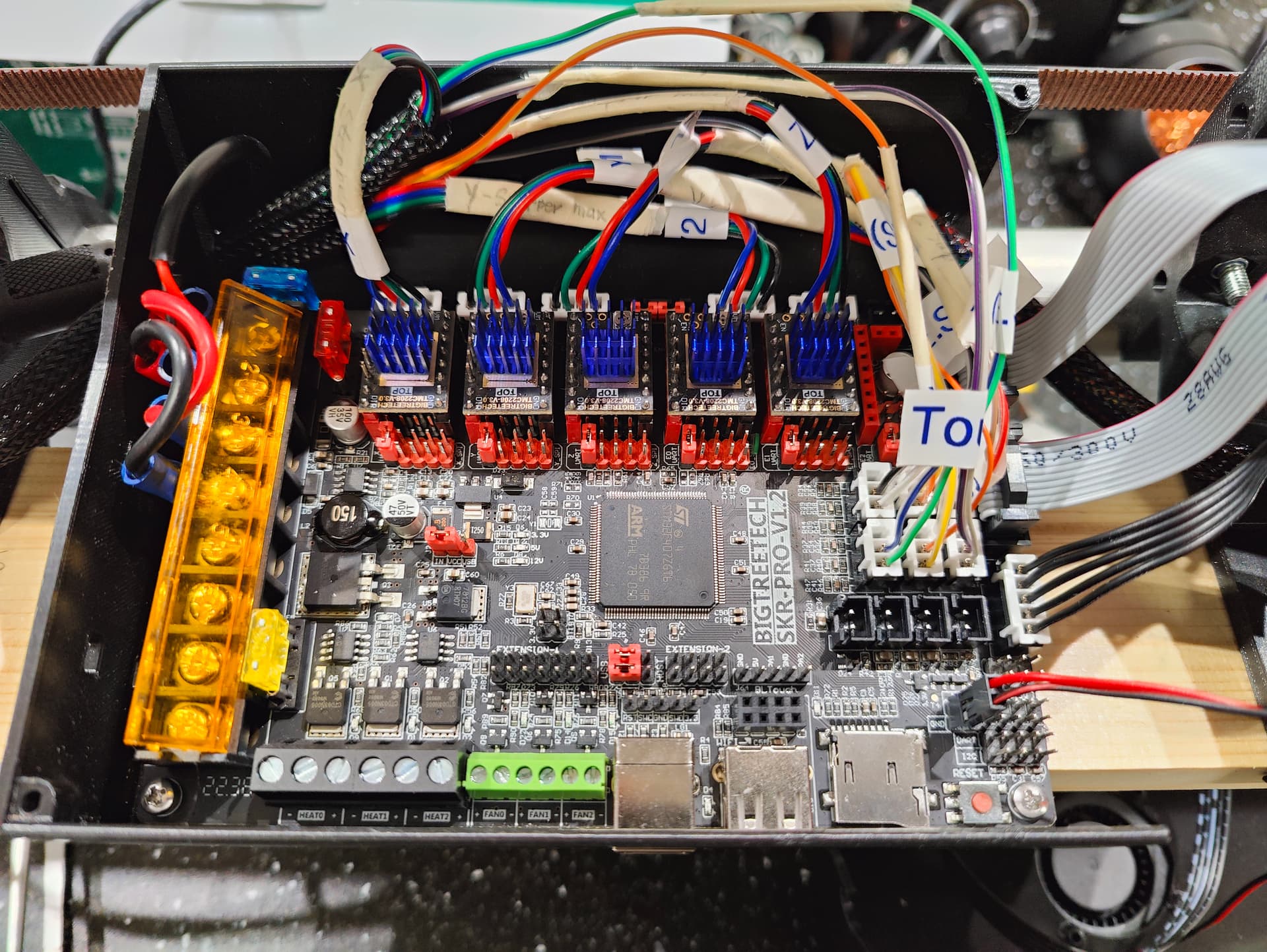

Just a last update. I finished the wiring to the control board and got the first movement :smiley:
I have done all connectors with JST-XH connectors. Was a bit of a hassle to correct the inverted steppers, but I’m glad to have put the time in that. The advantage of this type of connectors is that it’s impossible to put them in backwards accidentally.

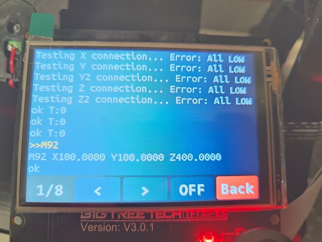

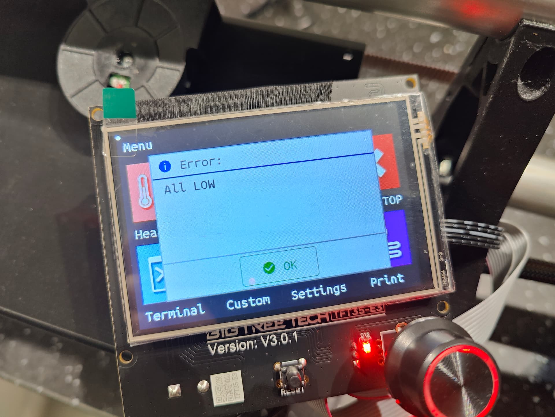

One question; I get an error message on the display;
This is combined with a series of beeps.
When I push “OK” I can move on the axis. When i search online, I find that this is a known issue (apparently something with the TMC 2209 drivers), but should be fixed by Marlin version 2.1.
Any thoughts?
I had the same on my primo, I never took the time to dive into it and yesterday my primo was gutted by my son to use the skr 1.2 on the ender 5 he killed one driver from… The primo’s parts are going to be used for the LR4, so almost nothing is lost.

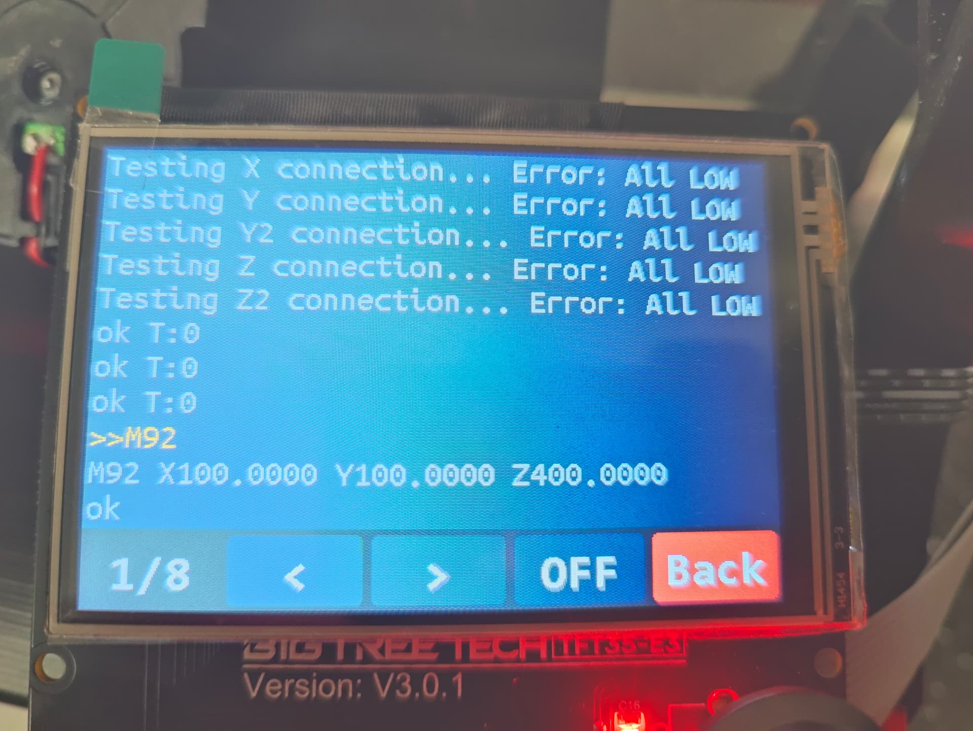

All Low means it is not talking to the TMC2209s. It isn’t a “known issue” as much as a “useful error message”.
It is usually a problem with the power. Sometimes people buy the wrong drivers (that aren’t configured for UART). Sometimes the jumpers are wrong.
It would help to know if it was all the drivers or just one. M122 would tell you, but it isn’t easy to read on the tiny screen.
Yep, that was it. I now see that I ordered the wrong ones at aliexpress. There are 3 types listed as “color”. Default is TMC2208 V3.0 STEP. That should be “color” TMC2209.
I already thought that it was strange that there were some pins missing (the ones that should be bent according the instructions are not on my stepper drivers).
Now, the correct ones are hopefully traveling to me soon.
p.s. the M122 command of course indicated an issue on all stepper drivers;
Thanks for your help!

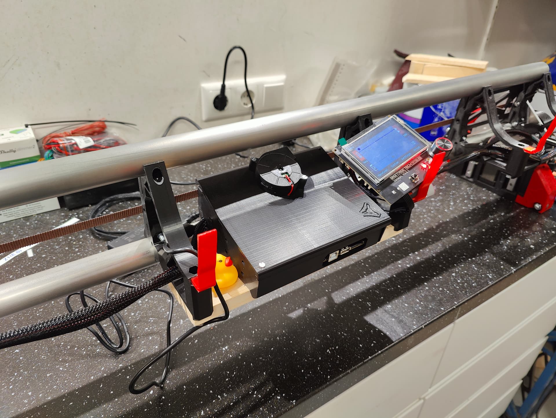

Hi fellow Dutchie! I think we should be geographically close. So I am following this with interest. I am also planning on building a LR4 with folding table.
So far your progress looks great!
