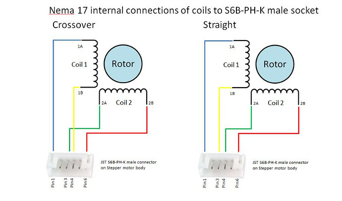

few more hours of search. Stepper just went to move as expected.
The solution is to change the cable from Crossover to Straight connection to the stepper.
See the picture for reference.
Thank you team for the help!
