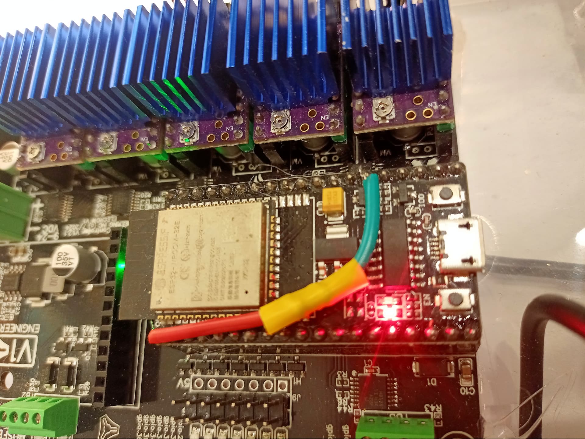

Added resistor to ESP ![]()

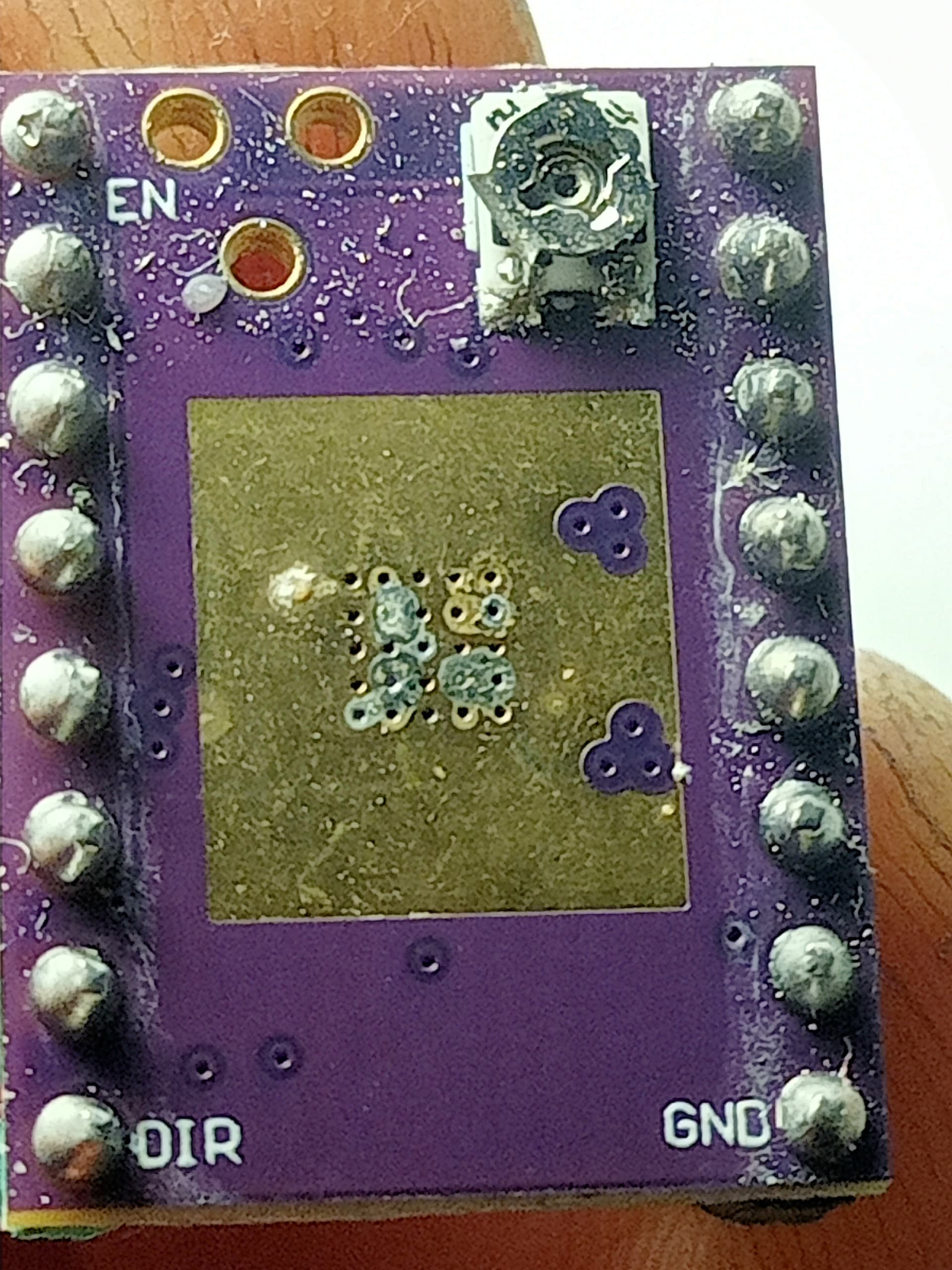

Pinouts I just found this on AliExpress:
€2.32 | TMC2208 TMC2209 ATD5833 V2.0 With Heat Sink Stepper Motor Driver StepStick 3d Printer Parts 2.5A 256 Subdivision Silent Printing

The heat sinks appear to be overlapping the pins and shorting them out. Maybe try removing them to see if that is the cause.
played with config as well but now is file from your packages. THe heatsink does not short circuit contacts. found how to stay on wifi connected and communicate with the board on wifi at the same time somewhere on fluidnc website.

I see now 2209 have different pinouts. Are you sure these pins are as expected?

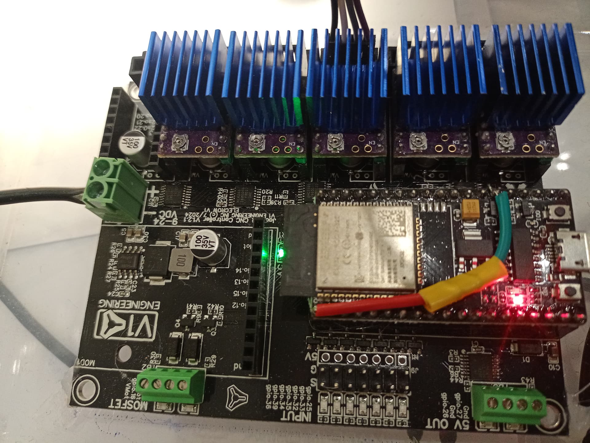

At this point we need to see your board as it is wired up please.
I have never seen those drivers though and I am sure we all suspect them to be the issue here, but maybe not.
That only means the drivers got VMOT power, not that they’re working.
Drivers are suspect, config is suspect.
As @vicious1 requested, let’s see pictures of your wired setup.
