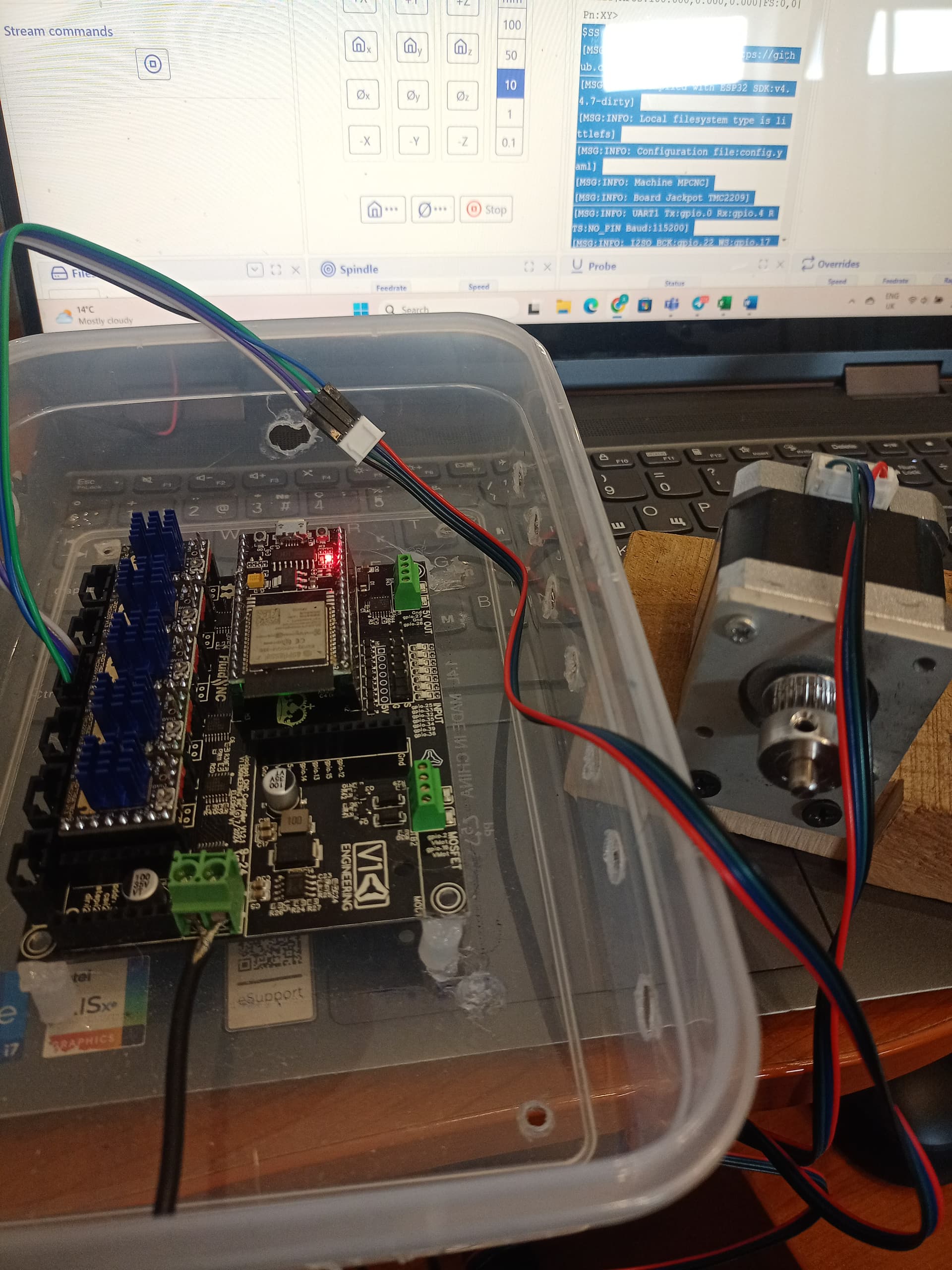

MPCNC, motors not moving or moving weak
Playing with only connected z motor.
I see now there are branded 2209 from BTT v1.2 and MKS v2.0.
Any recommendations on 2209 version?
It doesn’t look like you have the positive side of the power supply connected to the Jackpot.
The ESP-32 LED is on, and USB is not plugged in. It has to be connected.
Well bummer. I was hoping that it was an easy fix. The grey wire on the right looks like it’s plugged in to the USB. Oh well.
The power cable connected and plugged in. 19.35 V measured
The grey cable in just under the board. Sorry it is misleading. So there is only power cable and 4 stepper wires connected to Z.
Is interesting about red led on ESP. there is no USB cable but it is on. Are you sure it should be off?
Ordered new drivers BTT v1.3.
Hope arrive in two weeks

could you Please upload your config.yaml file?
You are right. It should be on.
Did you try removing a heat sink? Yours are a lot bigger than the ones I have and they cover most of the top of your stepper drivers.
This is mine:
Those heat sinks are scalloped. The contact footprint is smaller than the upper finned area. You can see that a bit in the photos up above if you look carefully.
This. Do this.
Edit:
We need to take another look at this, also. Your errors indicate that FluidNC is unable to communicate with any of the driver UARTs. At this point my guess is 50/50 whether you have an incorrect config.yaml or an incorrectly configured UART pinout on your TMC2209 step sticks.

other than the holding amps ( needs to be 0.700a) the config seems legit, i would suspect bad clones/drivers, please try also connecting all the motors (steppers) before powering on.
Dang, those heatsinks are very very close. Try pulling them all off just in case. Normally the scalloped ones are not that wide. I did no initially suspect them but I do now.
We need someone to design a 3d-printed heat sink installation template that helps position the heat sinks on install (these ones are different than our usual ones, so it wouldn’t help here- or at least would need a different version.)
This probably isn’t a pin short, though- you could take down three of the 5 with one UART pin short, but not the other two which are muxed.
This most likely is a misconfiguration of the UARTs on the stepper driver.
Easiest/cheapest way to fix it is probably to order replacement 2209s that are properly configured.
Reworking these particular step sticks will likely require a jumper/short to connect the UARTs on these modules in a way that works for FluidNC.
Good point, I didn’t think about that.
thank you all. Ordered 2209 from BTT. Should be with no concerns. Will update as soon as tested

For the test use only one ctepper connected. Stepper is OK, just was using with other project.
Stepper WEAKLY SHAKING
$SS result is below
:frowning:
$SS
[MSG:INFO: FluidNC v3.9.1 https://github.com/bdring/FluidNC]
[MSG:INFO: Machine MPCNC]
[MSG:INFO: Axis count 3]
[MSG:INFO:   Motor0]
[MSG:INFO:  X Neg Limit gpio.25]
[MSG:INFO:   Motor1]
[MSG:INFO:  X2 Neg Limit gpio.35]
[MSG:INFO:   Motor0]
[MSG:INFO:  Y Neg Limit gpio.33]
[MSG:INFO:   Motor1]
[MSG:INFO:  Y2 Neg Limit gpio.34]
[MSG:INFO: Axis Z (-100.000,200.000)]
[MSG:INFO:   Motor0]
[MSG:INFO:  Z Neg Limit gpio.32:low]
[MSG:INFO: X2 Axis driver test passed]
[MSG:INFO: Connecting to STA SSID:HUAWEI-B535-2154]
[MSG:INFO: Connecting.]
[MSG:INFO: Connecting..]
[MSG:INFO: Connected - IP is 192.168.8.187]
[MSG:INFO: WiFi on]
[MSG:INFO: Start mDNS with hostname:http://fluidnc.local/]
[MSG:INFO: Probe gpio.36:low]
ok
Are you sure you have them wired correctly? Two colours on the cable are being switched (blue/green). Can you switch those or try without your extension?
