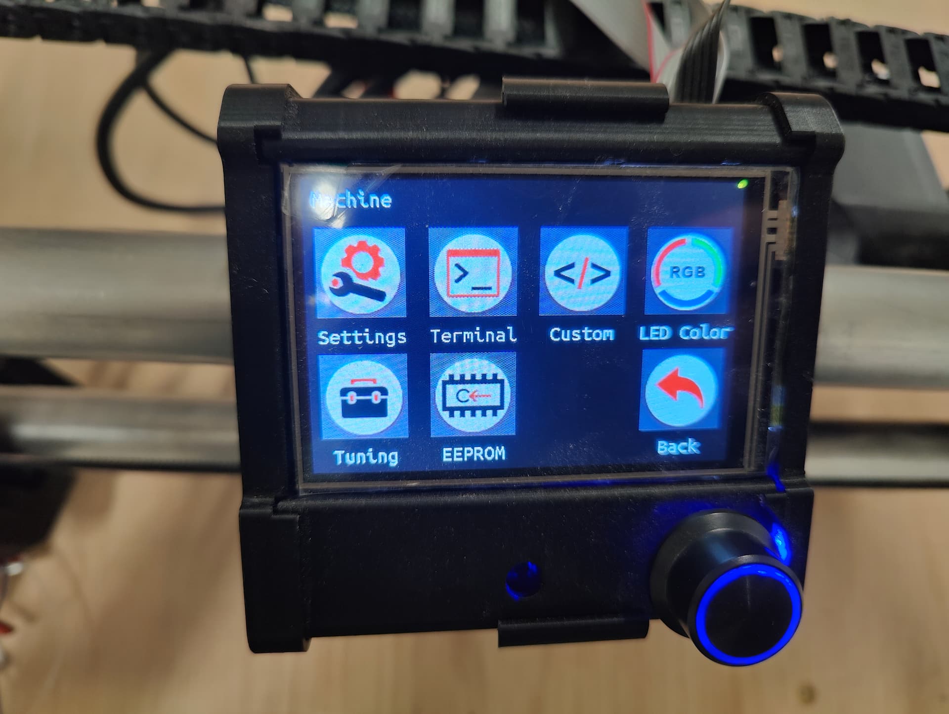

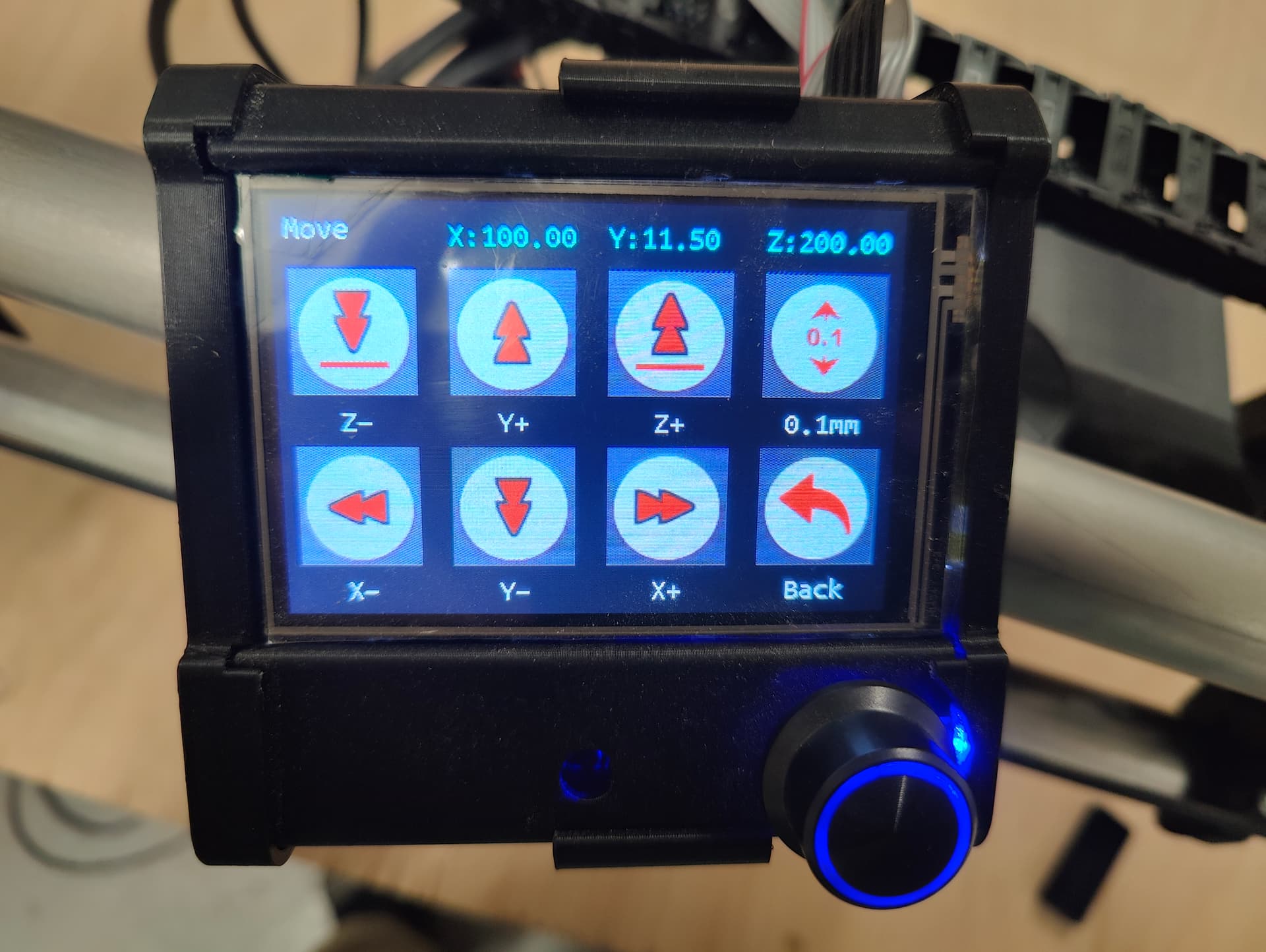

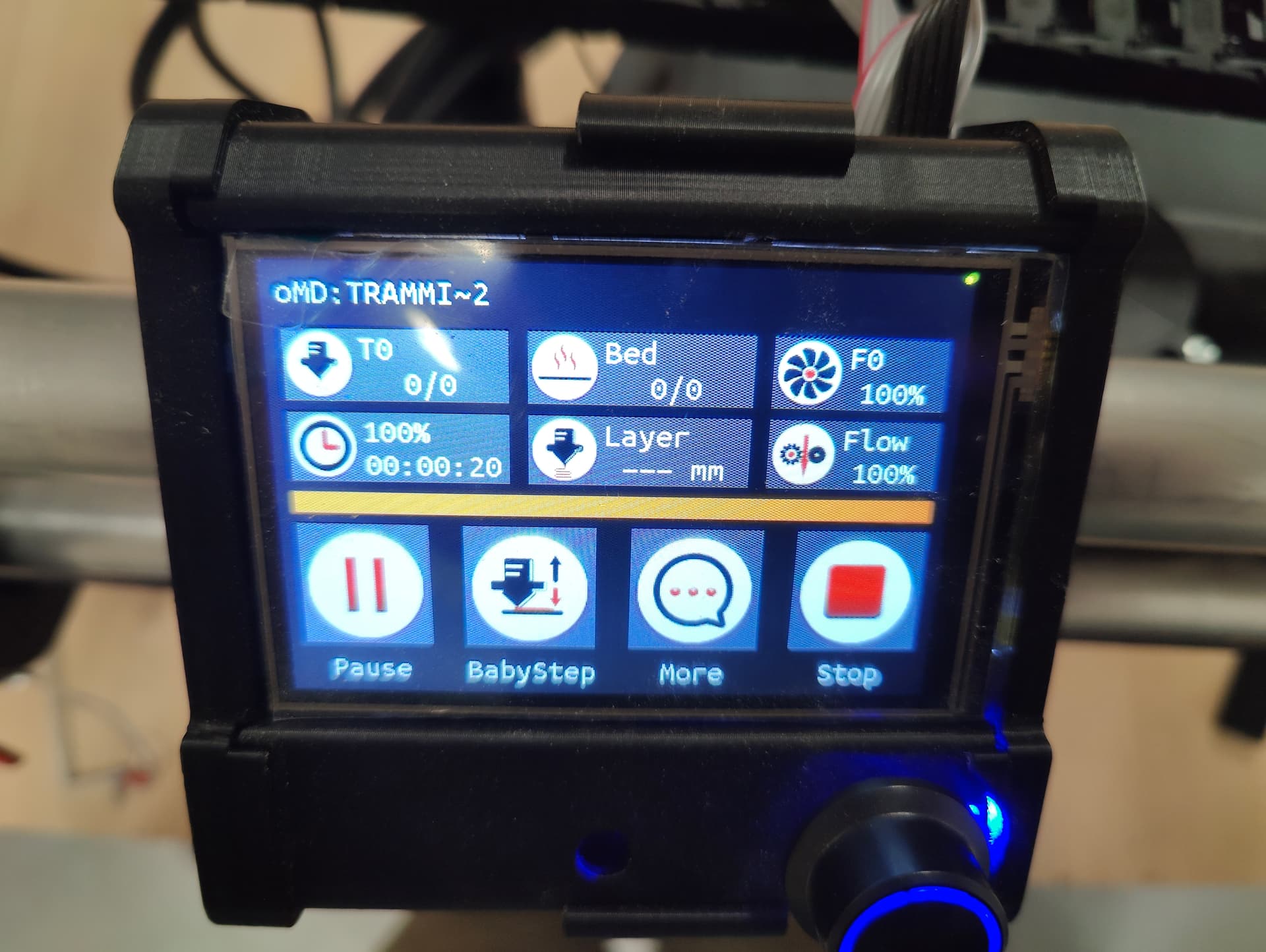

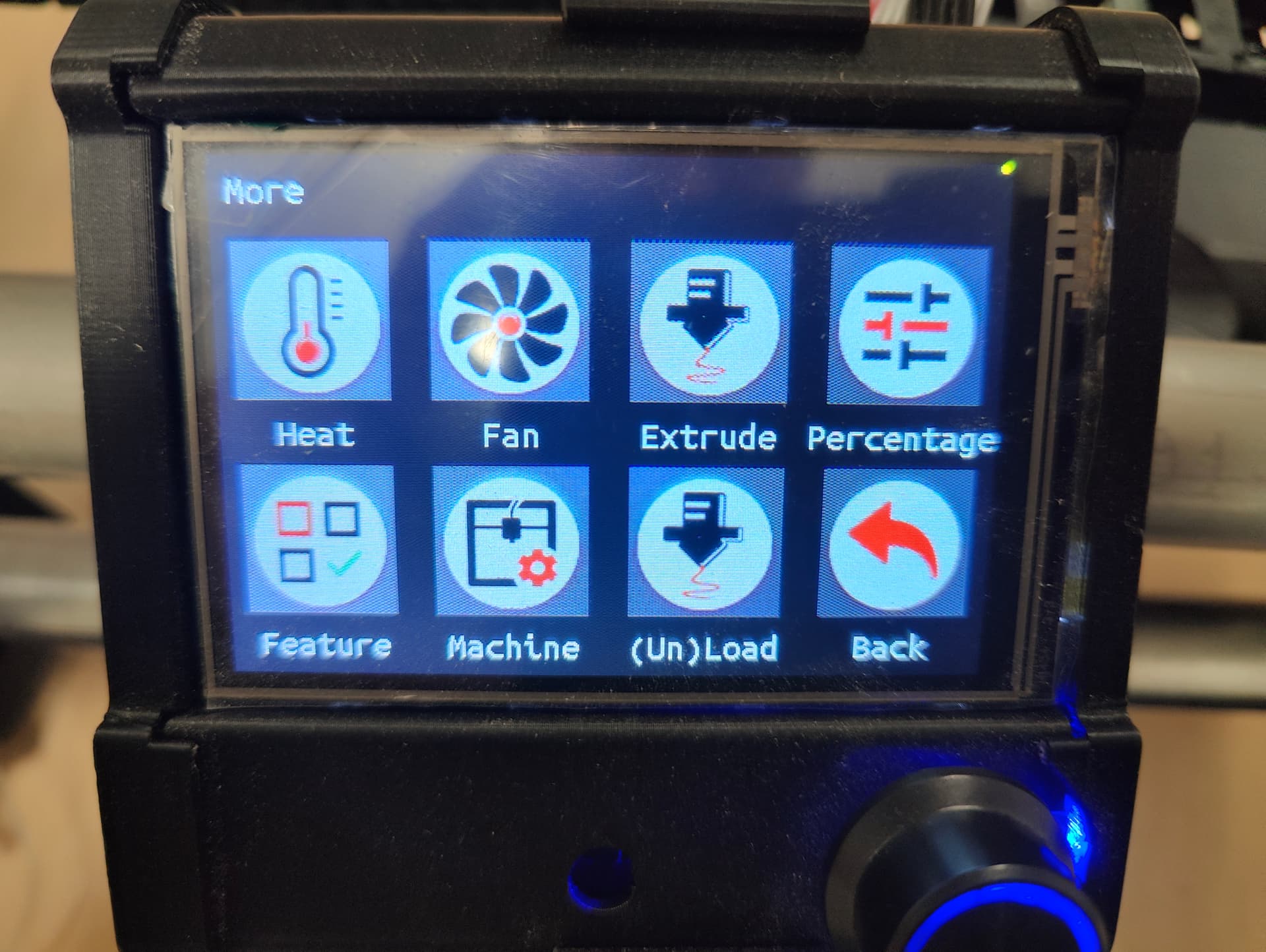

Some screenshots;
during operation;
The ā€œMoreā€ menu;
In more: ā€œMachineā€ menu;
The screen that i’m actually looking for with the X - Y - Z position in the top (this one is in ā€œMoveā€, which is not available during operation);
I think i’ve seen all sub-menu’s that are available during operation, but not yet have seen the coordinates.
Does anyone know if it’s possible to show the coordinates?

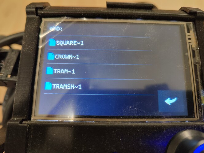

Also another, less important one; In the print menu, file names are cut-off at ~6 characters. More then half the screen is not used. Can I modify the number of characters that is shown from file names?

I’m pretty sure that the coordinates are not shown during a print job. But to be honest, I’ve never looked.
One thing to consider is that the position of the machine could be constantly changing during a print job, sometimes hundreds of times in a few seconds. Several commands may be cached in the controller, so the position being processed by the controller may not actually be the current location of the machine.
For example, if the machine starts at X0 Y0, and a print job contains a G01 X2100 Y1400 command immediately followed by a G01 X10 Y1200 command processed, then the controller processes the first command and then assumes that the machine instantly goes to X2100 Y1400 and moves on to process the next command. The machine may think that both commands are finished, even though it has barely left the X0 Y0 starting line.
I know that doesn’t directly apply to your application, as there is a fixed location at each pause in the print job. But it may explain why the programmers never bothered to display coordinates in real time during a print job.
If you need to access the Move menu to determine the Z location, you may need to break the print job into several files, and then get the information at the end of each print job. Personally I would simply enter the commands manually on the TFT screen, but I’m old school (and old…)
It’s definitrely possible, as my LR3 with SKR Pro v1.2 displays the full file names. My Ender3 does not.
I’m pretty sure that there is a parameter in either Configuration.h or Adv_Configuration.h that will allow this, but that would require recompiling your firmware. If you are familiar and comfortable with that process, then you could go that route. I think the parameter is LONG_FILENAME_HOST_SUPPORT
You can also investigate the M20 L command and the M33 command.

Regarding the file name length: for now i have to make sure that the file name length is short and there are not to much files on the card. Maybe in the future i will try compiling a modified version. First i want the machine to be useful.

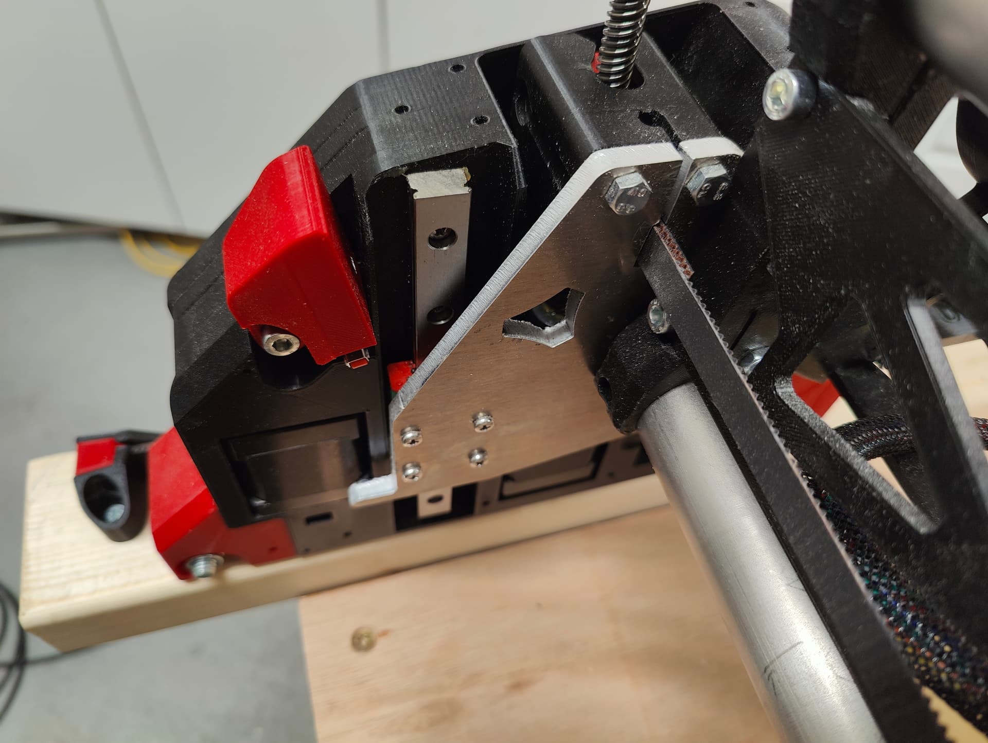

But I now did notice that the Z-switch blocks are not in the same place that they were before;
During homing to Z-stop, I noticed the red block was moving.
I have to move them down and fix them more thightly tonight and then try again. It is a balance between tightening enough and not to tight to make the printed 6-sided hole round :slight_smile:
Definitely should be tighter. The nut should not spin. The only time they spin is the first initial threading. If you cross thread it they spin, after that you can literally crush the nut into the part. With that said, you want that part tight, but loose enough that it can move if you screw up.

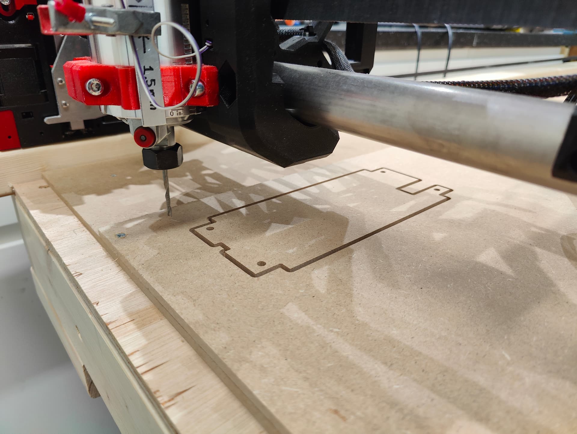

I did my first real test cut today; a very small part of the strut plate to see how it all works, and if I need to modify something in ESTLcam. I’m very happy with the result for a machine i build myself. :exploding_head:

Just an update on the progress from my side; I milled the strut plates from MDF (Whoehoe, its first real part :smiley: ).
But when I wanted to install them, the size was off by almost 20 mm. The screw holes and bracket holes where also too small. I’m thinking of a few possible causes;
  • Wrong belt type installed; checked my order; I think it was the correct one (GT2).
  • Part not designed with correct size. I used this generator.
  • ā€œSomethingā€ wrongly configured in EstlCam. This last one is my first suspect
