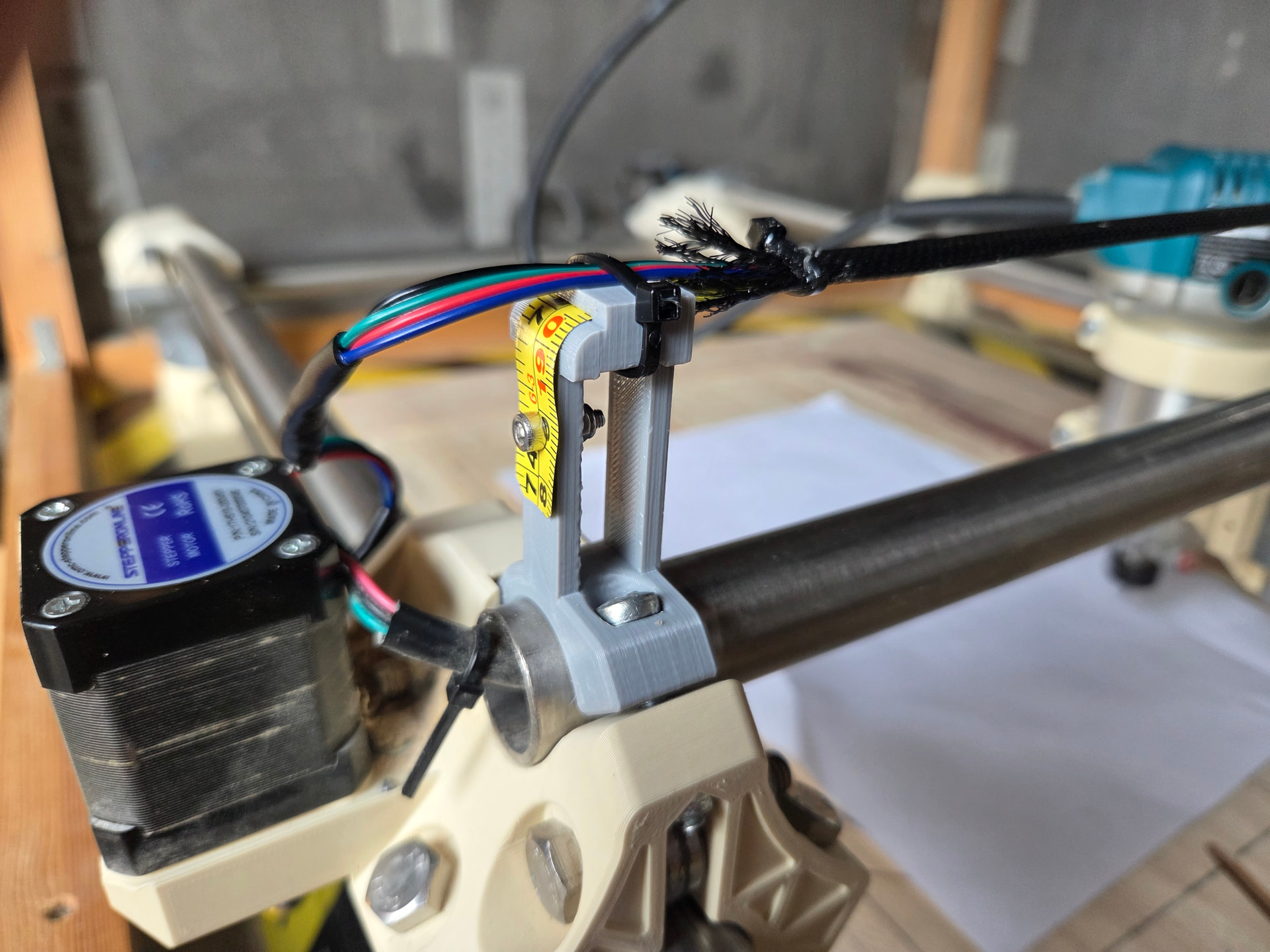

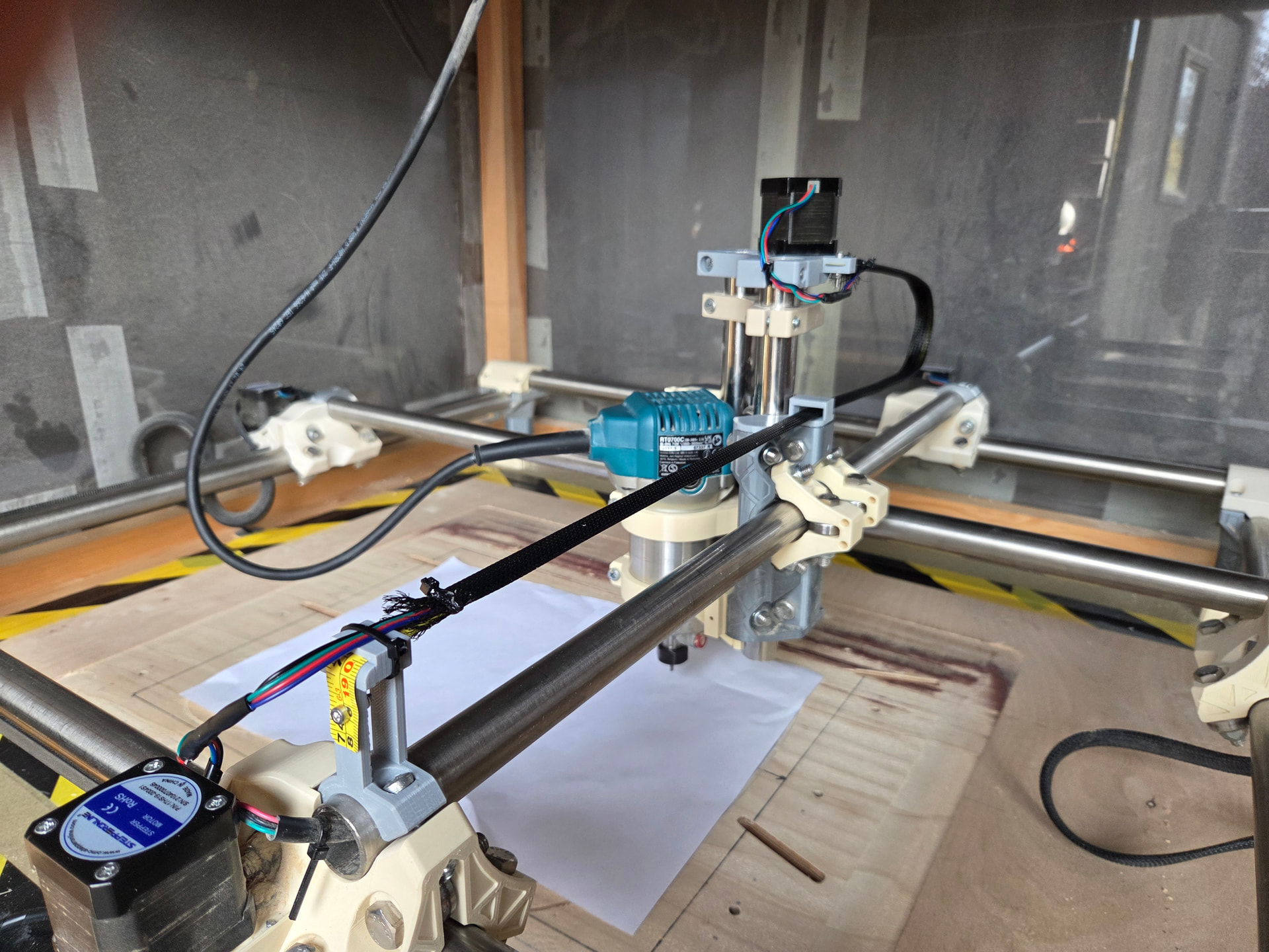

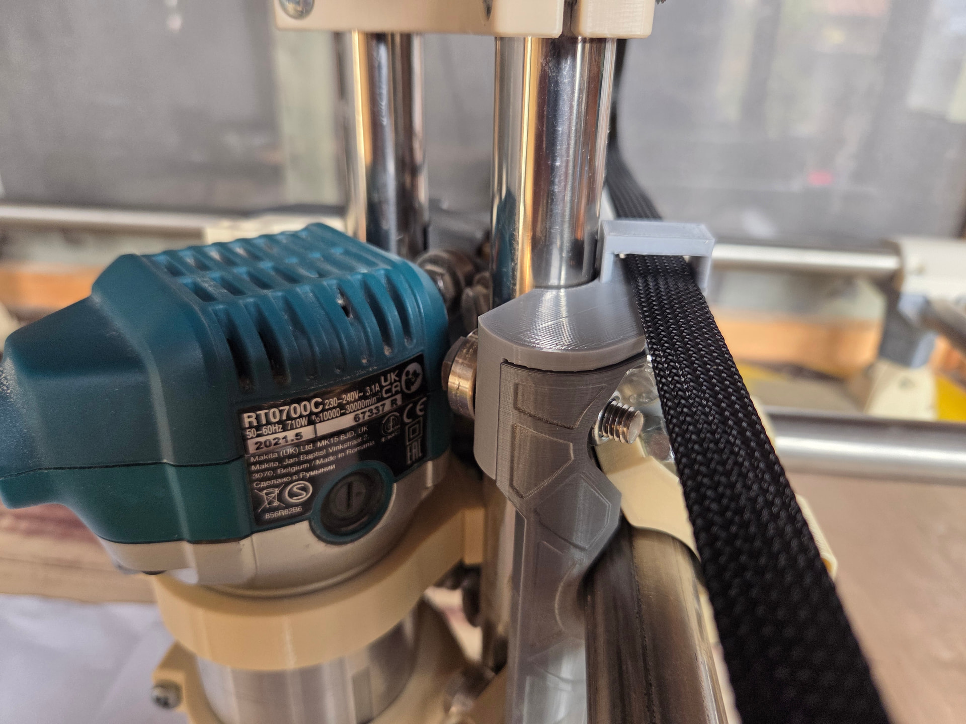

I am still very happy with my Z routing with the tape measure. I continued it and incorporated both the X runs and tied it along the side. It works but has some kinking going on. I too used the cheap (almost free) 3/4" Harbor Freight tape.

For the Y runs I am struggling with being comfortable with the tape, two sets of wires and braided sleeving feeling secure at the roller plate and not becoming a kinked up mess. Meanwhile, printing some cable chain links to experiment with, again not totally sure how it will secured at the motor/roller assembly.
