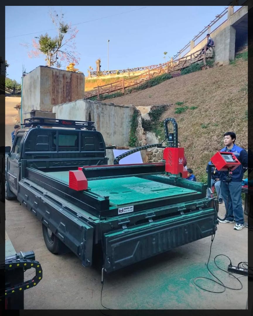

didn’t someone build a large one like this for the big dome house panels or something?
Edit… yep… here it is.
Not as wide in X, but long…
That was a diode laser build only i think

Was just pointing out that someone else built a large one like he’s talking about, at least in length
