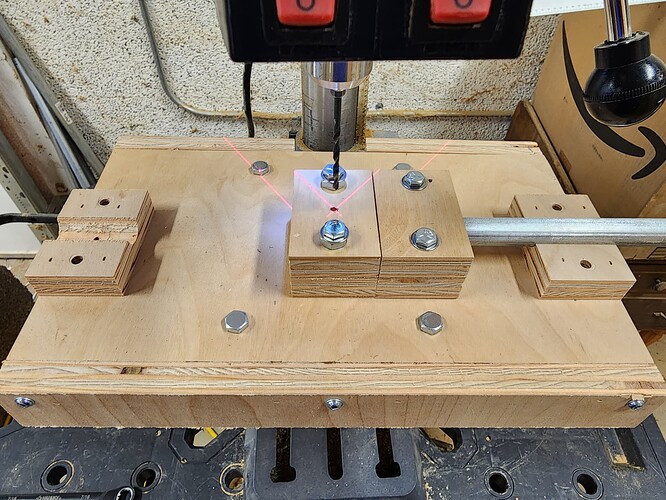

I am finally back on my rail project. I needed to elevate the rail to allow the new rail mounts to glide along the Y-axis. For this I designed both a standoff for the rail to rest on and an internal clamp to hold the rail in place. Although my current rails are supported at 200mm intervals, I decided to go with 150mm spacing because the rail is elevated.
But for this to work I needed holes drilled at 150mm intervals along the rail. While I could have created a fixture on my current full sheet Lowrider to drill 1/2 way (or more) along a blank rail and then flipped (or indexed) the rail to complete the operation, I wanted to see how I would do this if I only had my much smaller Lowrider. Again, I could have created a fixture on my smaller Lowrider and then drilled and indexed multiple times to complete the operation. But I decided to have a little fun (and make my life harder) and create a fixture for my drill press to manually drill each hole. Maybe I am sadistic.
After completing the design of my fixture, I placed each piece (virtually) into a piece of stock (3/4 plywood offcut) and created the toolpaths needed.
After milling the pieces, I assembled the fixed pieces and mounted the base to my drill press.
Now I was ready to begin drilling the holes in a 10’ stick of 1/2" EMT. This is equivalent to 3048mm which would be 21 holes on 150mm centers with 12mm on each end. After marking the initial 12mm position I place this mark at the hole in the Lower Drill Clamp with a Lower Registration Clamp. The Registration Clamp assembly is needed for not only indexing the rail 150mm but also for maintaining the correct rotational position of the rail.
With both upper clamps in place I was ready to drill the first hole. By the way I had inserted a brass hex space in the Upper Drill Clamp and bored out the threads to help keep the drill bit aligned and consistent as I processed the rail.
Next I removed the Upper Drill Clamp but NOT the Upper Registration Clamp and then moved (indexed) the rail so that the Registration Clamp assembly was against the Lower Outfeed Clamp. I also added a Lower Registration Clamp against the Lower Drill Clamp and then added clamps for both. Time to drill the next hole. Then it was a simple matter of rinse and repeat.
As the Registration Clamp assemblies were indexed off the the fixture they were removed and reused as needed. I had created three of these assemblies for this process.
The rail turned out just as I expected it to. And I got an opportunity to use my Lowrider to create the pieces for a fixture.
