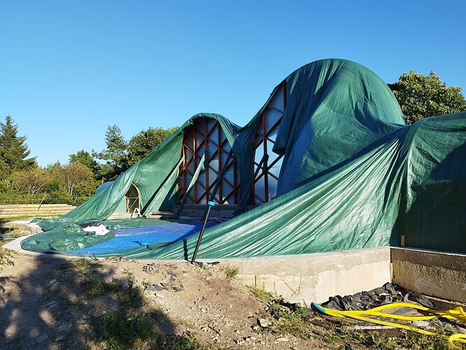

Yep, it needs to run constantly. But apparently, the glue I used for stitching parts together was losing its grip after 2 days and the last picture is the outcome :D. Now I’m sewing it all together, to make a new attempt.

24 hours after applying the glue, it was so strong that when tearing, the fabric tore next to the glue spot, not over the glue. And 48 hours after sun exposure, the glue tore like toilet paper from perforation :D. A week’s work was lost, but yes, luckily the worst was avoided.
