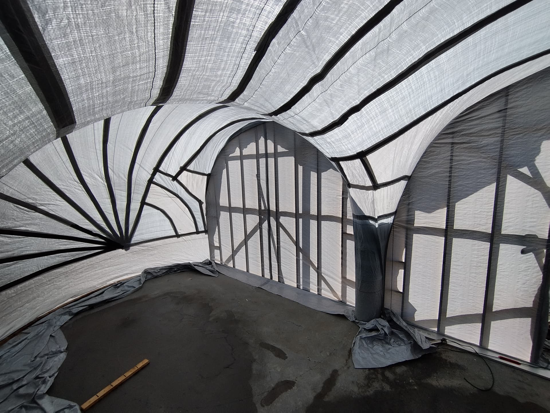

I began planning my house in VR, primarily for its remarkable advantages in visualizing three-dimensional space and the minimal investment needed to get started. With a Meta Quest 3S (I Started with Meta Quest 2) headset, which starts at around $300, everything required is included, as the Gravity Sketch software remains free to use for individuals.
Video of working on Site with Gravity Sketch

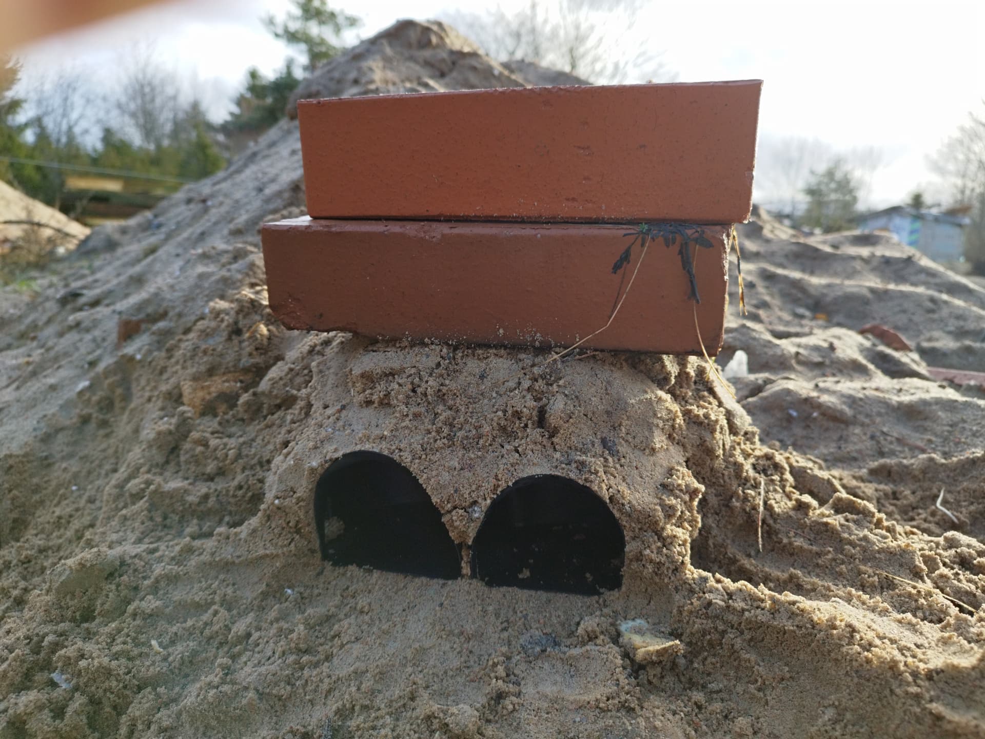

To conduct initial strength tests, I printed a scale model of the house at 1:100 using a 3D printer.

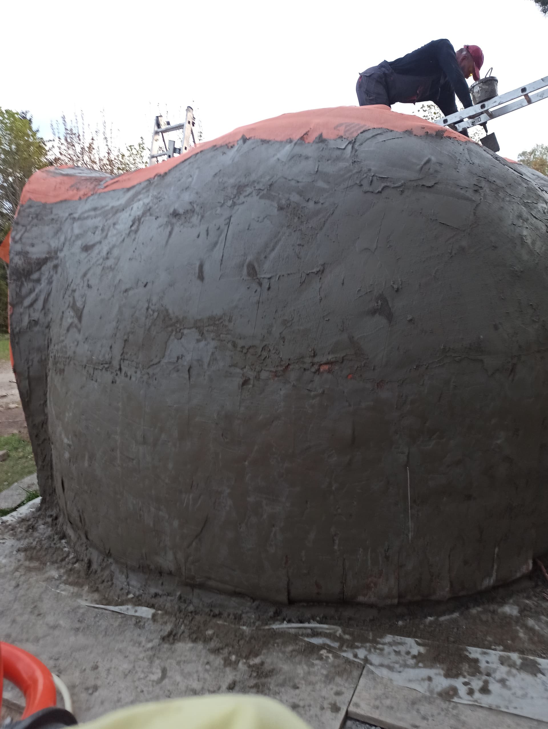

Seeing that these initial results were promising, I moved forward with a 1:3 scale prototype, which also functions as a garden shed.
Once that prototype proved successful (with much trial and error), I proceeded with the full-scale building.
For more detailed strength analysis, online platforms like SimScale can be helpful. They allow you to identify any weak points in your design and focus attention on specific improvements during development.

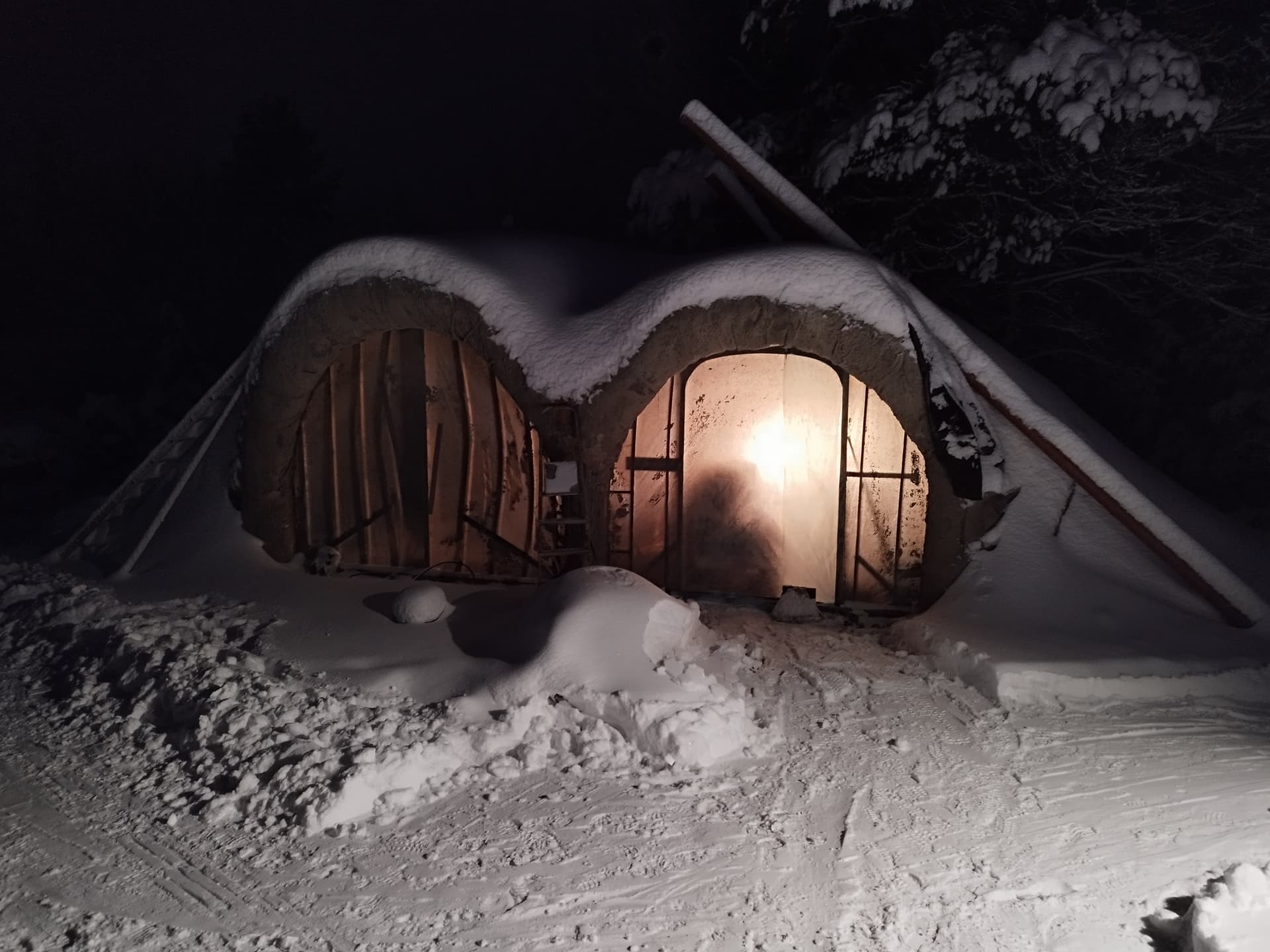

Do you intend to cover it with earth like you’ve done with the model?
Yep, that’s the point of having roof paint that renews itself :D. Also, earth will be as additional insulation on the summer heat and winter cold.
But does it need mowing? :rofl:
If it overgrows then I can use my goats for mowing :wink:
