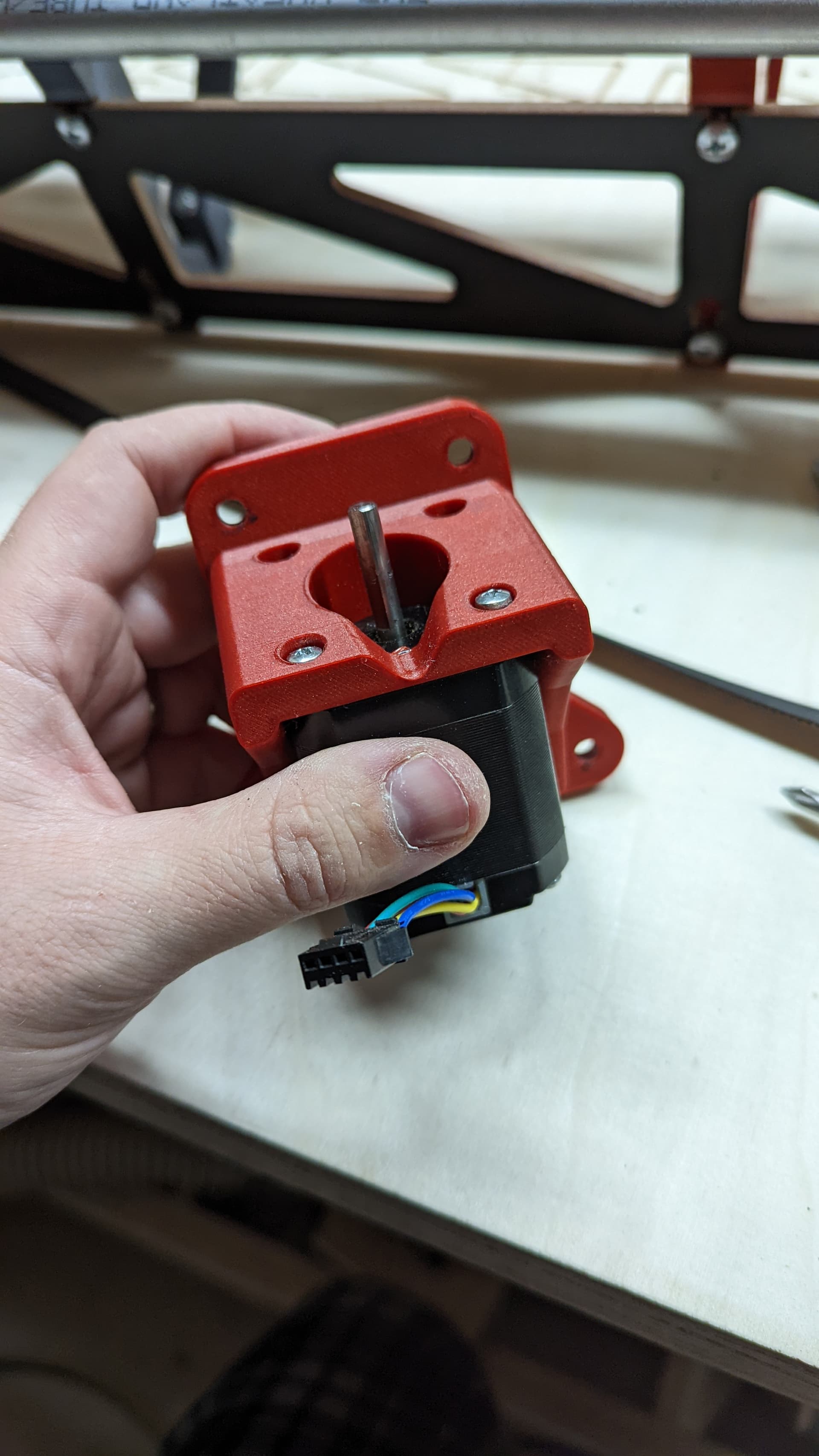

I haven’t had a chance to leak anything. Here is a motor.
I installed this one the with the wires the wrong way. I had to take it off and share. I may be the slowest building them. There have been some good cuts. No reports of performance issues yet. We’ve complained about everything we possibly can (I have, at least) and I haven’t seen any show stoppers just yet.

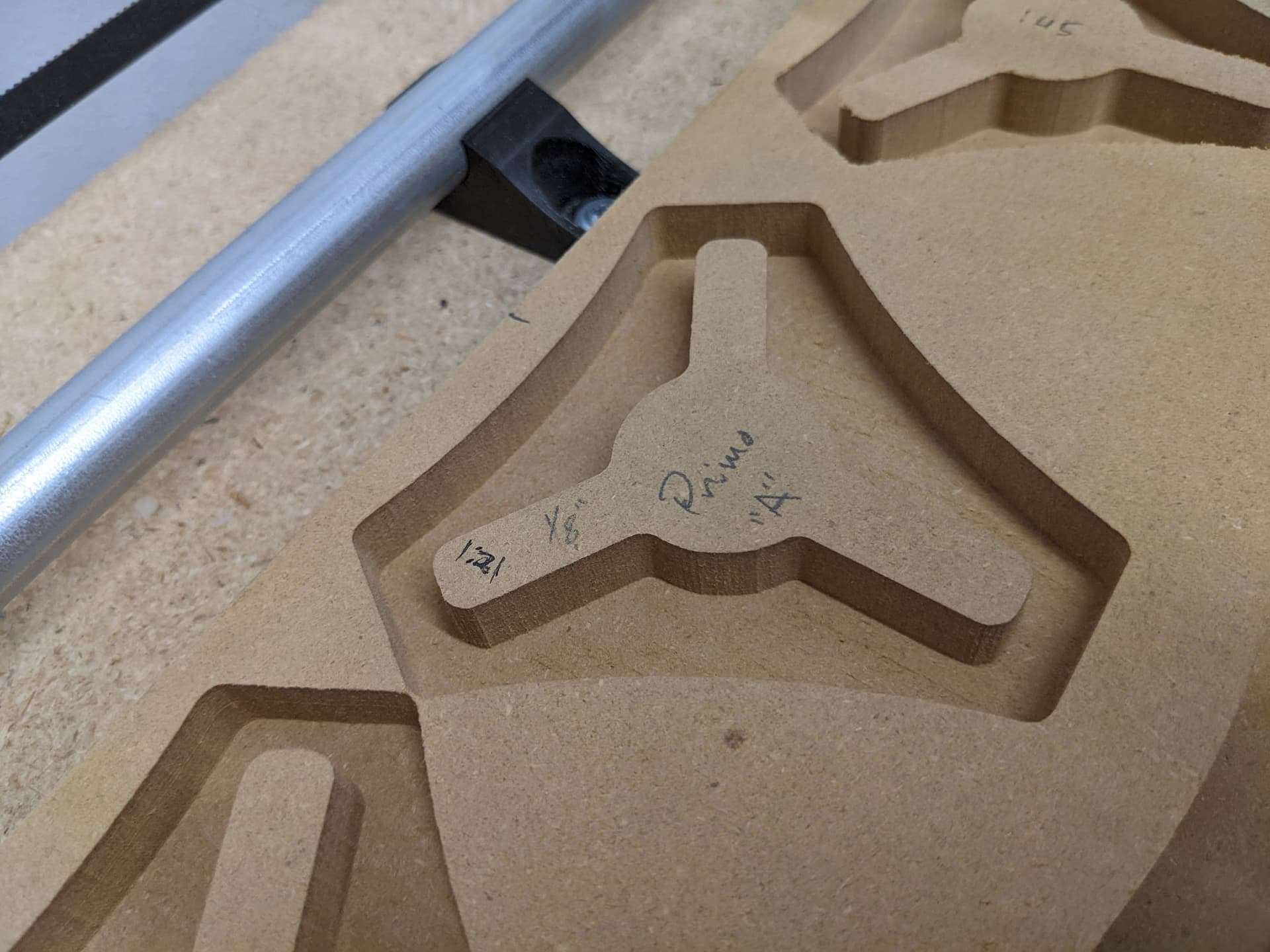

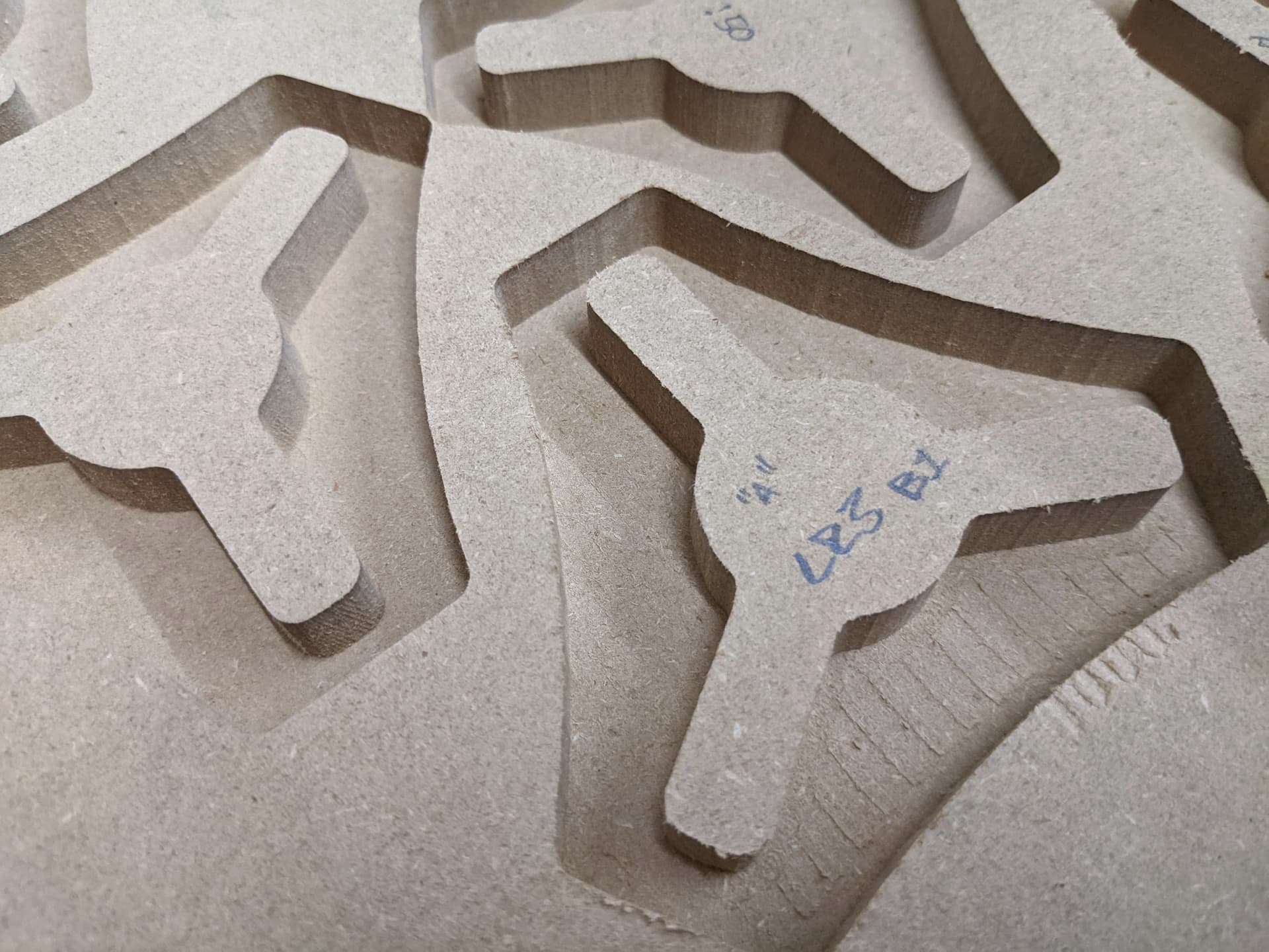

So check this out. I ran some speed tests, this is the result of this gcode Cnc race! - #107 by vicious1 this Gcode is from the fastest cut I made on the Primo with an 1/8" bit video.
The Primo cut was a bit better but the Primo is also 14"x11"x3" cutting area, the LR3 is 48"x25"x3"
Very happy with this.
It is a worse bottom finish than the Primo’s, but both have some wavy stuff going on the LR3 pocket seems extra wonky on that one side I am investigating it.
Dimensionally pretty good? That looks better than my LR2 haha so I’d be happy haha
