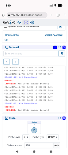

  • Restored coloring to the Terminal
  • Added setting for max Terminal messages to keep
  • Improved Terminal performance, especially when at max messages
  • Some rendering efficiency improvements

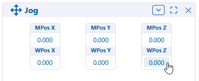

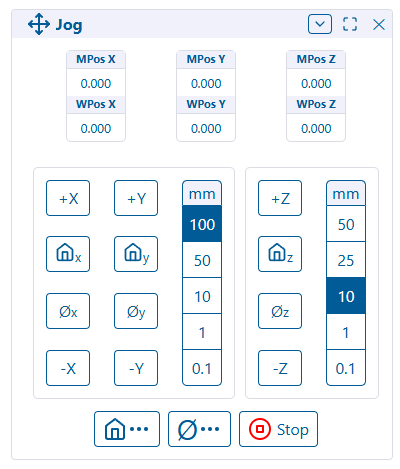

I’ve also made some changes to the Jog Panel that have been on my list for a while:
Go To Position
Position indicators now have button overlays for “Go To Position”
Separate Jog settings for Z
This one has been discussed here since WebUI v3 was a thing. I believe @azab2c even made a similar PR to the original repo that was denied.

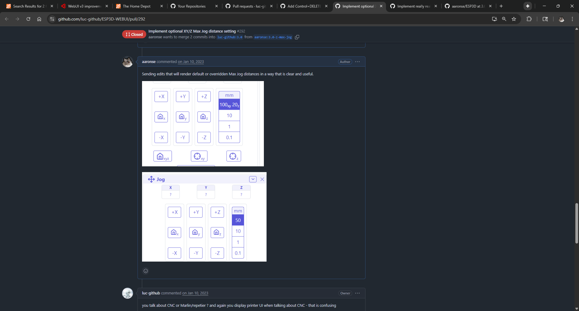

I ran out of patience for that pull request… Implement optional XY/Z Max Jog distance setting by aaronse · Pull Request #292 · luc-github/ESP3D-WEBUI · GitHub it’s been nice to use personally, sorry I wasn’t able to share broadly. Wider than average button makes it a bit easier to touch.
Here’s another minor pull request that’s a no brainer quality of life improvement imo Implement really really basic autocorrect by aaronse · Pull Request #287 · luc-github/ESP3D-WEBUI · GitHub

Color is awesome, separate Z jog is awesome. I forgot to check the " go to". I will hit that shortly.
It was very nice to move XY at 500mm and the Z at 10 back and forth quickly. I was seeing if I had clearance under a shelf in the new table home, and I moved it all around. SO AWESOME.

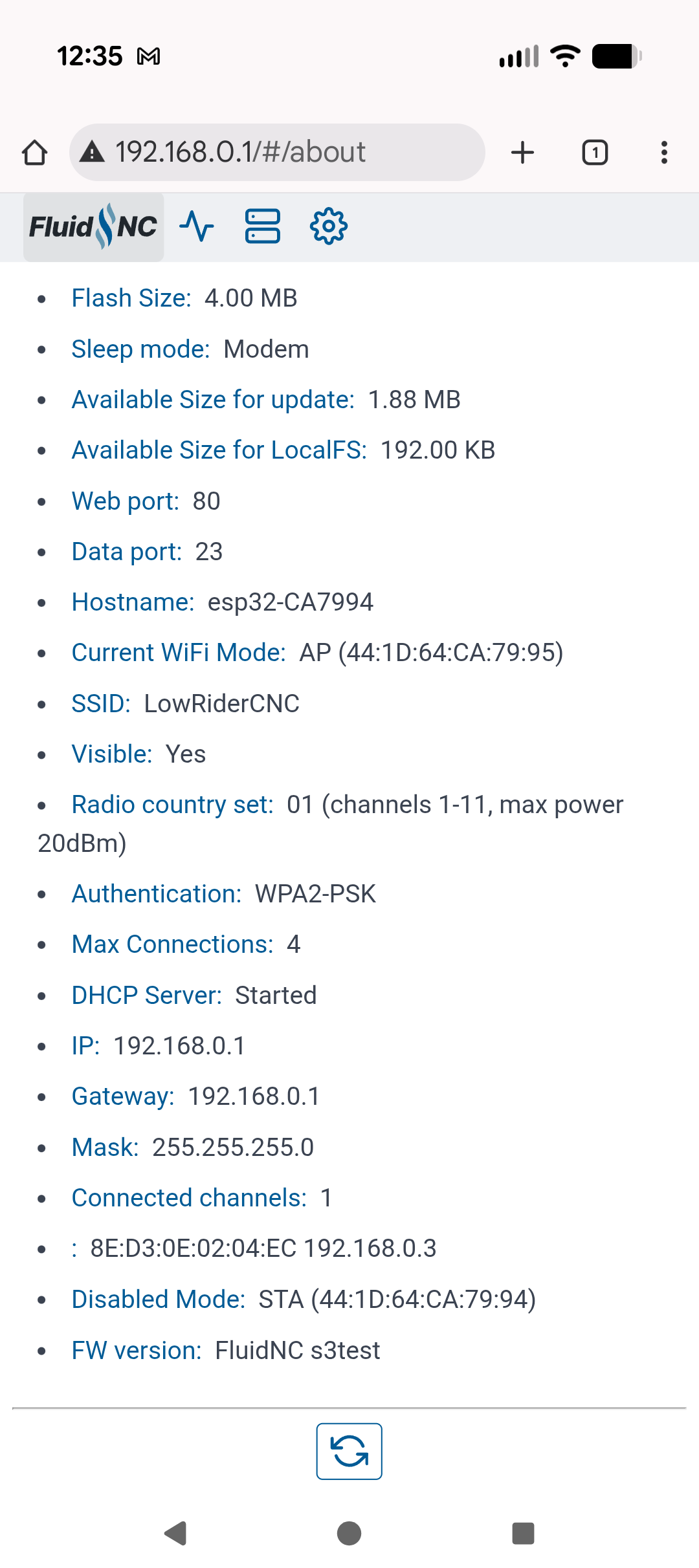

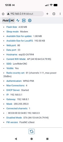

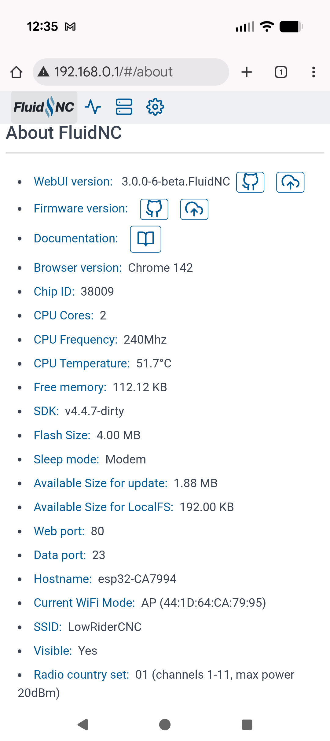

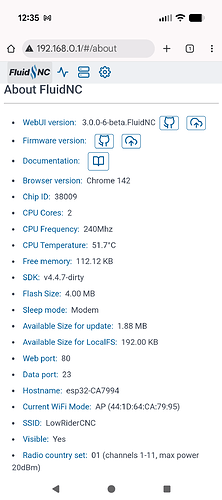

We have a firmware version with no output, maybe those are just links to use when in STA mode?
At the bottom we do get a FW version with enough info to figure out which it is, name instead of number.
I also agree, I see nothing special on the information tab that is not on the status module.

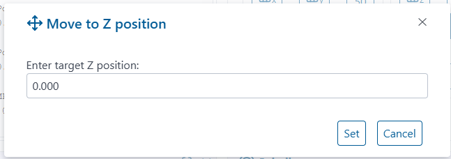

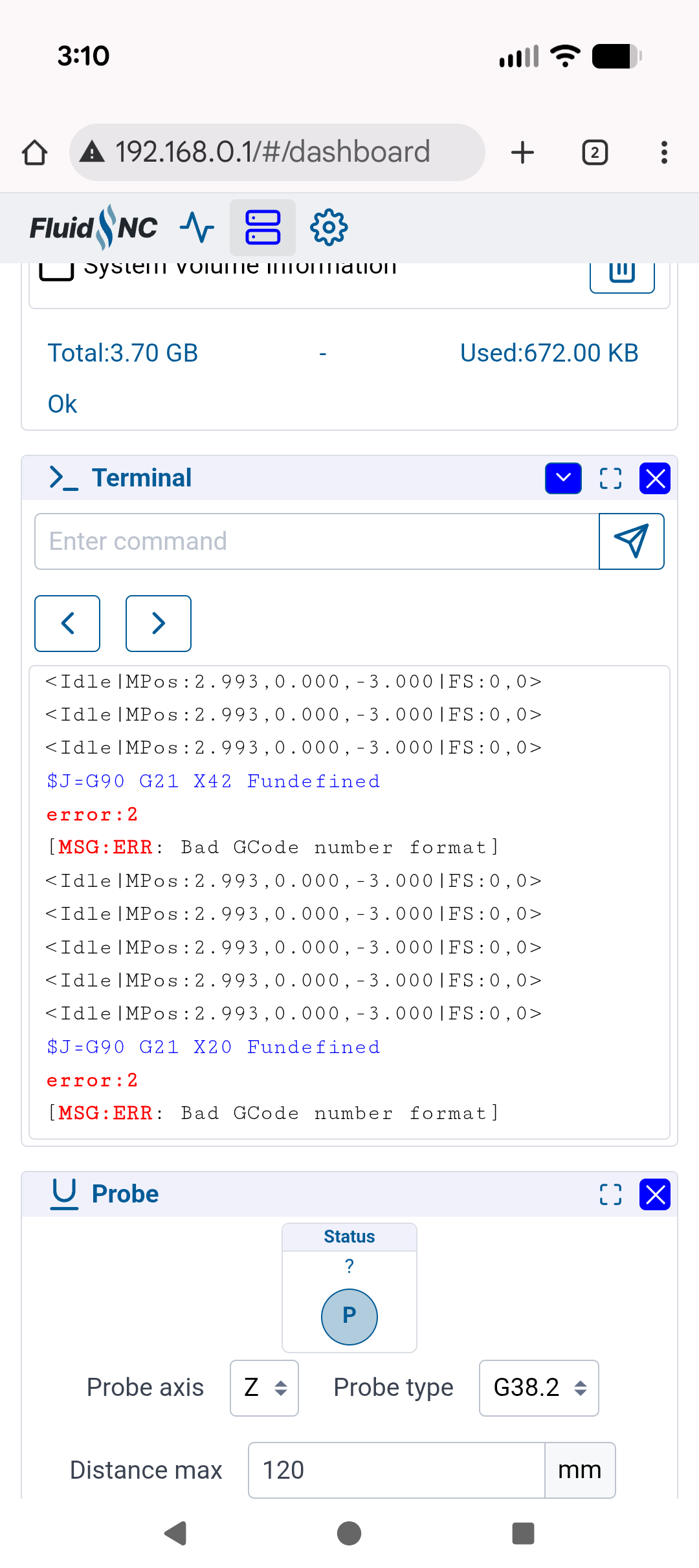

Goto didn’t work.
Looks like it’s relying on a feed speed that’s not yet set. Does it work if you select a different jog speed for XY first?
As soon as I can get it to compile again, I’ll look at it :sweat_smile:
What does your jog panel look like? Does the normal jog work when the “go to” doesn’t?
It should be using the same feed rates as the jog button
Odd, I can check again but yes I jogged and homed it.
ok @vicious1 … I think that’s fixed now.
index.html.gz.zip
It was working for me because I had additional axes configured where I was running, so it was falling back to the extra axis feedrate.
His logic there wasn’t great.
The real problem is that the comparisons are case-sensitive, and the axis was coming in as ‘y’ instead of ‘Y’…
