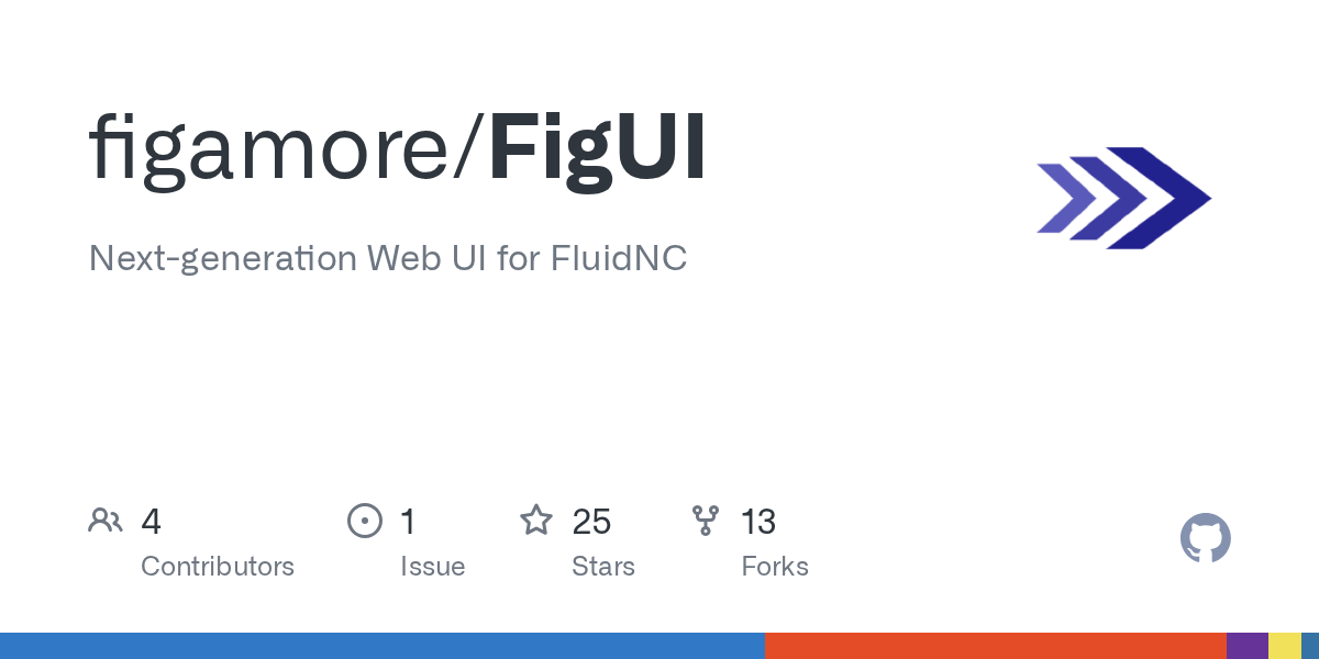

In FluidNC 4.0.4 FigUI is now an option in the web installer.
  • Added the [FigUI](FluidNC) as an option when installing via the Web Installer.
I’ll note that while FluidNC v4.0.3 is fine, I’d hold off on v4.0.4 since it has some bugs. There were some major changes under the hood.
