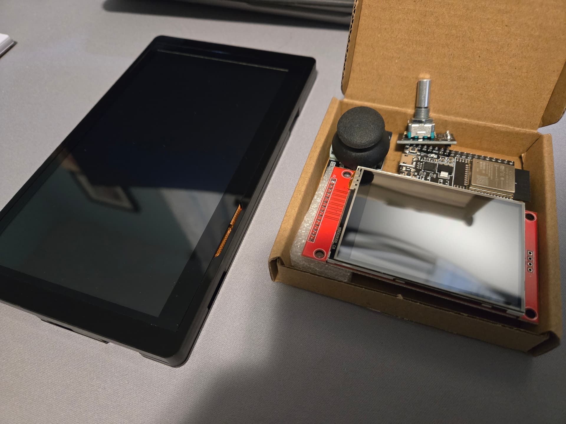

Somehow I lost my wireless pendant? I’m so confused. I had just refactored the code using AI to clean it up and structure it better. Anyway I had the other parts except the screen so it looks like I’m building a new one. I also started messing with the 7 inch screen I bought a couple months ago.

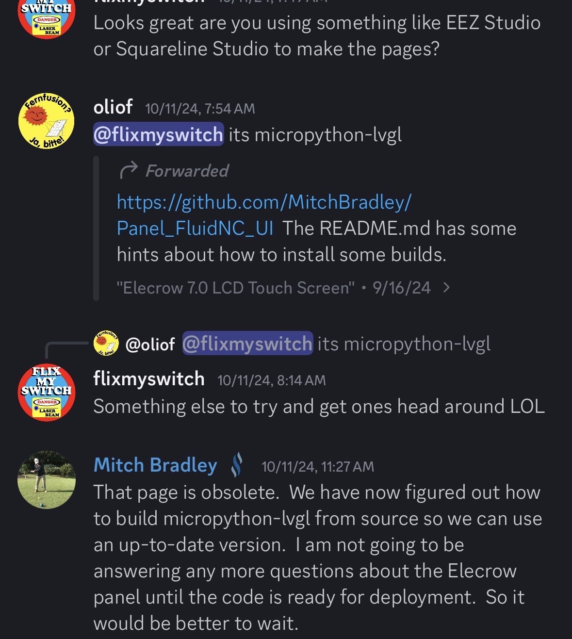

There’s a FluidNC pendant in the works over on the Discord using this display but it seems they were having issues too. I mostly just want to play with LVGL. I’m not sure anything useful is going to come from me out of this.
I think they were having issues because they chose a different route.
I thought they went away from LVGL
Maybe it was LVGL bindings to Micropython or something like that??
This was the last relevant comment:
The latest LVGL+ microPython breaks the initializing of the touch.
He later handed it off to someone else, and that guy hasn’t done anything in a while.
I think Mitch lost interest when people started bugging him before it was even close to releasing
Yea, I think they don’t want to deal with pendants anymore. There was last activity about 2 weeks ago. We’ll see but I’m not holding my breath.
The last interaction I had in a nutshell was they want folks to post documentation and implementation details.

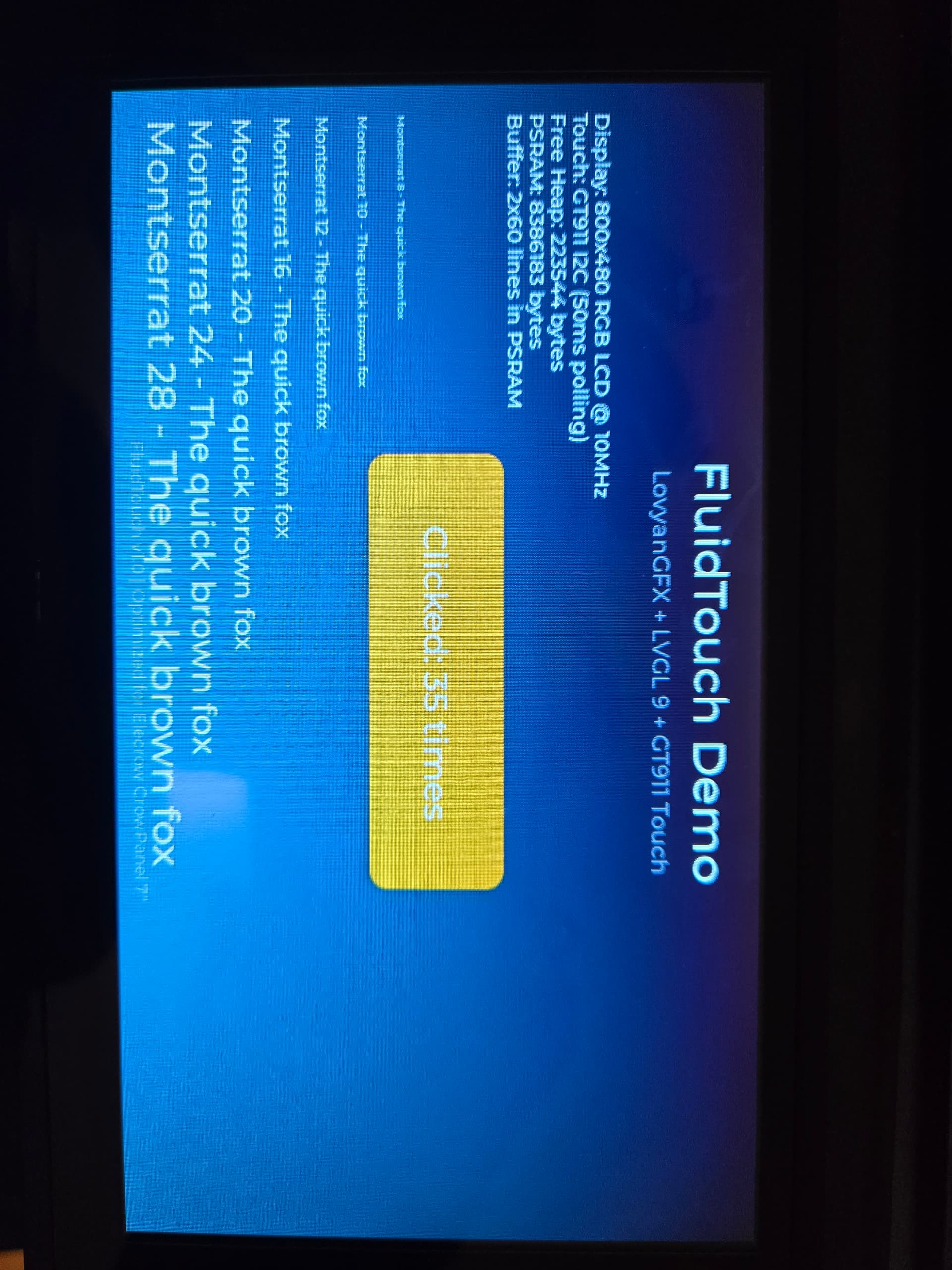

I’m not sure where to direct my hatred. Some at AI which is helpful until it starts going in circles, some at LVGL and that stupid lv_conf.h file, and some at Elecrow for old examples.
After a bunch of nonsense, I think I’m at a point where I can try and do something.

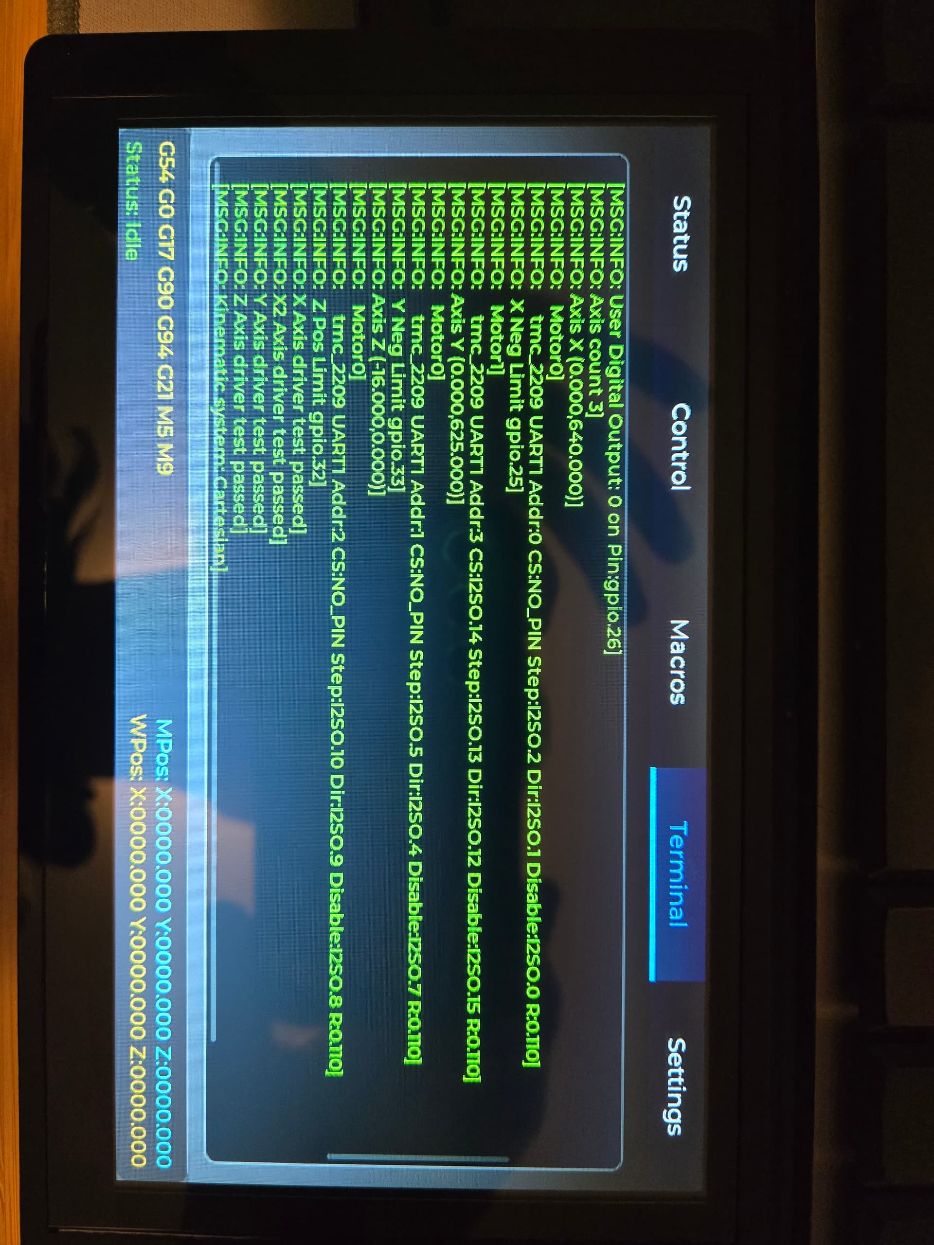

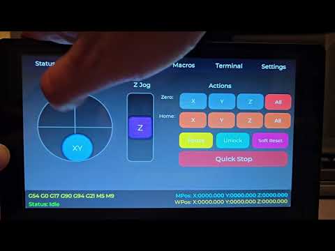

Hmm, so LVGL is pretty interesting. It does a ton of stuff for you that I was doing manually with my pendant. So, I’m messing with making a wireless FluidNC pendant out of the 7 inch screen. No promises but certainly a chunk of work I did for the other one would translate here. The one being worked on in the FluidNC discord has a design based around the WebUI tablet extension, which isn’t my favorite. Figuring out what it should look like is hard.
This doesn’t actually do anything but just messing around.
