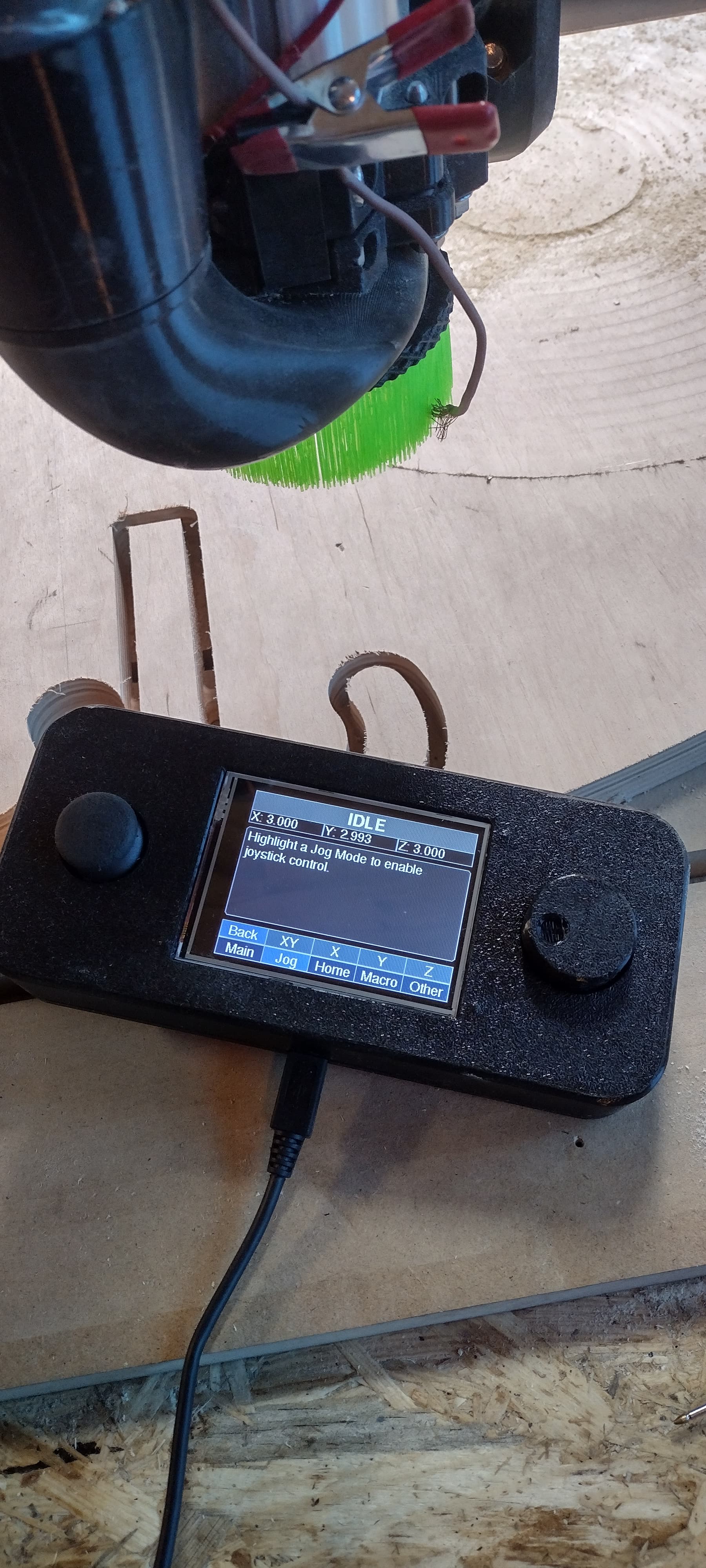

I’m not quite sure what you are looking for here. This is the jog panel built into WebUI v3 (with my dark theme).
This can be setup to control via a keyboard or other controller but you’re not going to get true joystick control. I did set it up (but no longer use it) to use a bluetooth game controller.
The jog controller I use within the WebUI is the touch/mouse jog joystick extension that I created which does have separate X/Y/Z jog modes.
What this thread has really become is for the wireless pendant that I created which does have a physical joystick with separate X/Y/Z jog modes much like my extension. That’s independent of the WebUI.

I’ve pushed up an updated version of my FluidScreen pendant to the main branch on Github. It fixes the captive portal popup of the settings page for both Android and iOS. I also added the ability to configure jog max feedrates for XY and Z. It defaults to 2400 mm/min for XY and 800 mm/min for Z. There are some improvements on the jogging itself as well.
If updating from an existing version, you’ll need to upload both the app and the file system.
Smolscreen?
It’s a 3.5 inch screen. I also shouldn’t be allowed to name anything.
Fluidscreen its a closed business in the us lol.
Now you should make it compatible with bigger screens. 8"-7" should be perfect. Also, share that with Bart, i can see that featured in the pendant page on their wiki
Supporting different screens is a huge pain. Different screens have different resolutions and different display drivers all resulting in different code. This was designed to be handheld with physical controls. If I went bigger, I’d lean more towards touchscreen, but then it might just make sense to use a tablet or like your setup. Note that they are working on a 7" pendant on the FluidNC Discord.
I will share it there at some point once it gets some more usage. There are a few things I should change before doing that. Right now I have settings hardcoded used for calculating jog times which uses default V1 settings. I can read those from the config, but I haven’t done that yet.

I’ve upgraded my FluidScreen to the new update. Jogging is a lot smoother! Thanks.

Yea, that would require recreating the user interface almost from scratch. You get in this weird place with size where once you cross a certain point, it makes more sense to just use the WebUI on a tablet. I’m in the middle of too many other projects. I haven’t seen any progress lately on that 7 inch version.
