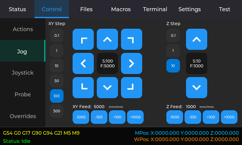

AI is proving to be a super useful tool. This is far better than I think I would have made without it. Here’s a screenshot (which AI helped me make a web server for and capture) of the work in progress jog screen. I still plan on having a joystick jog but sometimes I don’t want that.

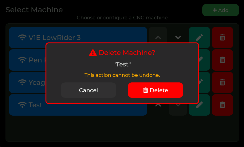

Ok, I’m getting a bit excited. Today I came to the realization that wirelessly, it would be nice to use for all of my FluidNC devices of which I currently have 3 (LR3, pen plotter, eggbot). So, I’m working on a machine selection page. Each machine could be wired/wireless. Each wireless machine might connect to a different wireless network.

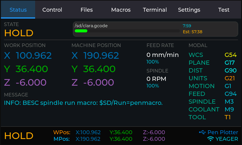

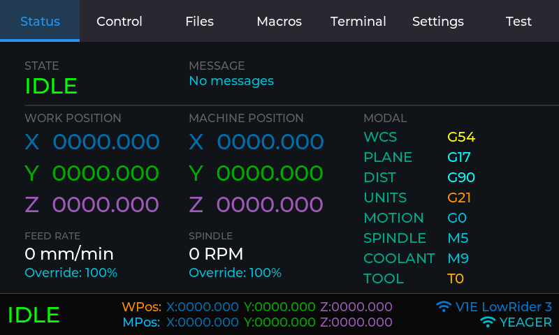

I’m pretty happy with the look of the status tab and status bar (which always shows). I think it’s time to link it up to a machine and see how well it performs updating those values in real time.

Here’s a clip of current functionality. Probably getting rid of the terminal tab since it was hurting performance.
While I used a lot of words, AI has still written 95% of the actual code. I told it to “wire up” the screens and it made a whole FluidNC client and connected the buttons to the appropriate commands. I had to have it tweak a bunch of things but wildly impressed at how close it got. I would have made no where near this progress without it.
Still a bunch of things to do, but it’s already reached a useful state.
