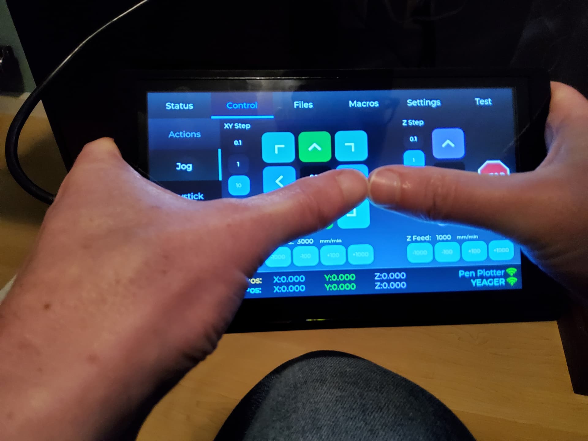

I have small hands, but I think 7 inch is an appropriate size for a pendant. I can hold it with one hand on each side and reach the whole screen without having to let go.

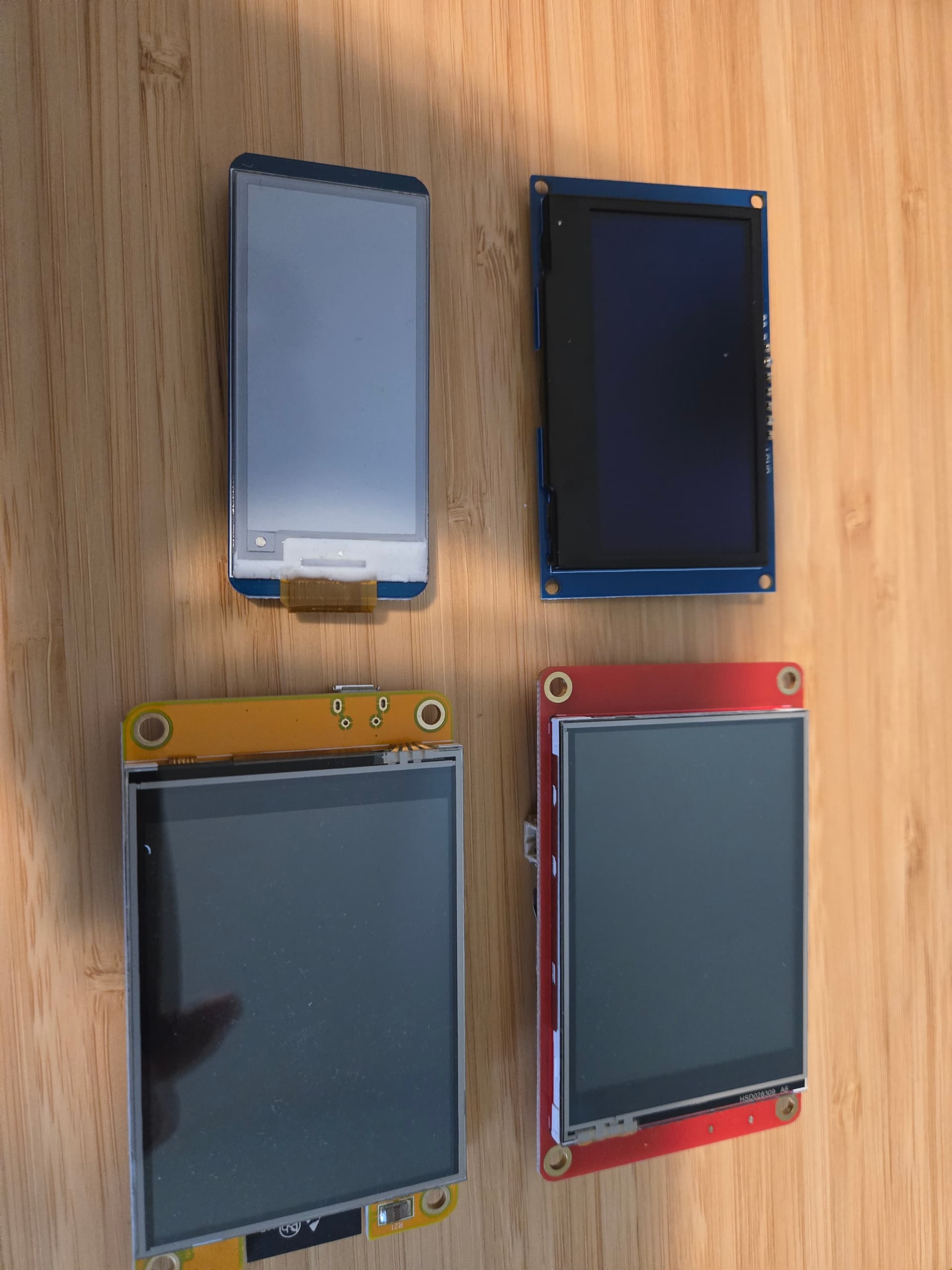

Then there’s the screens I bought for my prior pendant project and ended up not using. I think this is missing one of them. That gets more expensive with bigger screens.
Im not planning using it as a pendant. I would buy you one if we can accord something. I prefer my screens mounted on the tables. A 7inch screen is like one hand of mine. Will take a photo for reference tomorrow

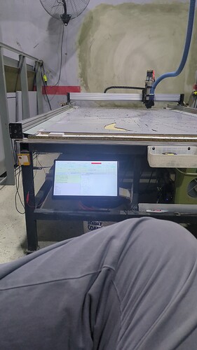

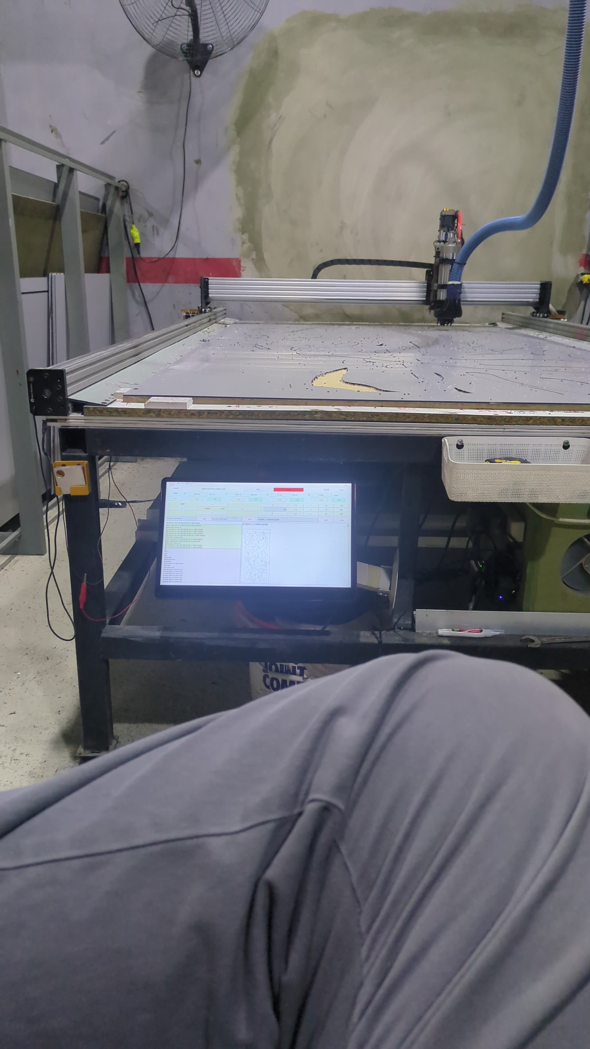

Thats a 15.6” touchscreen on one of the machines, the lr4 is running with a ms surface 3 tablet and the other cnc is running with another surface tablet. Surface 3 are cheaper than the screens alone but would like to make something nicer

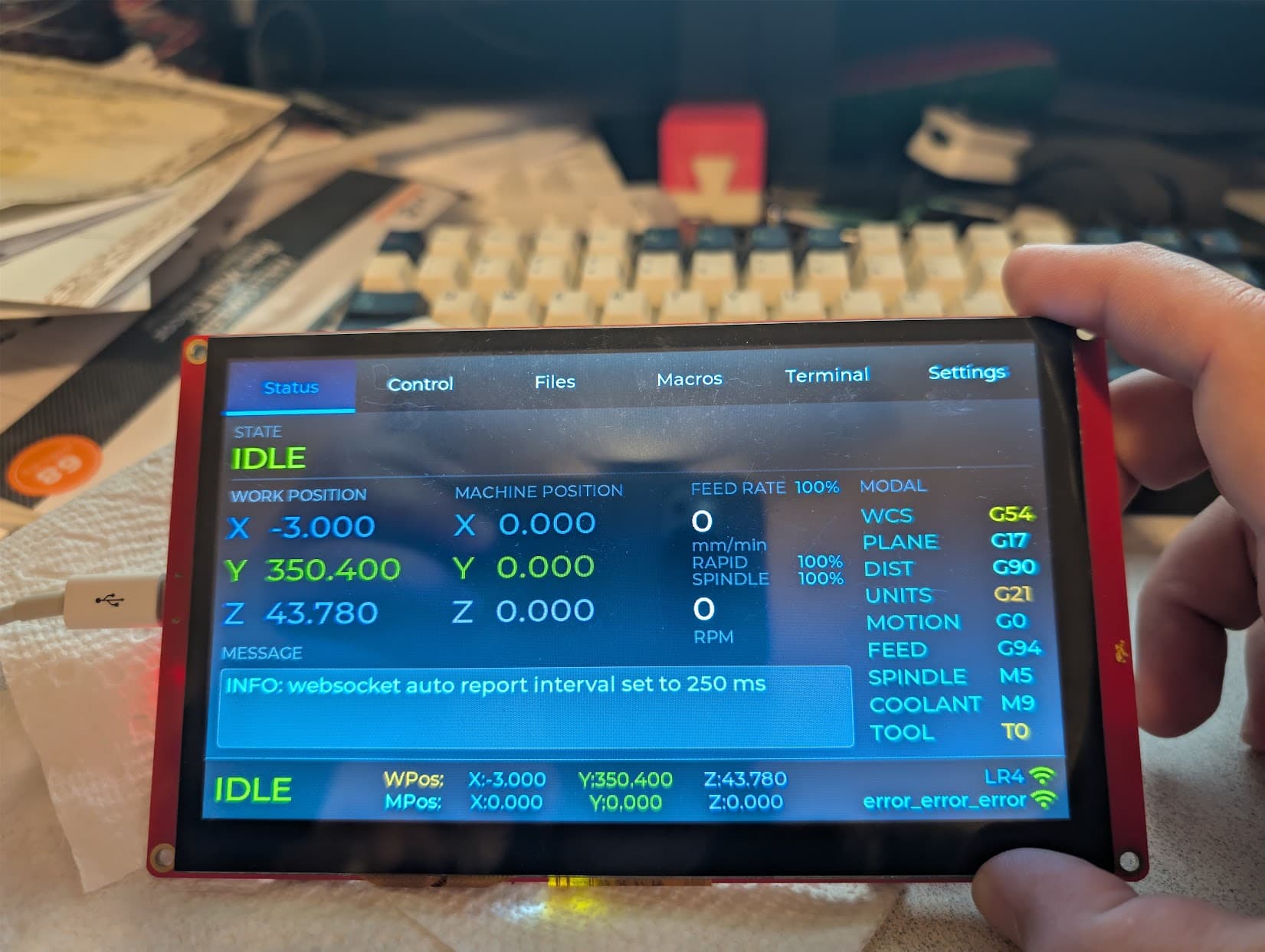

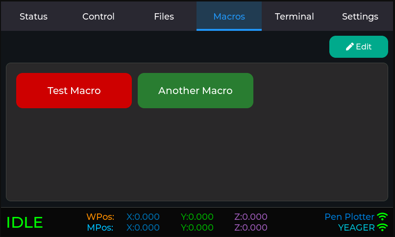

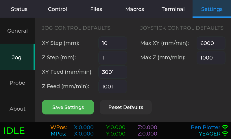

My pendant is now feature complete. I still have to do some testing, optimization, UI tweaking, bugfixing, etc. I’m thrilled with how this is looking.
Some things I’ve added since my last update. I’ve been a bit obsessed with this project.

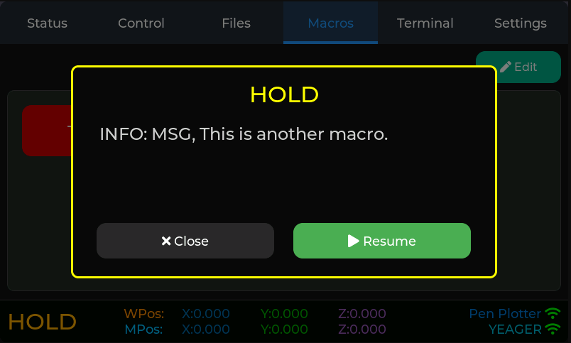

  • Hold popup - when it goes into hold, it displays a popup with the last message and close/resume buttons.
  • Alarm popup - when it goes into alarm, it displays a popup with close/clear alarm buttons. Clear alarm does a soft reset followed by unlock.
  • Joystick jogging
  • Probing - I haven’t tested this.

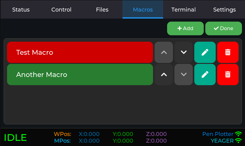

  • Overrides
  • Storing default settings for jog, joystick, and probing.
  • Macros - file based, looks for files on the machine SD under /fluidtouch/macros providing a dropdown to select the file.

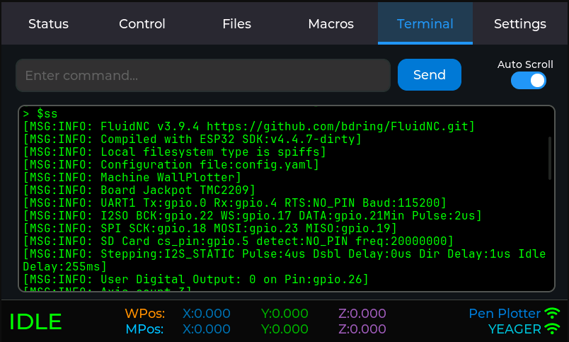

  • Terminal - re-added this, it works fine when you don’t display the status strings which get crazy when running a file
  • Updated machine selection to add a setting to allow you to skip it which makes sense if you are only using it with one machine

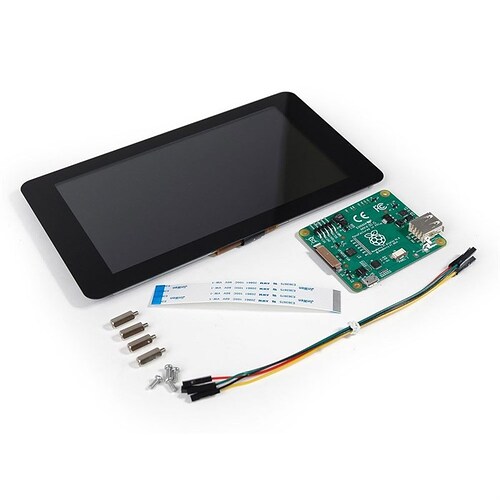

I have a Pi4 with a 7” touchscreen.
What is needed to make this?
I want to be clear that while this is 90-95% done, that last bit can take some time. I’m hoping to get it to a beta status in the next couple weeks. There’s also some documentation to do. While at some point, I hope to look at alternatives, initially installing the firmware will require checking out the git project and uploading via VS Code and PlatformIO.
This requires a FluidNC board like the Jackpot. It uses this specific display. I purchased it with the acrylic case option which seems nice enough. Powering it requires plugging in a USB cable. The acrylic case does have some threaded inserts which could be used to make some kind of 3d printed battery holder. Not sure I’ll get there.
https://www.elecrow.com/esp32-display-7-inch-hmi-display-rgb-tft-lcd-touch-screen-support-lvgl.html
I also ordered this Advanced version of the display. It does not currently support this display. I hope to make it work with this version too but no promises.
https://www.elecrow.com/crowpanel-advance-7-0-hmi-esp32-ai-display-800x480-artificial-intelligent-ips-touch-screen-support-meshtastic-and-arduino-lvgl-micropython.html

A raspberry pi with any touchscreen will work like a regular pc/phone/tablet using the WebUi v2 or V3. Jason project is different, like a pendant (a wireless pendant if you use a screen that supports a battery pack
