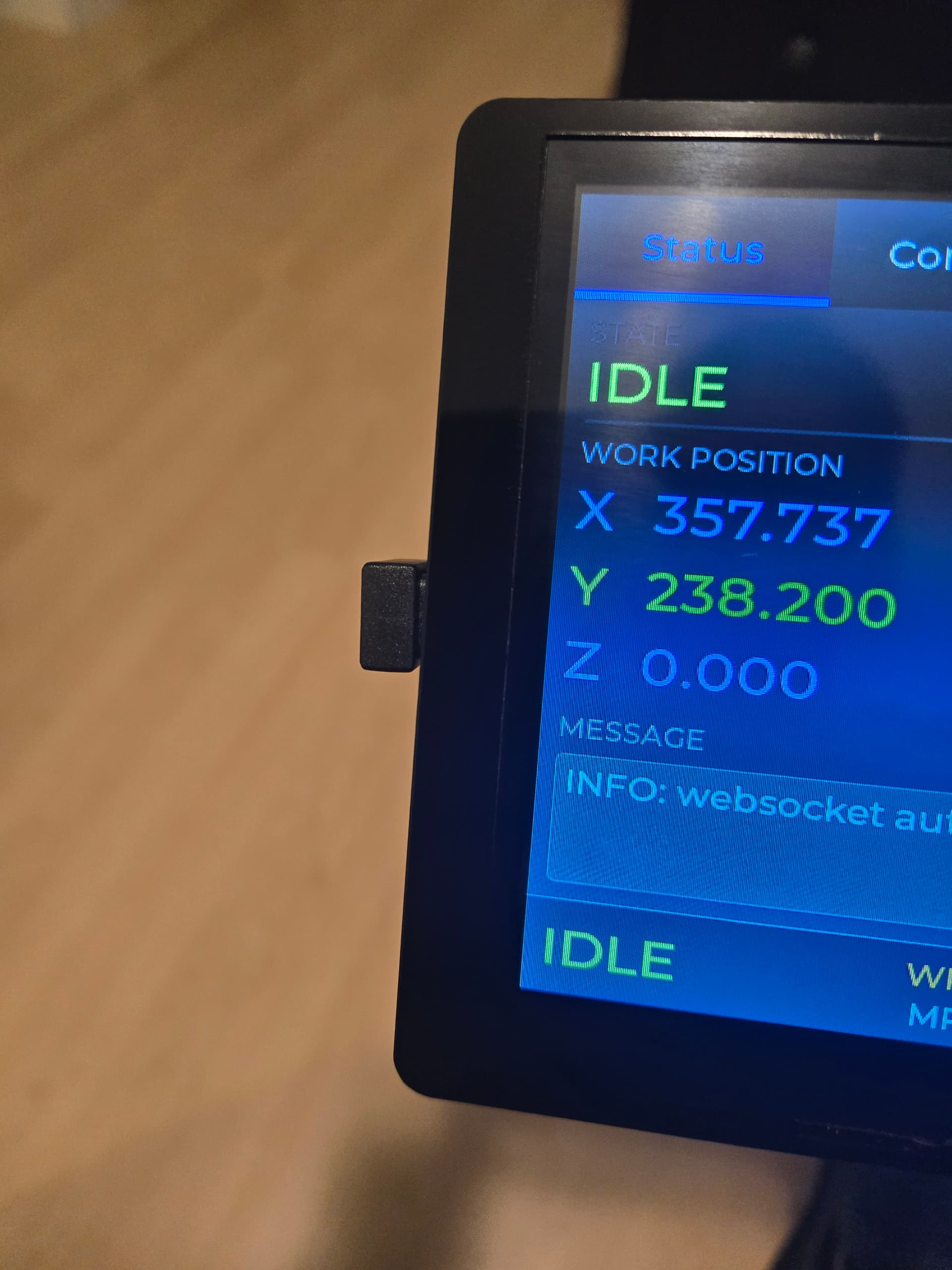

Odd…this morning I tried starting my 7” screen up again powering it off a USB power supply instead of a port on my computer since it was kind of flickering and contrast was pretty lousy so I suspected it might not have enough power off the port. I had run it off the power supply before when testing that it fired up on the stock demo code and it worked fine.
But this morning - nothing. The backlight came on but it didn’t seem to boot. Tried it back on the USB port and no go there either. Tried the reset button and still no go. Didn’t have time to mess with it further.
Then over lunch I plugged it in again…and this time it booted right up and worked fine. Very odd. Not sure why it was doing that. Curious to see if it does it again.

Yeah, I’m assuming it was a fluke…like when my CYD fluiddial did the same thing - and just refused to boot one day…and had me thinking it had fried. But then a few days later when I went to debug it it was working fine.

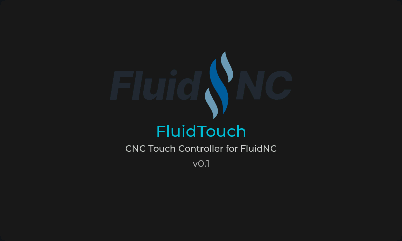

Also, got the ok from Bart to call this FluidTouch and use the FluidNC logo in the splash screen.

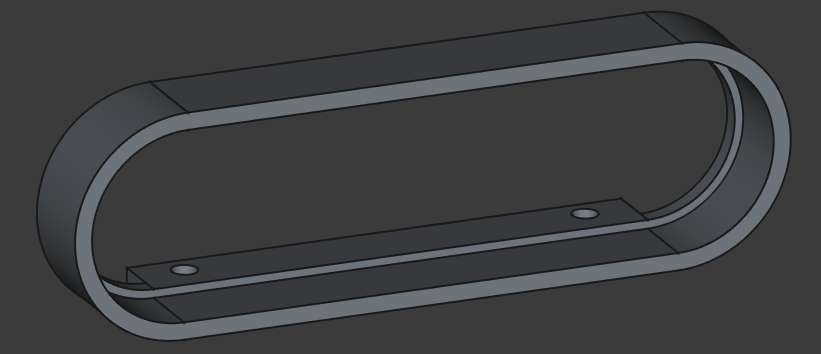

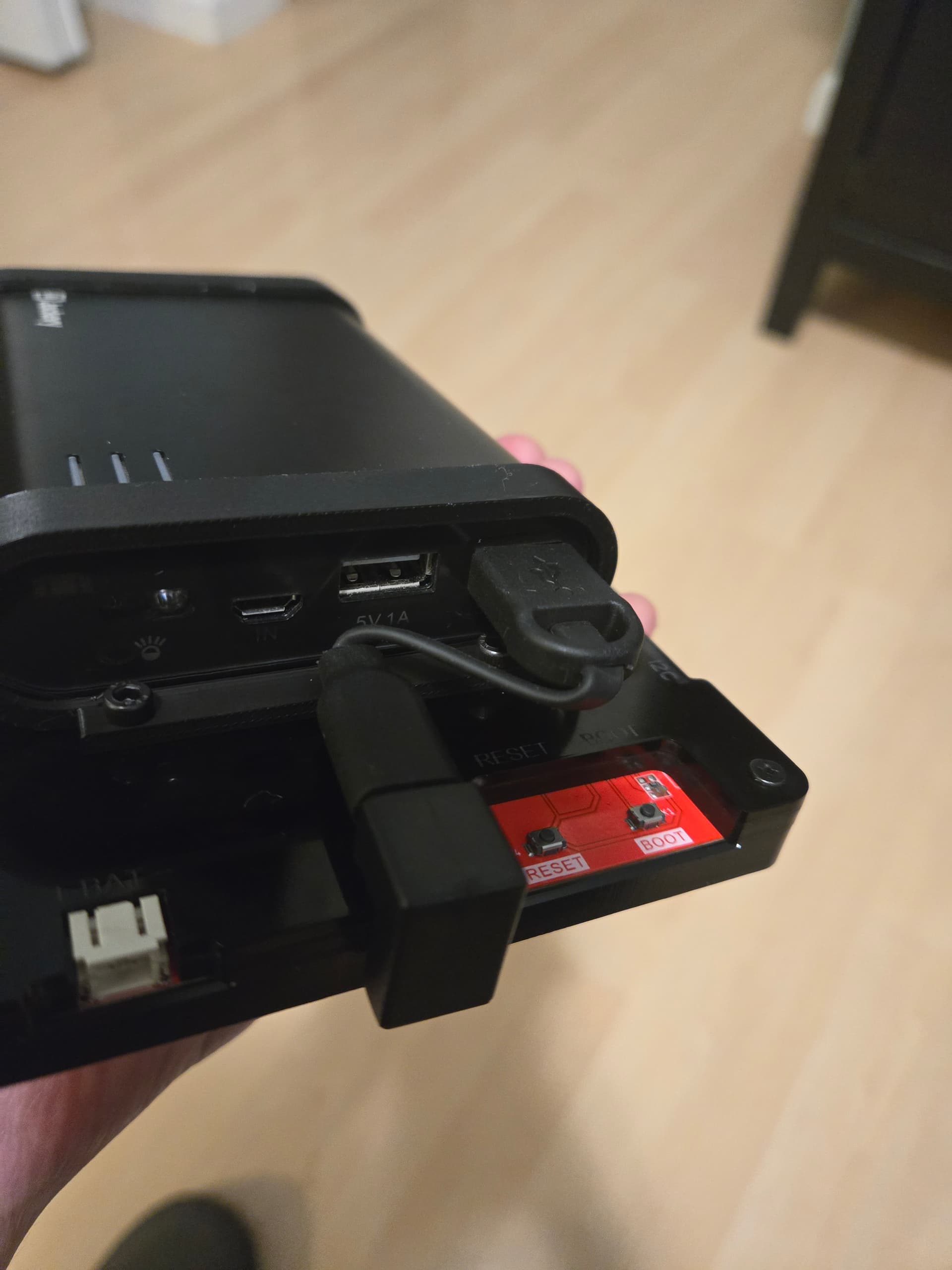

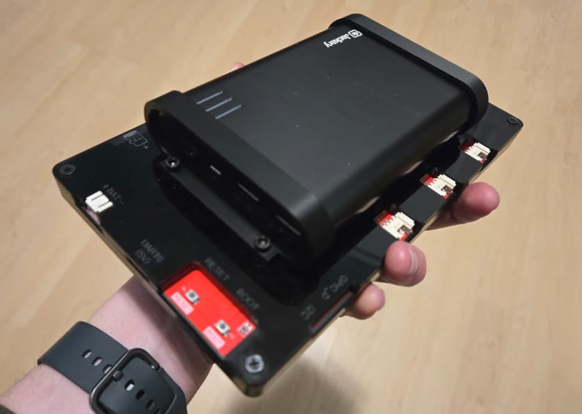

Didn’t do much with this today. Except I did make some brackets to mount the USB battery pack I have. The acrylic case you can get with it has M3 threaded inserts. Now I just have to order a short USB cable because somehow I don’t have a short USB-A to USB-C cable in my giant box of cables.

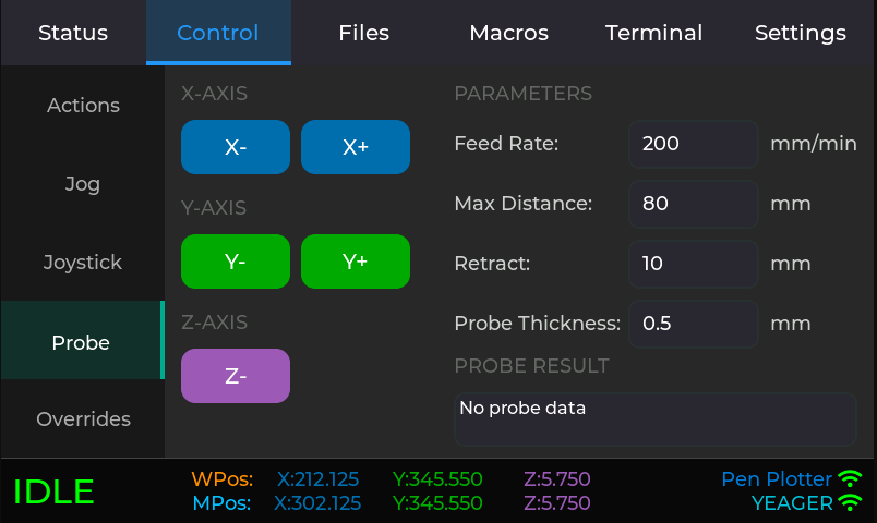

Curious what the thoughts are on this version of the Probe tab. I implemented it for completeness even though I always probe in gcode.
While you’d typically just use it to probe Z, you could technically use it to probe any corner with a touch plate (or corner block). You’d just jog to a good location, probe an axis, manual jog, probe, manual jog, probe. I suppose for X/Y probing you’d need to update the probe thickness to add 1/2 of the bit thickness.
I originally had a Z+ probing option, but that makes no sense. Maybe if it did a G38.4 (probe away, stop on loss of contact) instead of G38.2 but I wouldn’t bother with that.

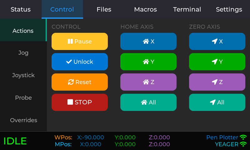

Does the jog screen have a way to zero each axis - I couldn’t see one in post 185 but I may have missed it.
This is on a separate tab.

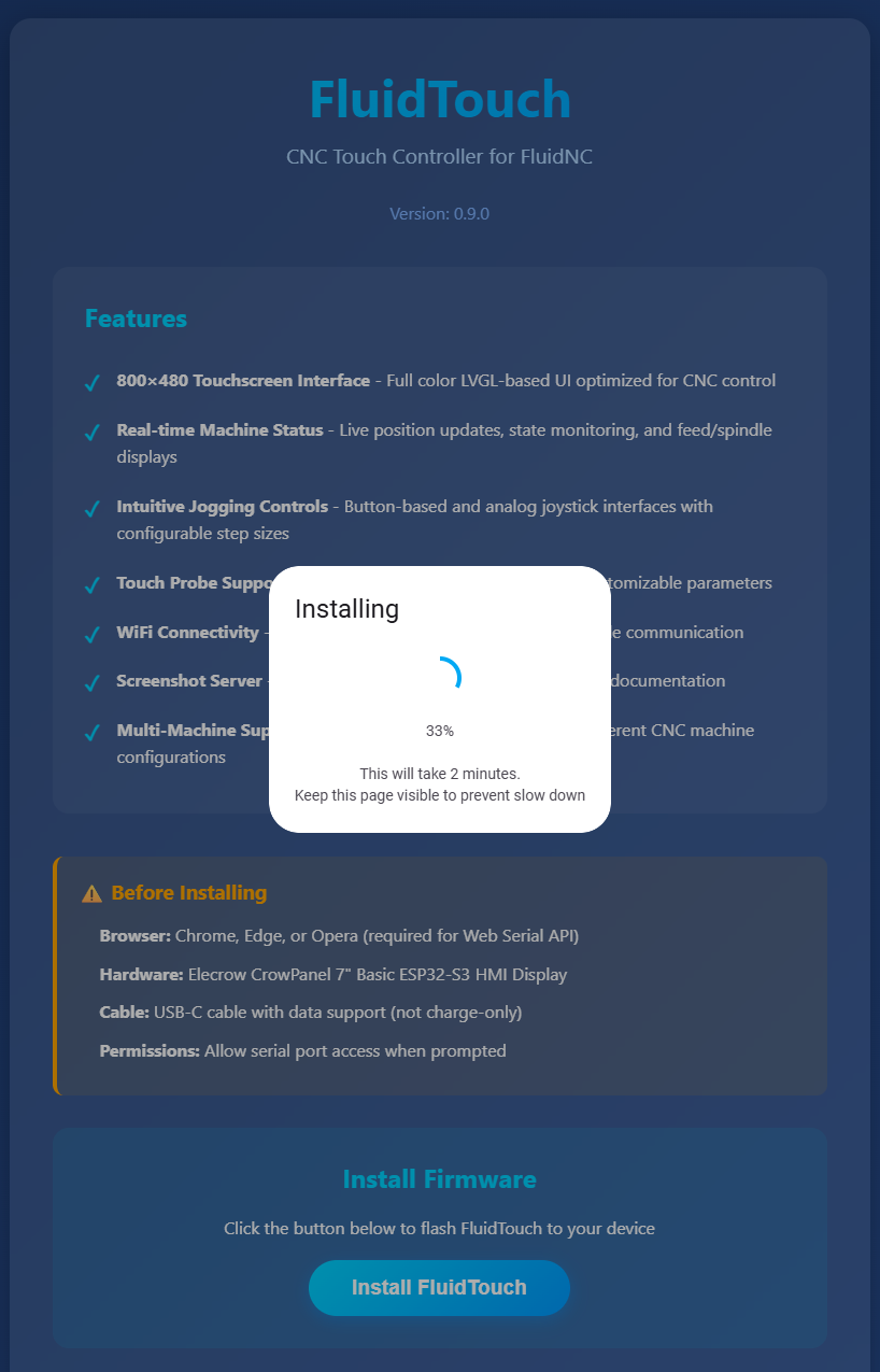

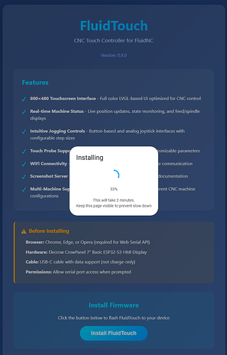

Cleaned up some more things, generated some documentation, captured a bunch of screenshots, and even had my good friend Claude setup a Github action to build it and create a web installer!
The generated documentation is a good start. I do have to review and update some of it.
So, there’s a 0.9.0 release out there now.

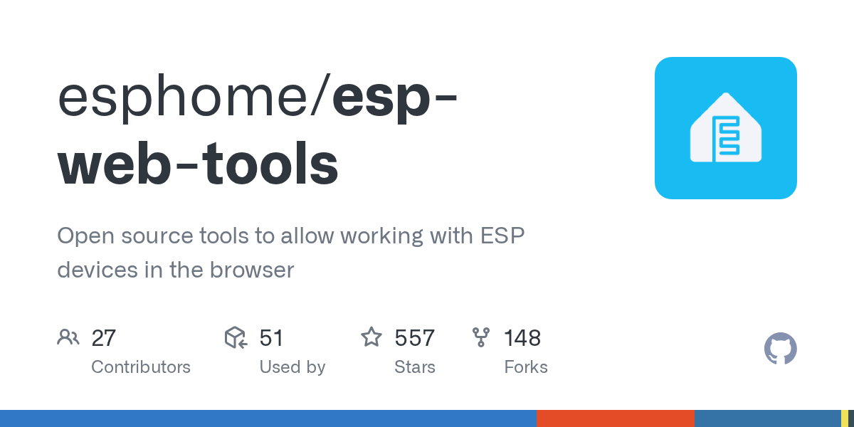

That process was greatly simplified by the ESP Web Tools project.

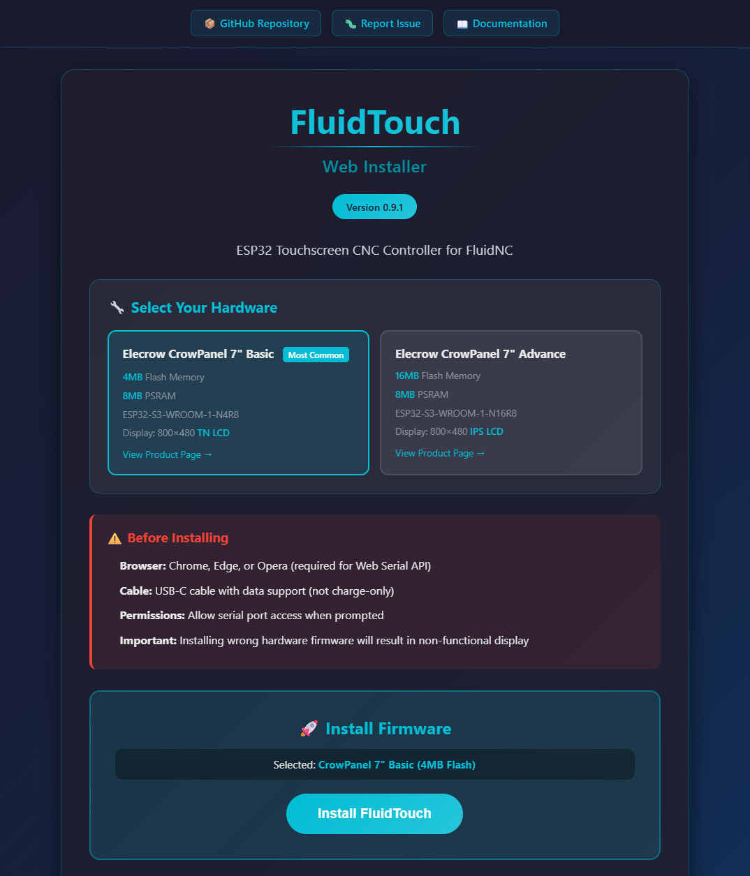

Crazy week at work so probably won’t get to work on this much until the weekend. I’m itching to get a 1.0.0 release out soon. I put a 0.9.1 build out with some more fixes and polishing. I don’t think I’m aware of anything left that I need to fix.
I should have the advanced version of the display this week. I did some research and it seems feasible to support both displays. While this one has much more memory and some other features, I’m mainly curious of display quality since it’s an IPS panel vs a TN panel. The only extra feature I’m planning to support just for this display is adjustable brightness which the other one can’t do.
Barely long enough but I guess that will work.
