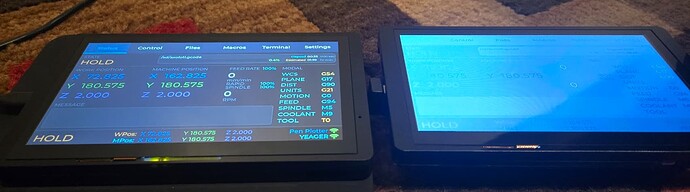

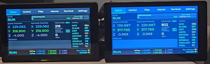

Well, that was a pain but it’s generally working now on the Advance version of the display. I still have some work to do.

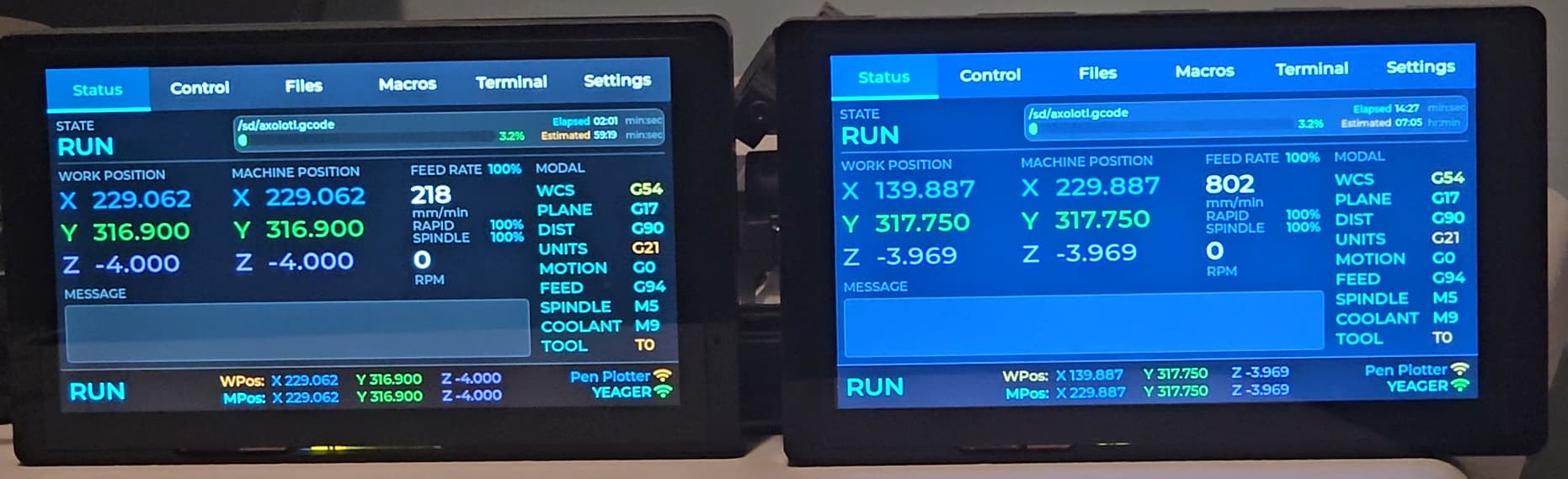

It’s hard to tell in pictures but the display on the Advance screen (left) definitely looks better and has better viewing angles. Is it worth the extra $10? For my initial thoughts, I could go either way. It has other features and some things I like but not using any of them for this project anyway.
No, you can’t run two at the same time on the same machine very well. It only works at all if at least one is in manual polling fallback mode. The X work position is way off because it has a 90mm offset that it didn’t pick up since it was in RUN mode when it started.

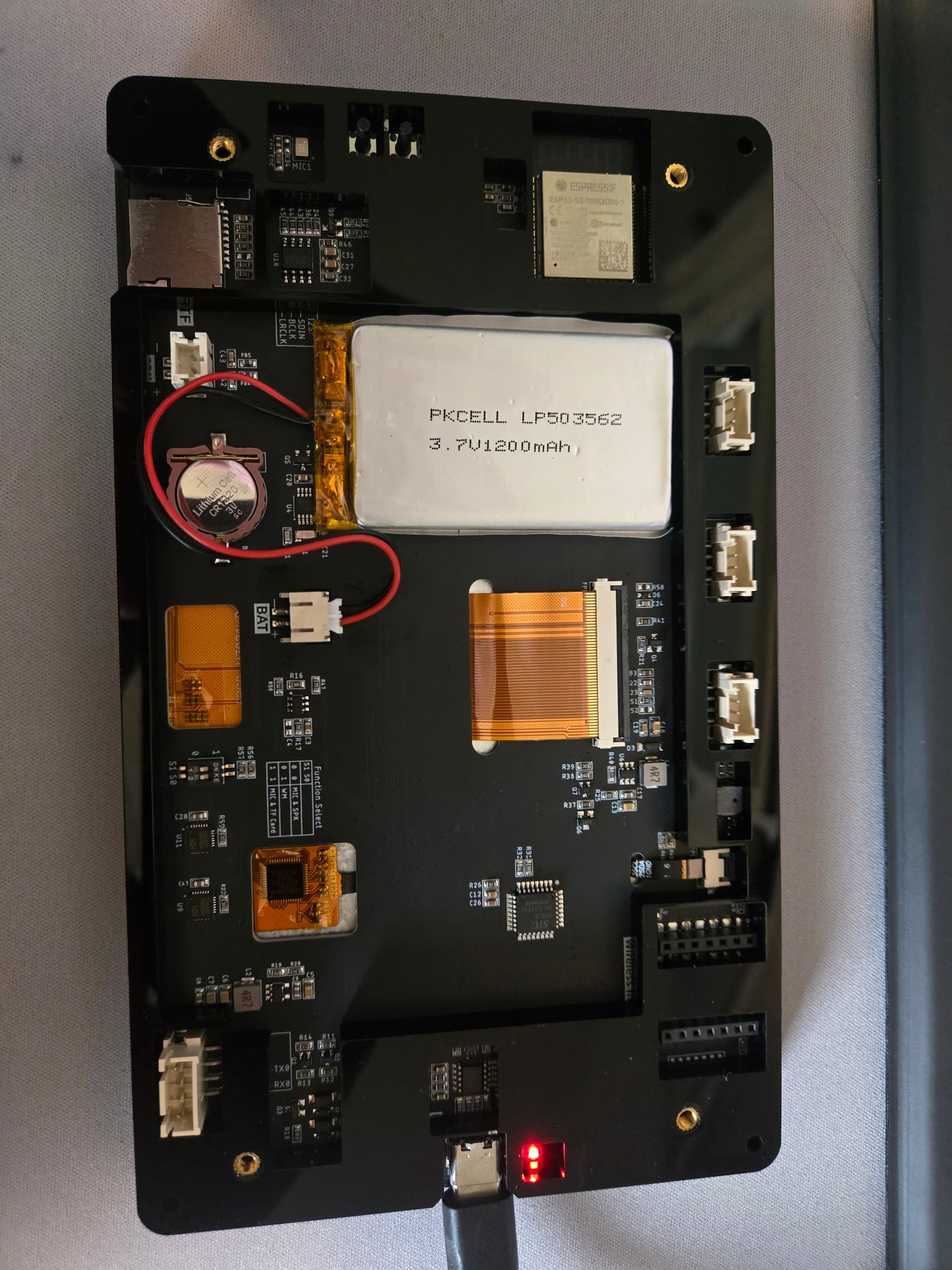

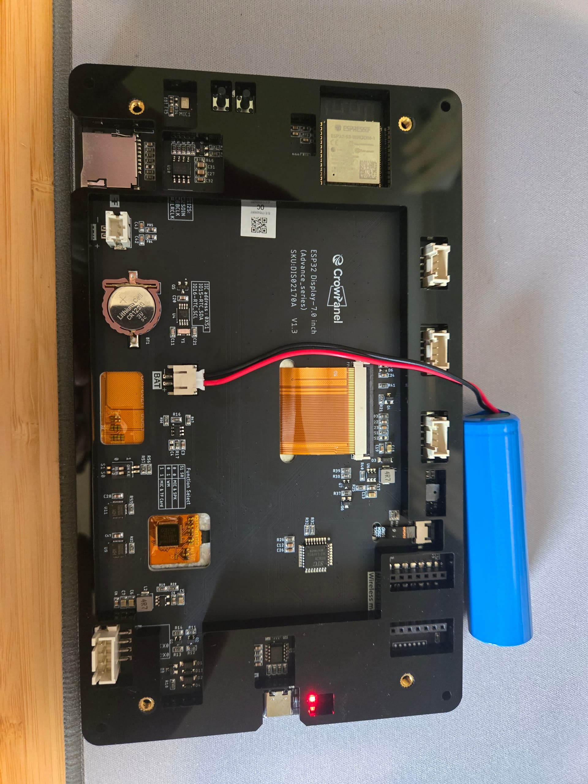

Hmm, intriguing thing about the advance display is that the battery connector was moved internal and the acrylic case has space inside for a battery.
Note: I had to swap the connections on the battery because the polarity didn’t match the label on the board.

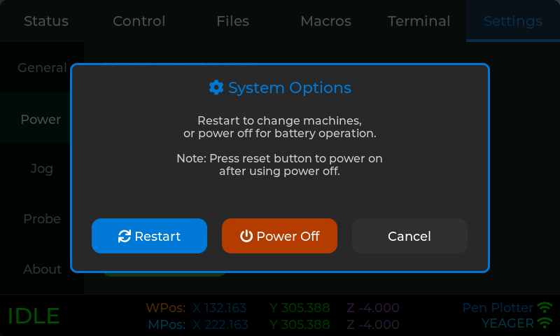

There’s no switch but I could put an option to put it in deep sleep. You could turn it back on with the reset button.
Ooh found a battery.
Well, the whole battery thing sent me on a detour but it was worthwhile. Before, I had it hooked up to a 10,000 mah battery (which was way larger, and heavier, than necessary). Now, on the advance, I have a 1200 mah battery inside the acrylic case. That is really nice. That means I’m much more aware of power usage. I haven’t meaningfully tested how long that will last. Although, even if I normally keep it connected to USB for power (which also charges the battery), being able to use it untethered at times will be handy.
So, there are now configuration options set the amount of time until dimming the display, going into light sleep (screen and backlight off but still maintaining WiFi and FluidNC connection - touch screen to awake), and deep sleep where it’s no longer displaying or connected to anything and only using a tiny amount of power. Getting out of deep sleep requires clicking the reset button. This only applies when disconnected or in a state of IDLE so it you can still see what’s going on while it’s actively doing something.

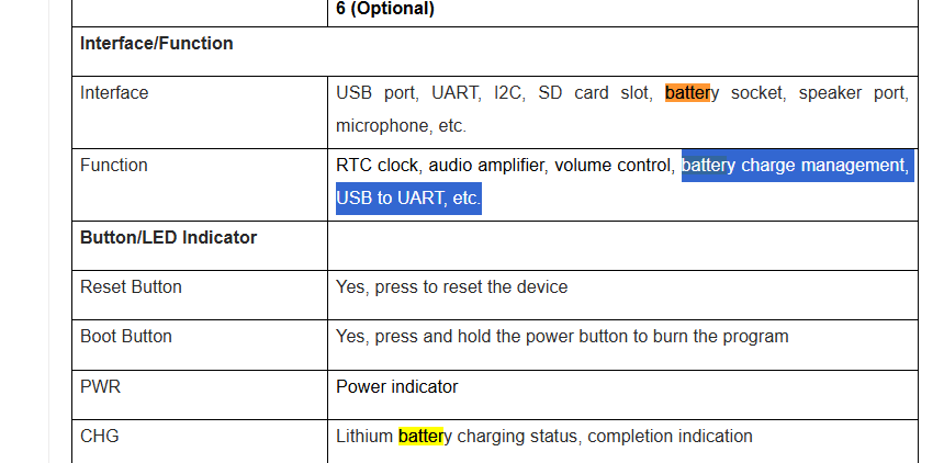

Looks like the board has battery management on board? Have been curious whether existing or adding pogo/magnetic connectors could enable charging without fiddling with USB cables when your pendant is docked on a Peter Plate mount?
https://www.elecrow.com/crowpanel-advance-7-0-hmi-esp32-ai-display-800x480-artificial-intelligent-ips-touch-screen-support-meshtastic-and-arduino-lvgl-micropython.html
It will charge the battery from USB and has an LED showing green/red for charged vs charging. Unfortunately, it can’t monitor the battery level without extra circuitry. The battery I am using has it’s own protection circuitry to prevent over charging/discharging.

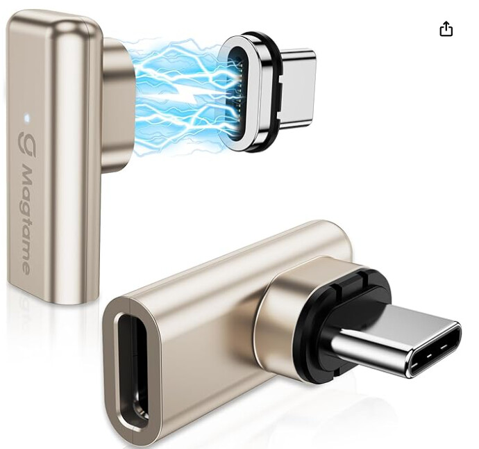

I was literally looking at magnetic USB adapters when you replied. I would actually prefer to dock it on the table instead of the LowRider. Looking for something I can mount in an angled 3D printed mount on the front of my table.
Ooohh, magnetic USB connector😋.

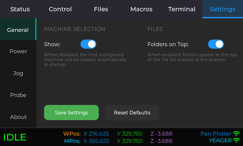

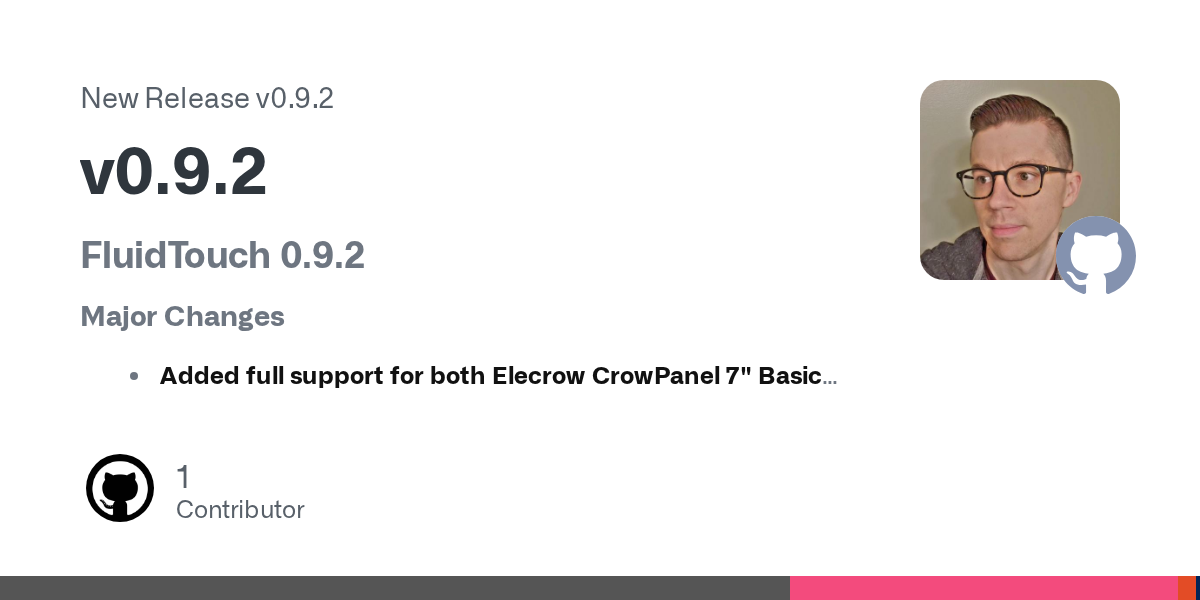

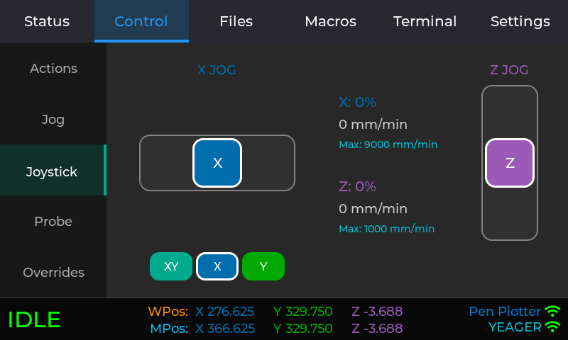

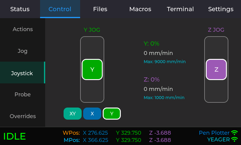

Put out an 0.9.4 release with:
  • Joystick Axis Selection: Added XY/X/Y mode buttons for independent axis jogging with visual selection indicators and dynamic color-coded labels
  • Folders on Top Setting: New toggle in Settings → General to show folders first in Files tab (SD card browser)
  • Performance Improvements: Machine configuration caching and deep sleep optimizations
  • Better Connection Handling: Reconnect attempts now stop after disconnect dialog is displayed
Battery usage in deep sleep is more than I like. I’m not sure how much I trust the USB power monitor thing I have but it’s showing 0.05 amps (50 mA) in deep sleep. While that’s only a 1/4 watt, that’s too much for leaving it connected to just a battery for any significant period of time. I hope to create a dock with a magnetic USB connection where it will normally live. But, I can pull it off the dock when I need to.

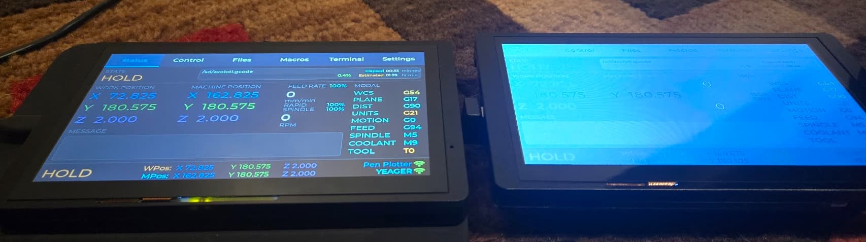

Note: Struggled for a bit with weird behavior (like the screen still functioning but everything was more green). Turns out there are some dipswitches on the advance that needed to be toggled for configuration between microphone/speaker/external wireless card/SD card.

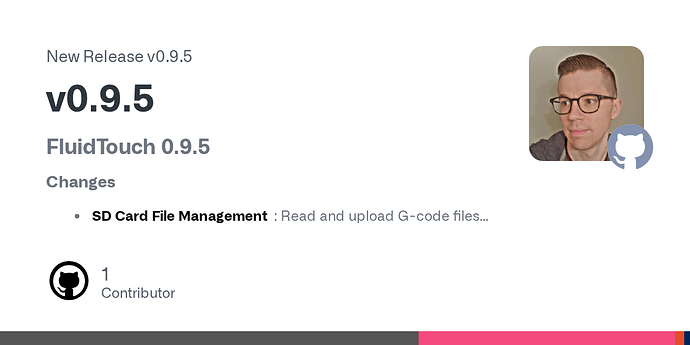

Put out a new release with display SD card support, documentation updates, and some other cleanup. This is basically 1.0 if I don’t run into any testing issues.
