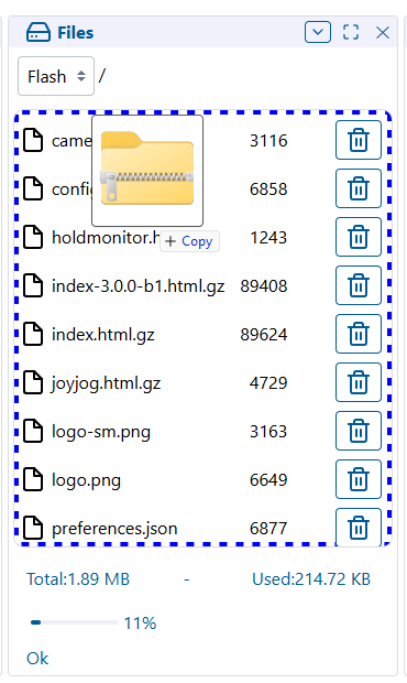

I was able to unzip it and upload it on my Macbook. I ran 2 laser jobs with no issues.
@vicious1 do you have v3 on the Jackpot or v2? Maybe v2 doesn’t recognize the .gz?
Took another look and figured it out. After it extracted it had it’s original date of Jun 2nd - I just wasn’t looking far enough down the list to see it :man_facepalming: It’s always the simplest things!
Got it uploaded - difference is subtle but I noticed some fonts changed and my macro button is bigger. Nothing has gone wrong yet though :+1:
Ah, that makes sense.
I actually never use the Upload button, I just drag and drop:
I didn’t change any fonts, but I did change the formatting of the macro buttons so they have some sense of alignment and are bigger so they’re easier to tap on a touchscreen.
:open_mouth: Learn something new everyday…
And I almost never drag and drop because I’ve been burned too many times thinking I could somewhere only to have the window reload what I was dropping instead and losing what I had been working on :rofl:
But to each his own…my boss LOVES drag and drop - I’ve just never been a huge fan.
I wasn’t sure if I saw a font change or not…just looked like somethings got a little bolder…but it could have been my imagination as I was looking for something that was different. The macro button definitely did change - in a good way :+1:
The only time this got me is when I was trying to drag and drop from the file list in Visual Studio Code. It looks like you can, but it doesn’t work.

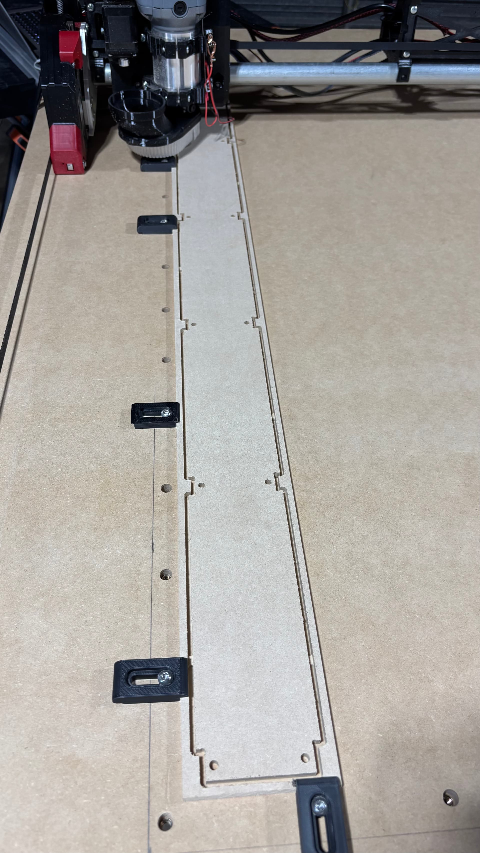

I cut out my strut plates using MillMage and webuiv3 and didn’t have any issues.

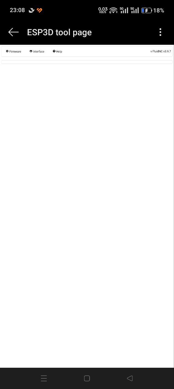

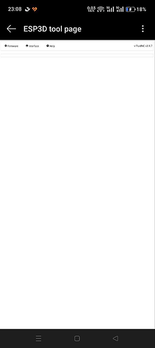

Hello, I am a student and I am researching to make a cnc machine for my report, currently I am having problems with the web UI, I have loaded the index and yaml files but the web is still blank like this, what should I do now :((
Chuan, Welcome. Please start a new topic about your issues. This thread is about an upcoming release.
