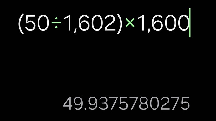

Thanks for adding the option to choose the step size Mike. I have one further question. When I am trying to set the step size on my tablet the screen does not scroll all the way down to the save option. I can however log on with my pc and see the whole screen. Did I miss a setup option? I also noticed a limit when you enter corrections for steps (trying to tram my lowrider). I am off 2 mm over 1600mm but it appears to truncate after 3 decimal places but that is missing a decimal place after 1600mm for fixing 2mm (1/16") . Is this something I just need to set in the html file when I transfer over. I apologies I am still trying to figure out the fluidnc thing.

I’m assuming you are setting your pulloff values for Y squaring. I don’t understand why you need more than 3 decimal places? 0.001 mm is far more accuracy than you need (or can measure).
Thanks Jason I thought I had the latest, will try update again this evening and test. My tablet is a samsung 2014/2015 tablet running chrome. I will let you know after the update. I never thought of using the pulloff for fixing when it got the length wrong, I thought that was just for off square. I just use the steps per mm, it was at 50 but that took me over 1602mm and and a bit so reduced it. When you go to 2400mm (4x8 build) it starts stacking. Why I asked about extra decimals was I just divided 2.x mm/1600mm and found that I needed a bit more than 3 decimal places.

If 50 steps per mm gets you 1602 instead of 1600, I would think 49.938 is close enough. Even 49.94 is probably close enough.
