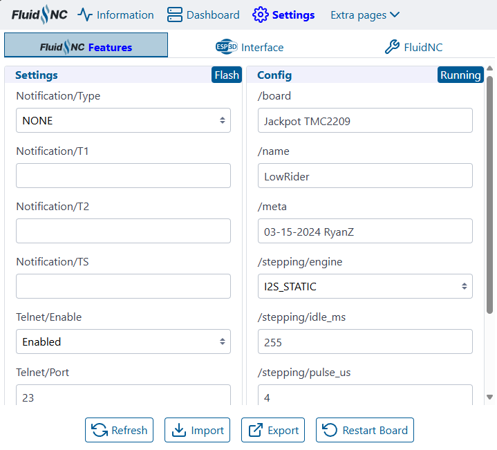

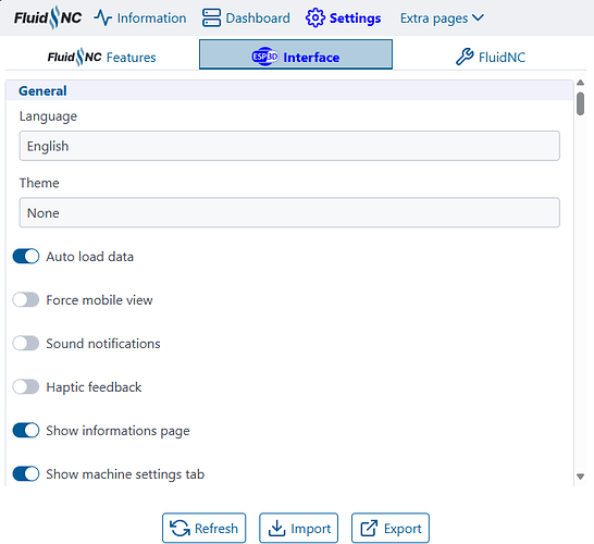

The bottom row of buttons will always be displayed. Not always showing the “Save” button.
I got sick of having to scroll all the way to the bottom to get to the buttons when I just changed something simple at the top

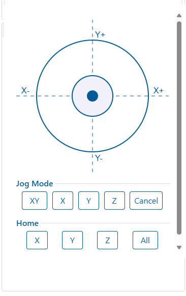

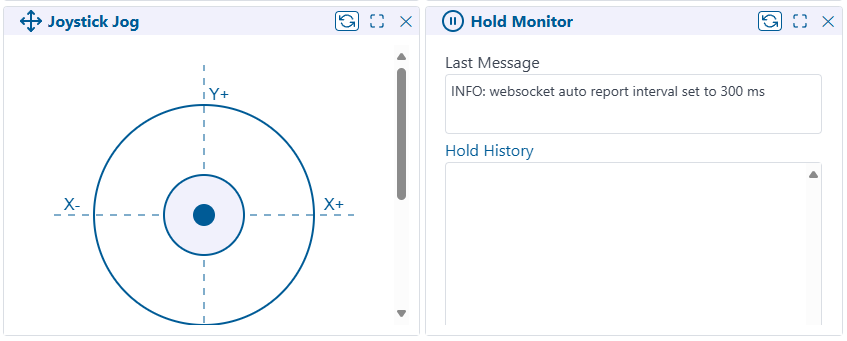

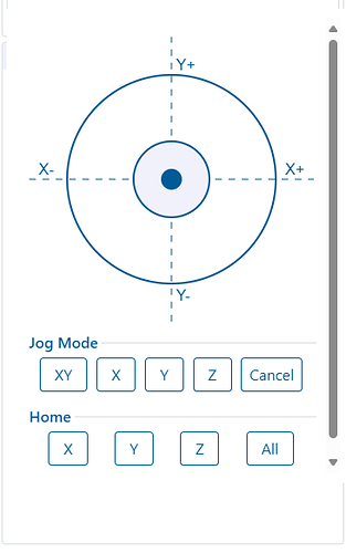

Yea, I don’t like this. I fixed the issue with my HoldMonitor extension, but extension height was already a pain to deal with because they’re rendered in an iframe. I’m having trouble getting the scrollbar to go away on my JoyJog extension. I can probably hide the scrollbar, but I feel like this is going to cause grief on extensions in general.

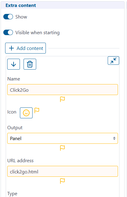

I went to test out Luc’s Click2Go extension, and I couldn’t since the scrollbars are hidden.

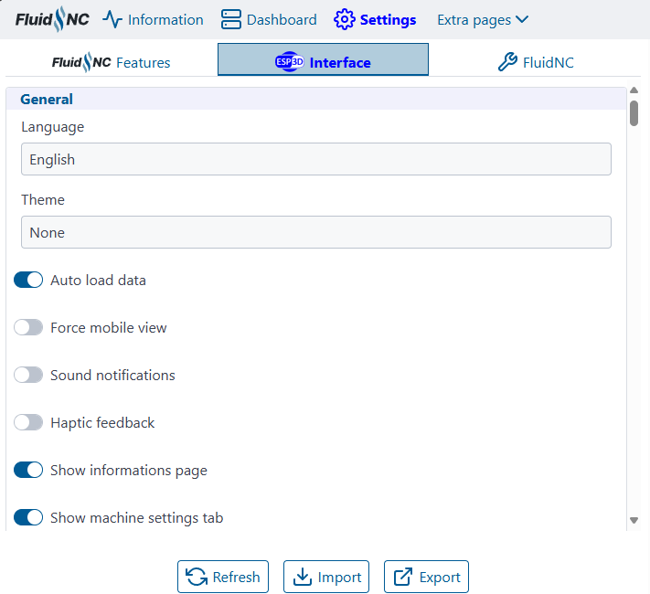

The panels not scrolling on the Settings page is an issue though unrelated to extensions/themes. I’m guessing that came about with your pinning the buttons to the bottom changes.

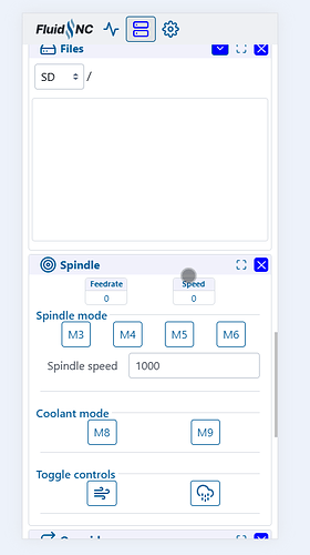

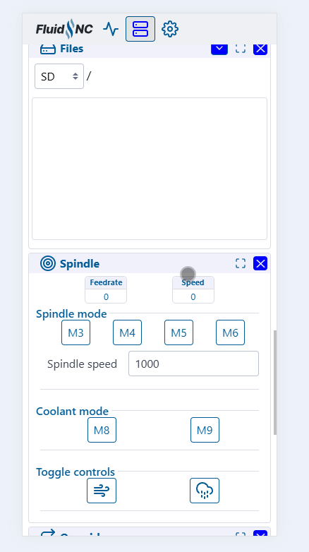

Interesting. Unfortunately, I don’t own any Apple products to figure this out. Hmm, I guess I may have access to an iPad. I know that one of the changes Luc made awhile ago so extensions stayed loaded when changing tabs causes some strange things. Like sometimes before I scroll or resize the page, the headers are cut off. As soon as I scroll, it’s fine:

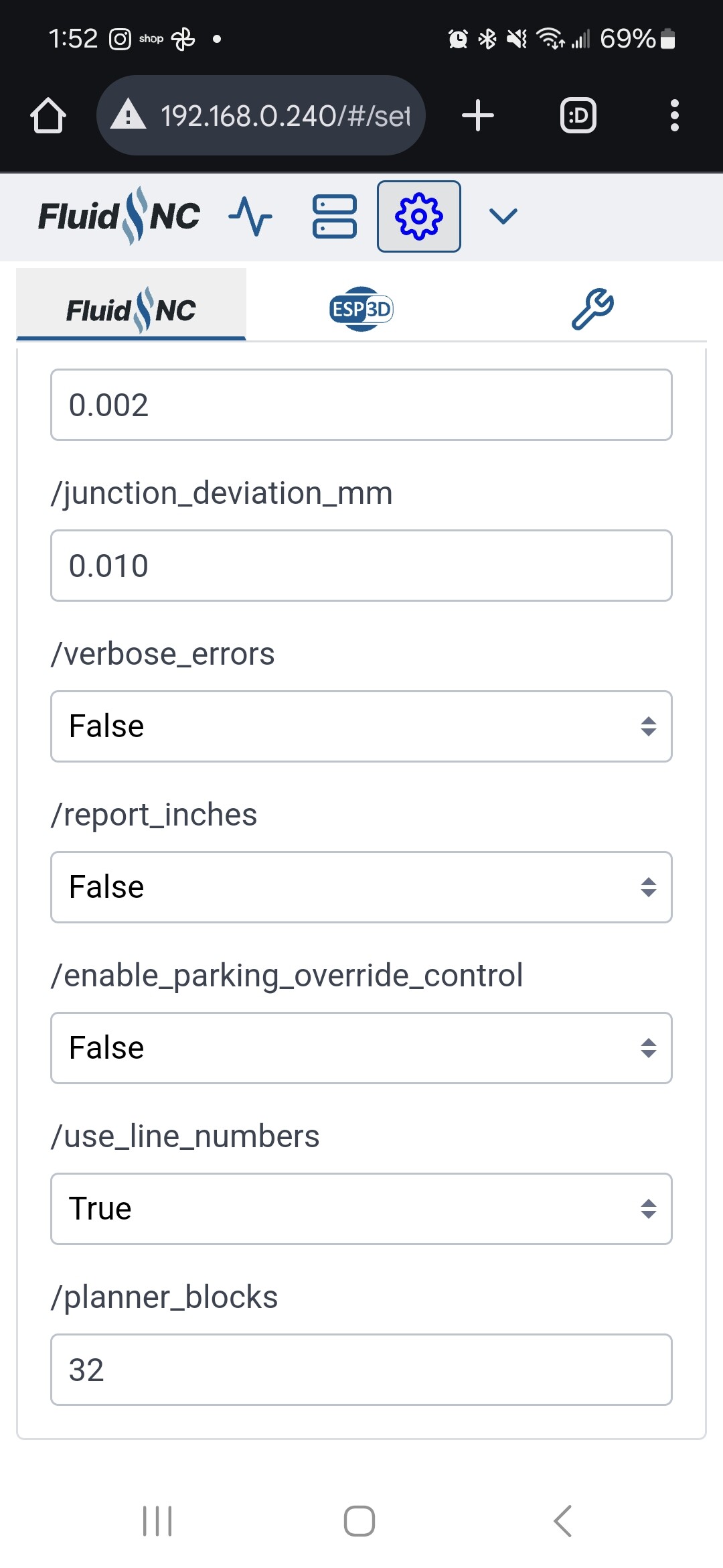

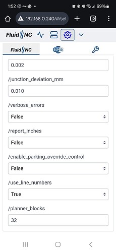

Well, I can scroll now but there’s an interesting collection of scrollbars. Also, I can’t see the buttons at all on mobile.
Makes panel extensions smaller… Note it’s only like that if the extensions are on their own line. Otherwise, they pick up the height from their built-in neighbors.

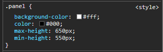

Playing in devtools, it looks like it just needs a min-height on the panel class to be 550px, it’s currently 300px.
My theme allows for the other panels to be smaller, but I’m basically overriding it based on ID for each of the existing panels. The extension panels have to be a fixed size (although going larger is fine) since they can’t resize based on content.

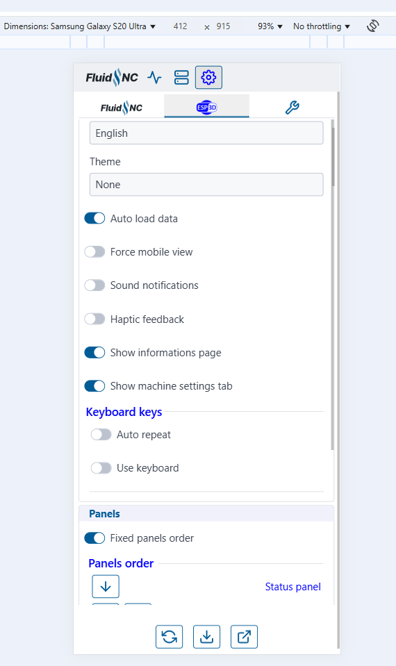

What device are you on?

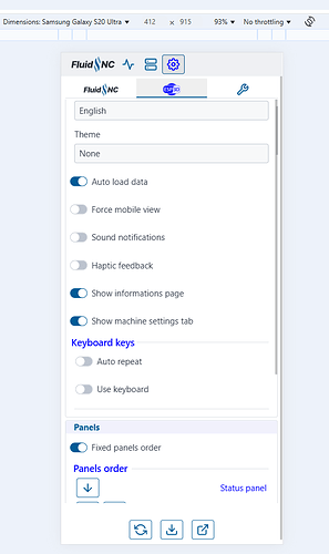

I don’t see that here at all on any of the device emulators
This is on the Settings tab.
Samsung S24 using Chrome. This is scrolled all the way to the bottom.
Strange.
S20 Ultra emulator in Chrome
