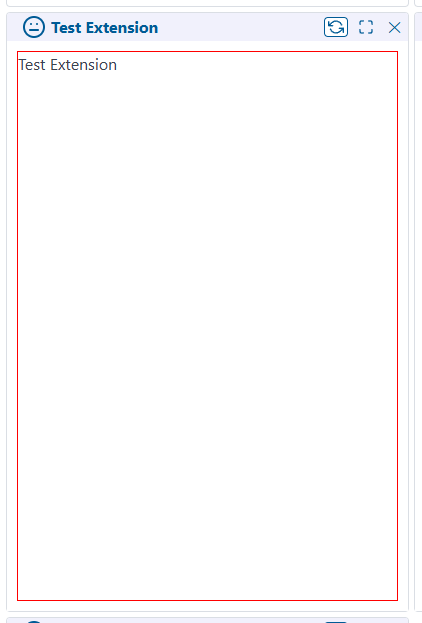

  • There was a previous change to handle expanding the jog panel when extra axes were used. I undid that and changed it so that it can shrink (which it did before) and not interfere with extensions. But it goes further, more similar to how my theme works. Most panels are fine to shrink all the way to the content, except I gave the terminal a 300px minimum height.
  • I changed the formatting of the macros to be like my theme. The button were unorganized and too close together to use conveniently from a touch device.
  • Fixed the extension formatting issue where it wasn’t using the full width and not resizing properly. Also, it had issues when loading the page. If a panel like the Jog panel was above extensions, when it picked up the config, it resized and overlayed the extension panels. This took awhile to figure out.

Ok, sounds good. I have another minor change so the extension panels don’t use the full size needed for the jog panel with XYZABC axes enabled unless it needs to.

I also increased the panel margin a bit as a workaround to not being able to scroll over extensions because they’re in an iframe.

  • Extension panels don’t use the full size needed for the jog panel with XYZABC axes enabled unless it needs to.
