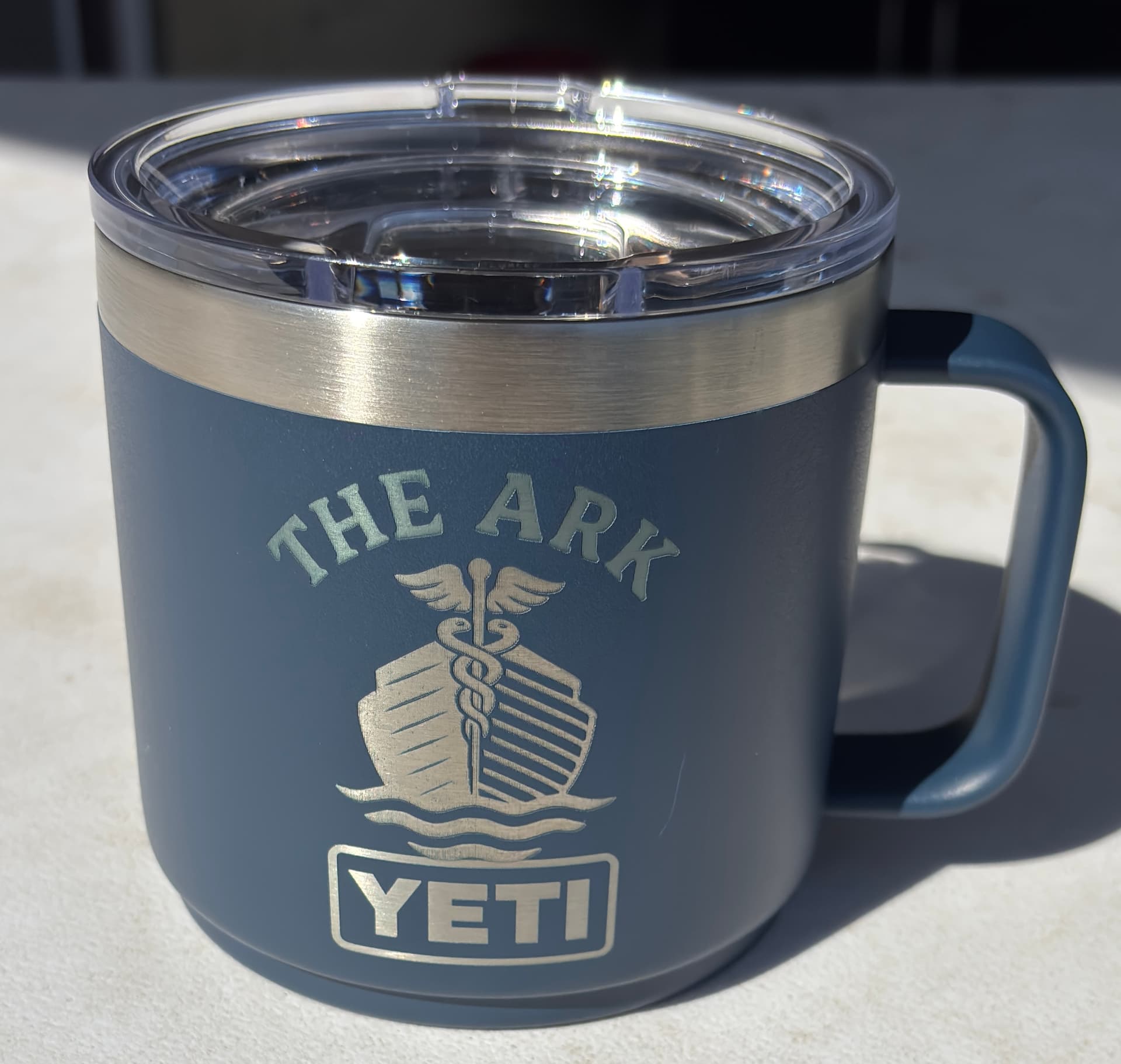

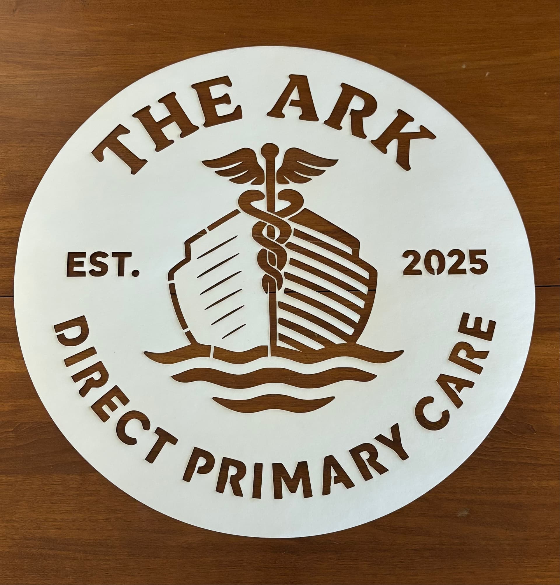

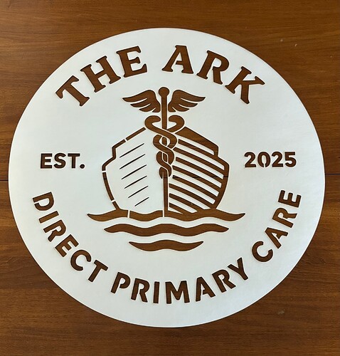

No I haven’t. I have been using Michael’s. I’ll try it on the next project. I’ve been doing a lot of laser work lately. My son in law is starting his new practice. I’m working on a sign for him.

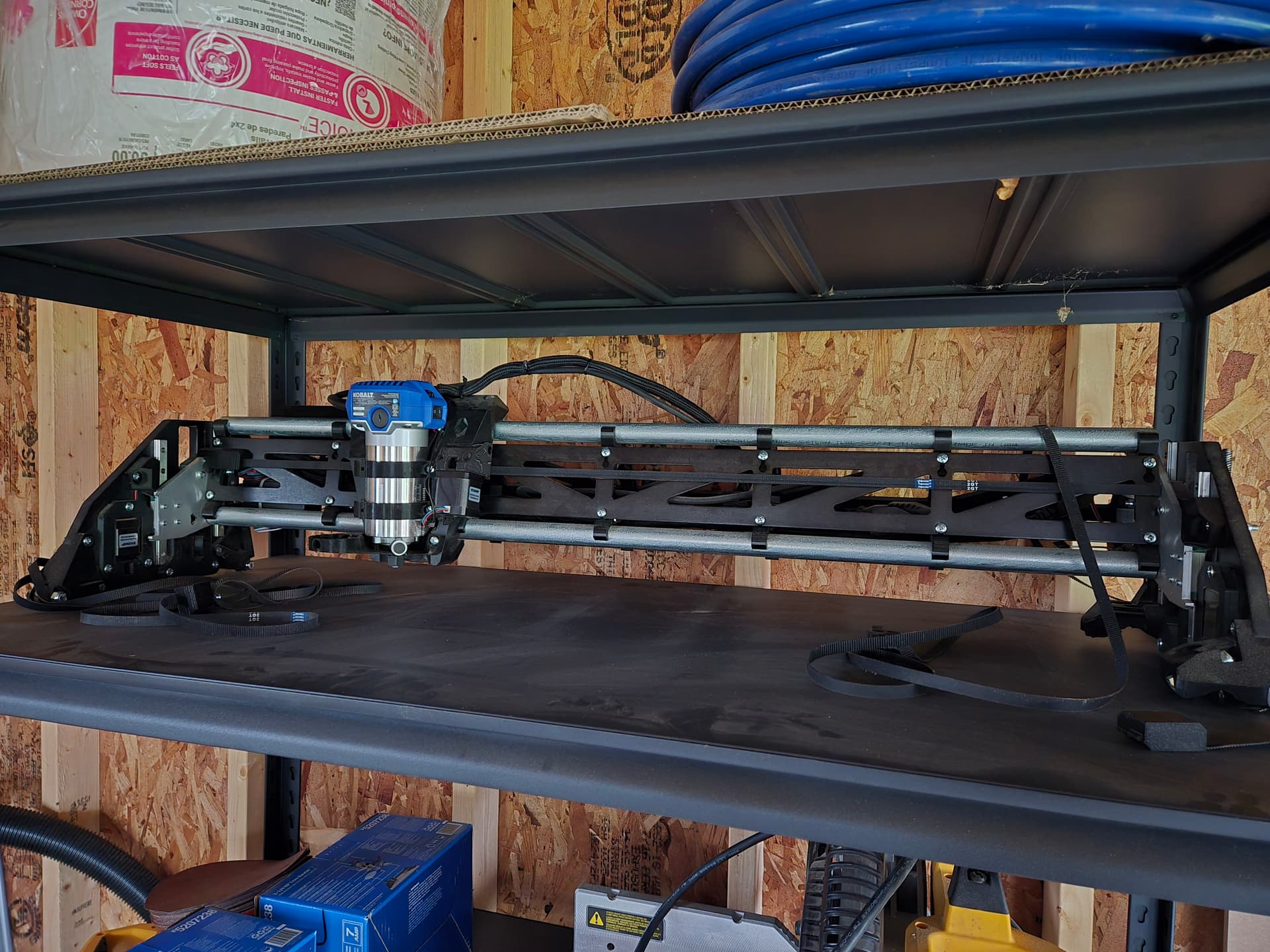

My LR3 is temporarily on a shelf until I get the table moved to my workshop but I can check on my pen plotter. I forgot how easy it is to take off.
