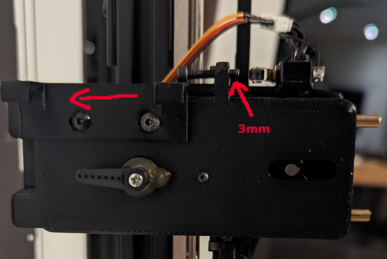

Set the Z-Axis adjustment screw so you have about 3mm showing on the end. Then position the Pen Holder Bracket (part R) so it is all the way down. To do that, loosen the two M3 button head bolts that hold it on and slide it toward the drawing surface as far as it will go, then tighten the bolts. Be sure the bracket sits perfectly flat on the slider’s face, and tighten the button heads so they are all the way in.

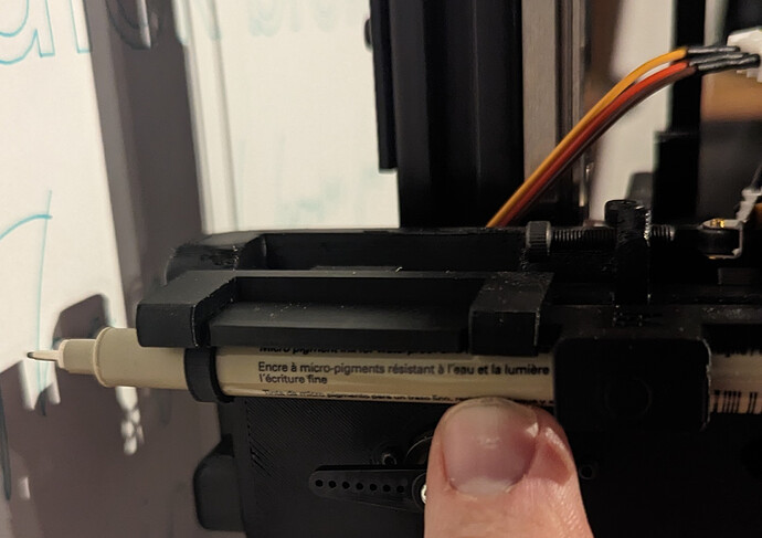

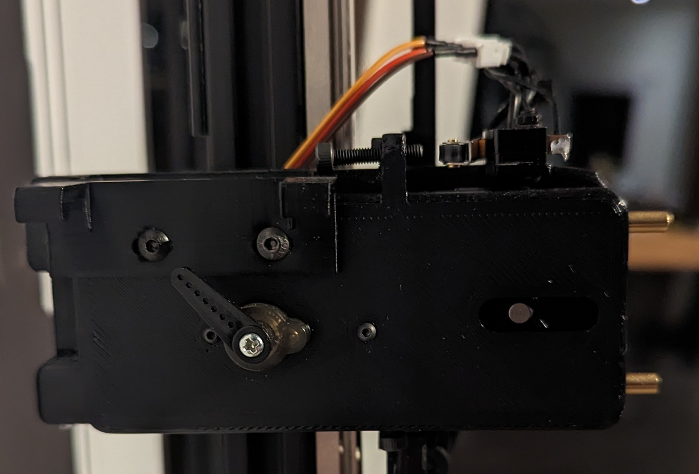

Now, let’s teach it how to hold a pen. Move the pen carriage to a place it will be easy to access. Something like X400 Y700. Then send it the command M3S0 and then M3S100. You should see and/or hear the servo move. If it doesn’t, check your wiring and connections. After the M3S100 command is sent, the servo arm should be in the 6 o’clock position (if on a table) or 9 o’clock if on a wall. In other word, the servo arm should be pointing directly at the drawing surface. Refer to pic below. If it looks like that, then it’s an absolute miracle that you happened to attach the servo arm exactly where it should be.
If necessary, remove and re-attach the arm so it is as close to the above picture as possible. The position of the arm after you send command M3S0 should look like the picture below.
There are two settings in the BESC section of the config called min_pulse_us and max_pulse_us. The max pulse setting will affect the position in the first pic and the min pulse will affect the position in the second pic. Set a lower value to move clockwise, higher to move anticlockwise. To start, just try to get them in the ballpark of the above pics.
The next step is easier with two people, but you can do it yourself if you open the fluidNC UI on your phone or tablet so that you can enter and send a command with one hand while holding the pen with the other. Grab a pen (I recommend a Pigma Micron) and slide it into one of the Micron pen holders you printed out. There will be an M on the holder. Make sure it is slid all the way in. Send an $HZ command and after it homes, send Z8 to lift the slider to a comfortable height. Send M3S100 to “open” the claw. While holding the pen in position (see pic below), send M3S0 to close it.
If the pen can move around after the M3S0 command (too loose), then you need to decrease the value of min_pulse_us. If the servo is squealing (too tight), then you will need to increase the value. Repeat the process as necessary. I think that changes to these settings do not take effect until fluidNC is rebooted, so beware of that. A slight noise from the servo is better than a loose pen. Note that the min_pulse can’t be set below 500, so you may need to position the servo arm to the next clockwise detent if it can’t grasp a pen properly.

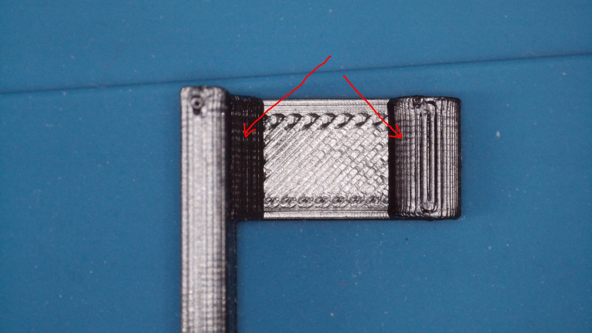

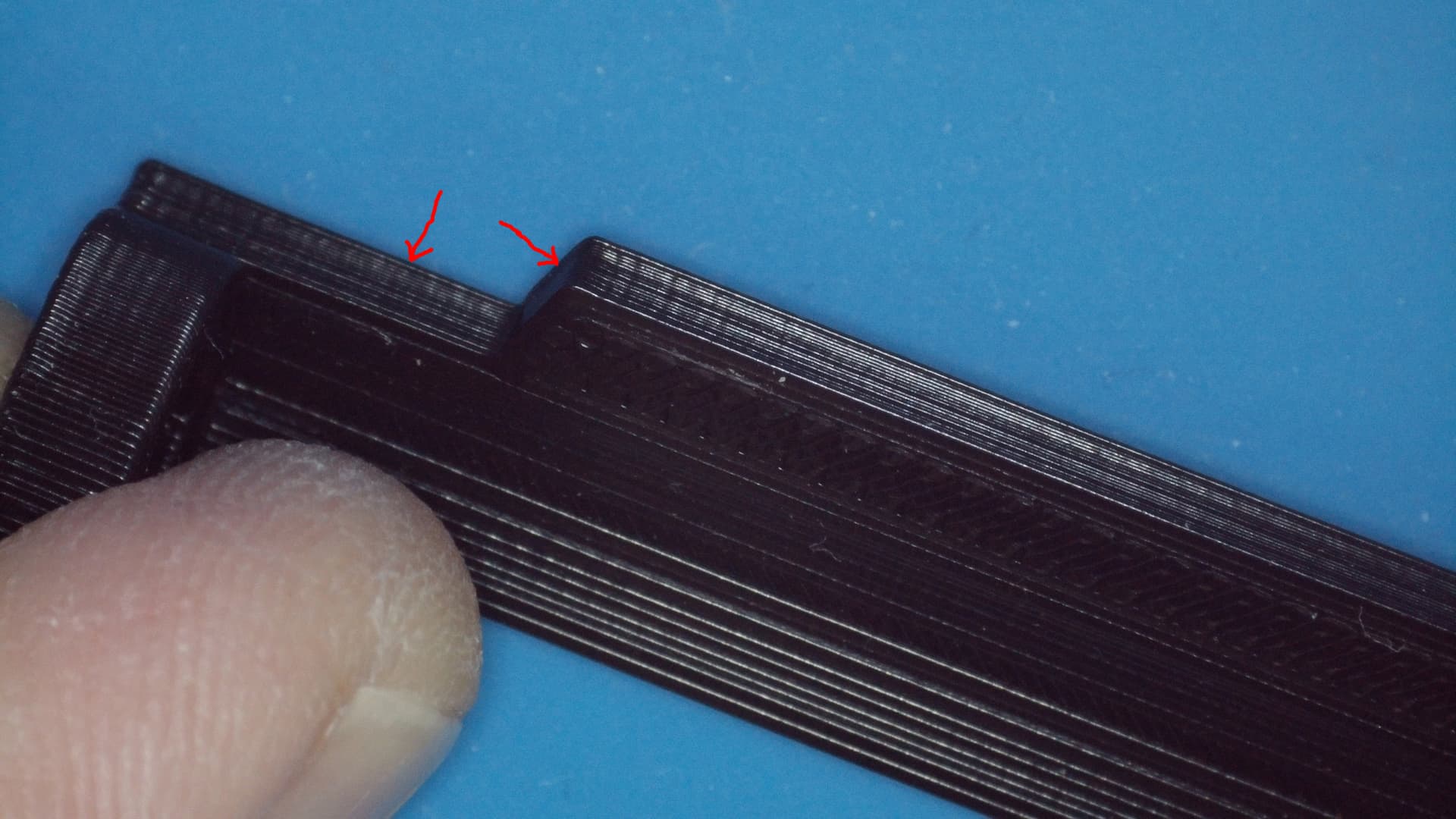

If you have a hard time with tool exchanges, or if they are working but you think they should go smoother, then take a close look at the pen brackets. The first layer of a 3d print will typically have a little ridge. It might help to run a knife or razor blade along the areas that contact the Pen Holder Bracket (part R) to scrape that ridge off. This picture shows what I am talking about. Be sure to clean all the areas where contact occurs…
Check out the Pen Holder bracket as well. It will go a long way if you smooth out any ridges on the contact areas. And if you changed the orientation of the print, the area on the right will likely be very rough. It is important that this part be printed as shown - this would be the view looking straight down at the build plate. It may be tempting to rotate it 90 degrees, but don’t do it. I’ve tried.
That is called an elephant’s foot. Dialing in your first layer would help. But an easy trick is to just chamfer your first few layers in CAD to make those corners too small instead of too big.
I often do it intentionally for adhesion purposes. I like the the chamfer tip though.
IMO, it’s better in that case to just use a brim. With a decent derburring tool, a brim is very easy to remove, and what you’re left with is more likely to be dimensionally accurate.
I’m also a fan of adding mouse ears, if the adhesion issue is just a corner or end of a print that wants to lift up.

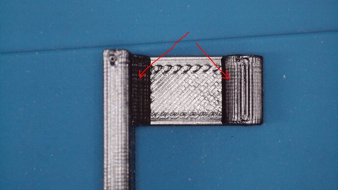

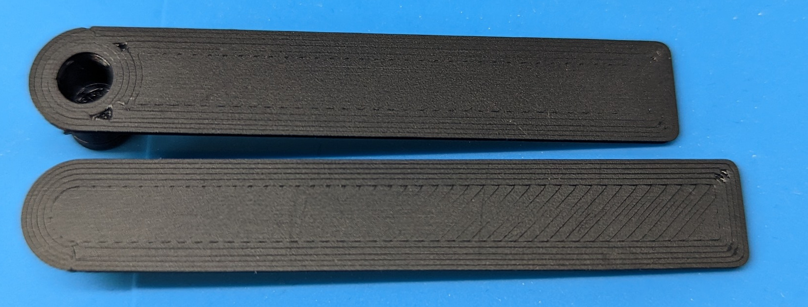

While we’re on a subject that you guys know about, I have this other project I am working on that requires a smooth, consistent first layer surface. I use smooth PEI for a build plate. I have several things going on that I was hoping to correct with slicer settings. Refer to the pic below. The leftmost quarter of the bottom piece is acceptable, as is the rightmost part of the top piece. I’m guessing that the gaps that form as you progress to the right on the bottom piece are caused by a slight inconsistency of the build plate. The small holes in the leftmost part of the top piece are also a problem, but I do not believe they are build plate related. I’m guessing that those happen to be at the beginning or end of a line. Any suggestions?
Both of those could be caused by pressure advance being set to high. Also looks like you could go down just a tiny bit on your Z offset, but that might not be needed. Are you running mesh bed leveling?
No mesh bed leveling. These were printed on a Voron 2.4. It still has the original inductive probe for quad gantry leveling. Which is horrible. I really need to update to a click probe or the voron tap.
