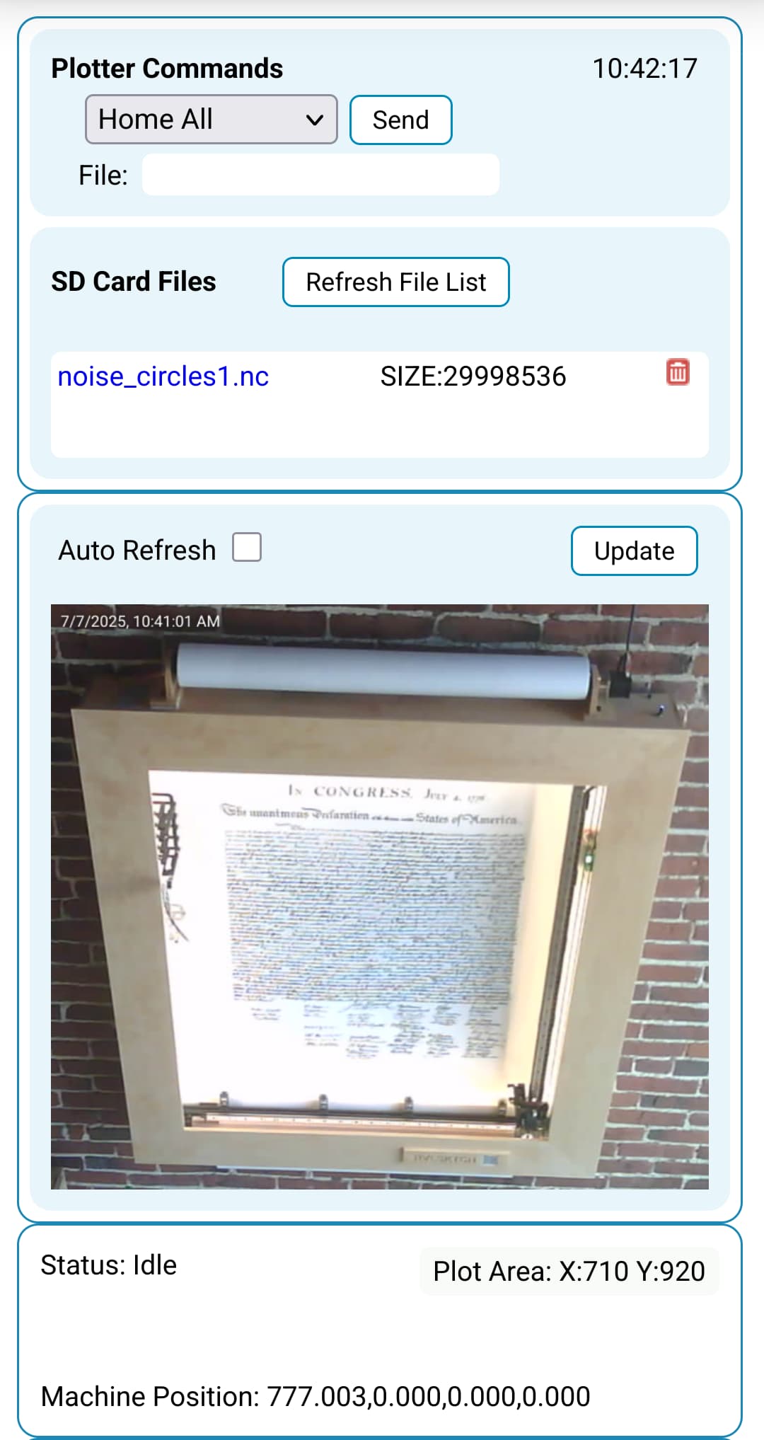

Anyways, here are a few screen shots from my tablet. The first pic is just a tab with a simplified version of the FluidNC WebUI. Only the things I need to operate the plotter. The second and third pics show how I access art that has already been created and send it to the plotter. In the future, I hope to incorporate all the software that I use to create the art into the UI, so it’s one stop shopping – like the Sandify example.

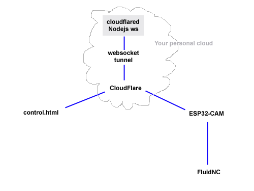

I took this to the next level the other day and thought I’d share. I have wanted to figure out how to create my own IOT cloud for a while now, so this was a good reason to head down that rabbit hole…
Objective: Remotely control FluidNC from my phone from anywhere.
Constraints: No router mods, static IPs or Port Forwarding, etc.
Total cost in parts and services: $6.49
Participants involved:
  • V1E Jackpot running FluidNC w/Local IP Reservation (OK - small router mod here)
  • ESP32-CAM ($6.49 on Amazon last I checked). The ESP32 has a built in camera and SD Card slot. It requires 5vdc. This gets loaded with a sketch called CameraWebServer via the Arduino IDE. I then added two websocket clients to the sketch, one that connects to FluidNC (i.e. ws://192.168.x.x:81) and the other to a tunnel that is set up on CloudFlare (ws://wsserver.mydomain.com)
  • CloudFlare Account (Free) Set up a tunnel as a subdomain (i.e. wsserver) of your main domain (mydomain.com). The tunnel is configured as an http service on the port that the nodejs websocket server is listening on.
  • Nodejs and cloudflared running on a box somewhere. I used a linux server on my home network, but all you need is a pi (or equivalent). I haven’t used it in a while, but Amazon AWS might provide a free instance that you could run this on if you want to avoid using your home network.
  • Control page (html & javascript) running in a browser. This can be a local file if on a PC. Must be dished from a webserver if using a phone or tablet. You could also program your own Android or IOS app.
Overview:
Summary:
The ESP32-CAM sits on the same LAN as FluidNC. All traffic coming from the FluidNC socket is redirected to the Cloudflare socket. Traffic from the Cloudflare socket is forwarded to FluidNC with the exception of image requests. If an image request is received, a current snapshot is taken from the built in camera and sent back to Cloudflare as a binary file. The websocket configuration isn’t suitable to handle streaming video, but it should be able to handle a snapshot every 0.5 seconds or so. I also set up the ESP32-CAM to send an info request (?) to FluidNC every 10 seconds.
The nodejs websocket server (nodejs ws) is configured to forward traffic to all clients except the one it received the traffic from.
Finally, the control.html file sets up a web socket connection to ws://wsserver.mydomain.com using javascript and sends and receives data just as it would if FluidNC were on the local network.
This is basically how any smart device (outlet, switch, cam) that you buy on Amazon works, except here we use our own cloud, so it is more secure and private, and it is configurable to do anything you want, not just what the manufacturer’s app is programmed to do.
Here is a screenshot from my control.html page.
There is a pull down with all the commands I use (home, move to preset positions, select and replace pens, advance the paper, lights on/off, reboot, clear alarm …). I can also run gcode files that are on the Jackpot’s SD card. Feedback is provided via the FluidNC status messages as well as snapshots from the camera. I have not programmed the ability to upload files to FluidNC since this can not be done via the web socket, but there is an HTTP Client library for the ESP32, so I think this can be done by first transferring the file to the SD card on the ESP32-CAM via web socket, then have the HTTP Client on the ESP32-CAM upload the file to FluidNC using http. So, I can pretty much do anything except load pens.
