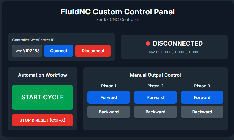

Hi guys. I see a lot of people contributed and shared their experience here. I need some help from you guys. I have a 6x cnc controller (wiki ,fluidnc en/hardware/official/6x_CNC_Controller ). I made a custom automation build with pneumatic cylinders etc. I made a html file with javascript(thanks to AI) it connects through the websocket and sends commands. M codes mostly. What I want is load this html into the board so wont need my computer. I can connect with a tablet. How can I do it?

You upload it using the File management button on the FluidNC tab of the webUI.
You should create a new thread but FluidNC won’t quite do what you probably want it to. While you can upload the HTML file, it won’t serve it as a webpage unless you name it index.html or index.html.gz. However, that’s going to completely replace the existing WebUI.
With WebUI v3, you could create a custom extension. That would require changes to what you have because you wouldn’t manage a websocket yourself. Honestly, you could just use the existing WebUI and create some macros.

I can change the name as index.html.gz. I dont mind to lose fluidnc interface. My build is not a cnc machine. In the future i will add a stepper but i will send command on my end. basic commands go 20mm forward etc.

On WebUI v3, this can be done, but you need to use the extension API.
So, if you do this, you lose the ability to easily configure FluidNC. You would only name it index.html.gz if you gzipped the index.html file. I haven’t actually tried this but it should work in theory. However, I’m not sure if there are other things you’d need to deal with then. You could leave the existing index.html.gz file (which is the WebUI) and upload it as index.html. Then you could rename index.html or delete it to get the WebUI back.
Normally, I would say to upload the file via the WebUI but you’re going to lose that. So, you would want to do it through either the web installer or FluidTerm. It needs to go on Flash memory.
