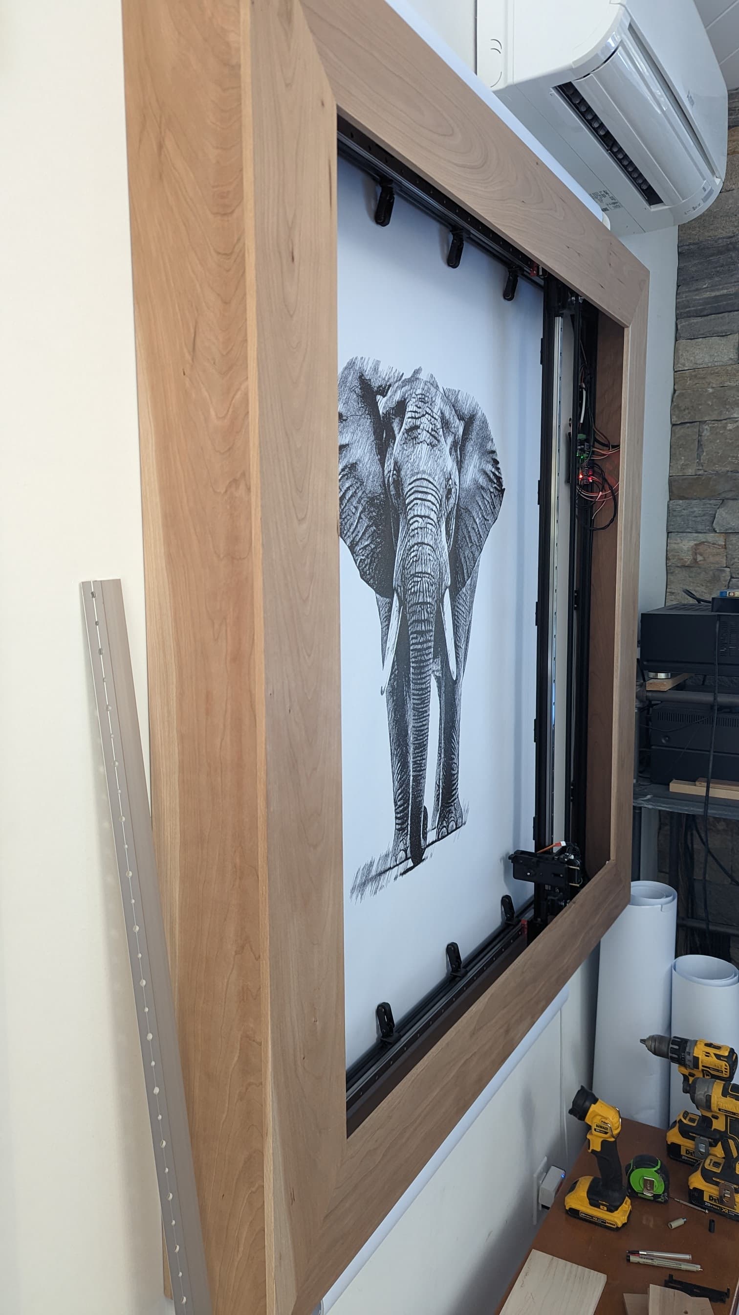

There were some questions about the wood frame. Obviously, there are many ways you could improve the aesthetics of the plotter so do whatever, including no frame at all. I wanted to do something to help keep little fingers from getting into the lower belt, so this is what I did. It’s not perfect, but it helps. I used 1x6 boards for all eight pieces of the frame. They were planed down to 10mm to reduce weight. I was worried about the miter joints on the frame’s face opening up over time since I live in an area with fairly large humidity swings from one season to the next, so I experimented with a clamping system that has worked really well.
These are pictures of a maple frame that I am making for a plotter that uses 30" paper. The corner joints on the box are simply glued and fastened with 18-gauge finish nails. I mounted a 30A power switch in the top corner. Also, notice the slot along the top back for paper. There is a similar slot on the bottom.
Here you can see the miter joint brackets on the frame’s face as well as one of the angle brackets used to hold the face assembly to the box and finally some led strip brackets. The four pieces of the frame’s face can be disassembled and removed.

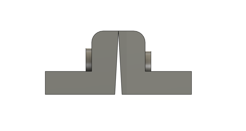

This is a side view of the miter brackets. Each side is attached to the frame using three #6 x 1/2" screws. The faces of the brackets are angled, so when the socket head screws are tightened, the miter joint is pulled tight. The bracket also keeps the wood faces flush when humidity swings encourage wood movement such as cupping and twisting. If the joint starts to open, a simple turn of the socket head(s) will pull it back together. If you use the uploaded 3d models, take notice that the two sides of the brackets are different. One side is intended for the hex nut and the other for the socket head.
The led strip brackets have a small tab on the back designed to tuck wires under to keep them organized. If you have all the lights on one switch, then you won’t need that, but if you have the top & bottom on a different switch as the sides, then it will come in handy.
