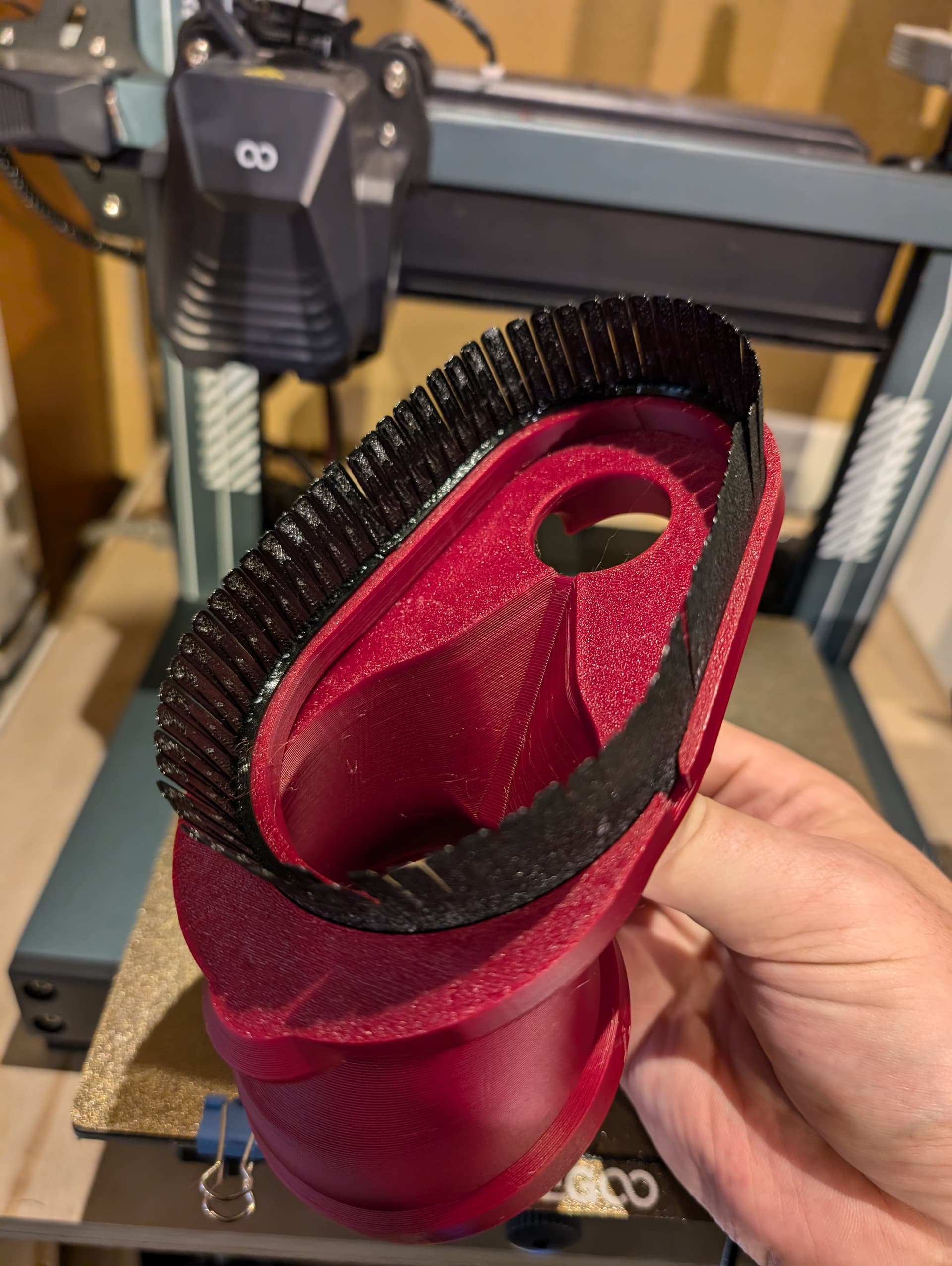

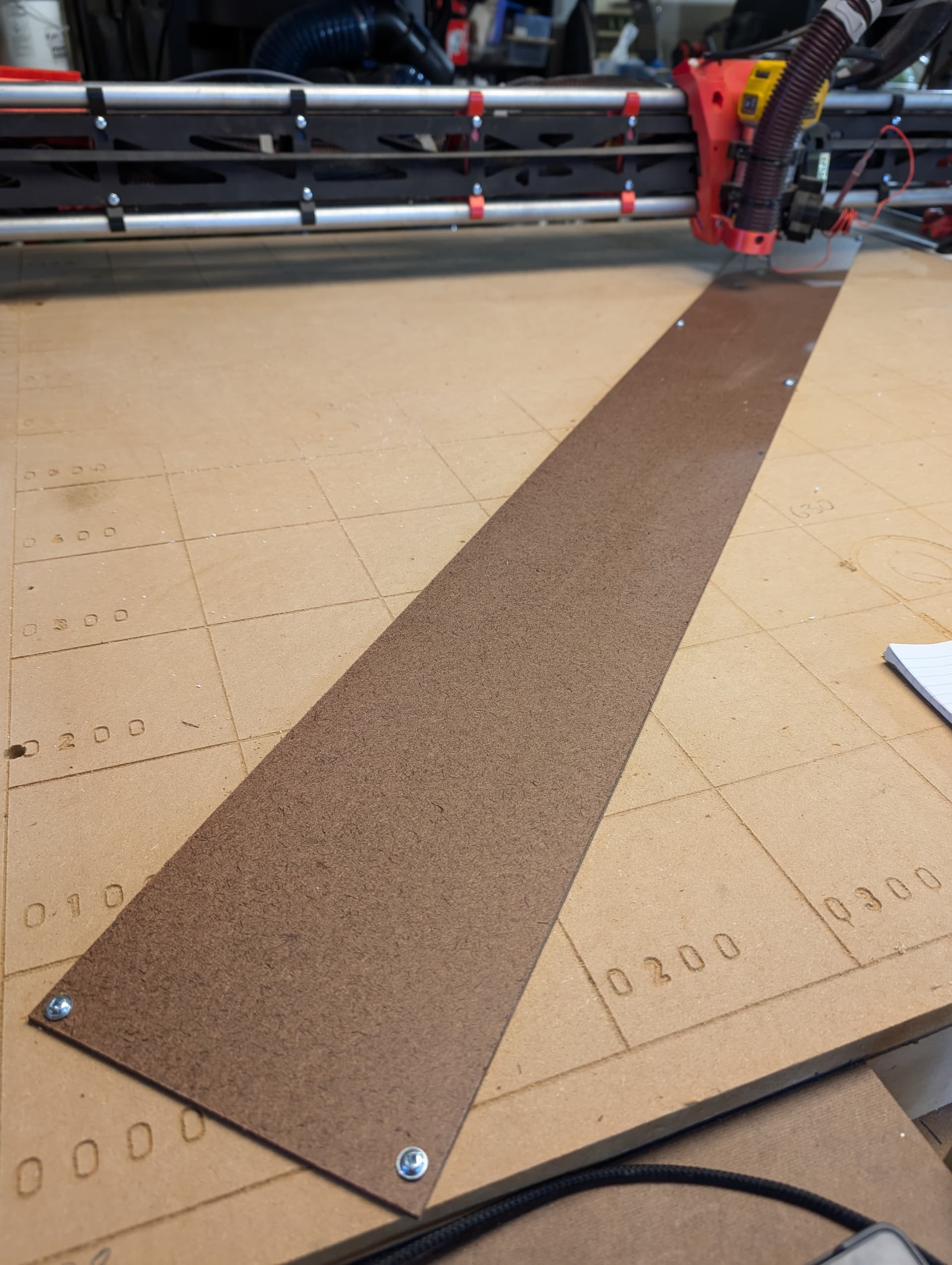

Ran the calilantern calibrations (other thread Calilantern Experiences (for LR3->LR4 upgrade) ). Printed the core (10 hours on Elegoo Neptune 4) and other parts in Elegoo PLA Pro which claims to be more rigid than their normal PLA. Printing the braces in PLA on my old printer in parallel.

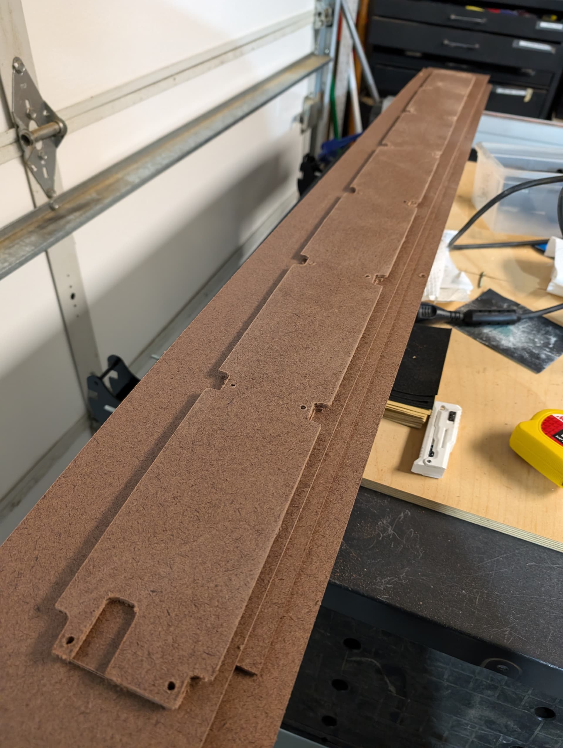

Cut the LR4 struts diagonally. Something was off though, the core was tilting during the cuts, but they came out well enough (holes seem accurate, test fits OK on a brace.)
Not shown: I converted the svg files from the strut generator :man_dancing: to dxf with Inkscape, which was how I made Fusion 360 import them so I could separate, rotate 45 degrees and test fit them, and exported 2 files. I can post them here if desired when I get home. I use EstlCam 12 for generating the gcode.
This is the universe telling me that it’s a good time to upgrade: upon teardown I discovered my LR3 Core has two delaminations! I won’t be using that “metallic” pla again. Explains the tilting weirdness.

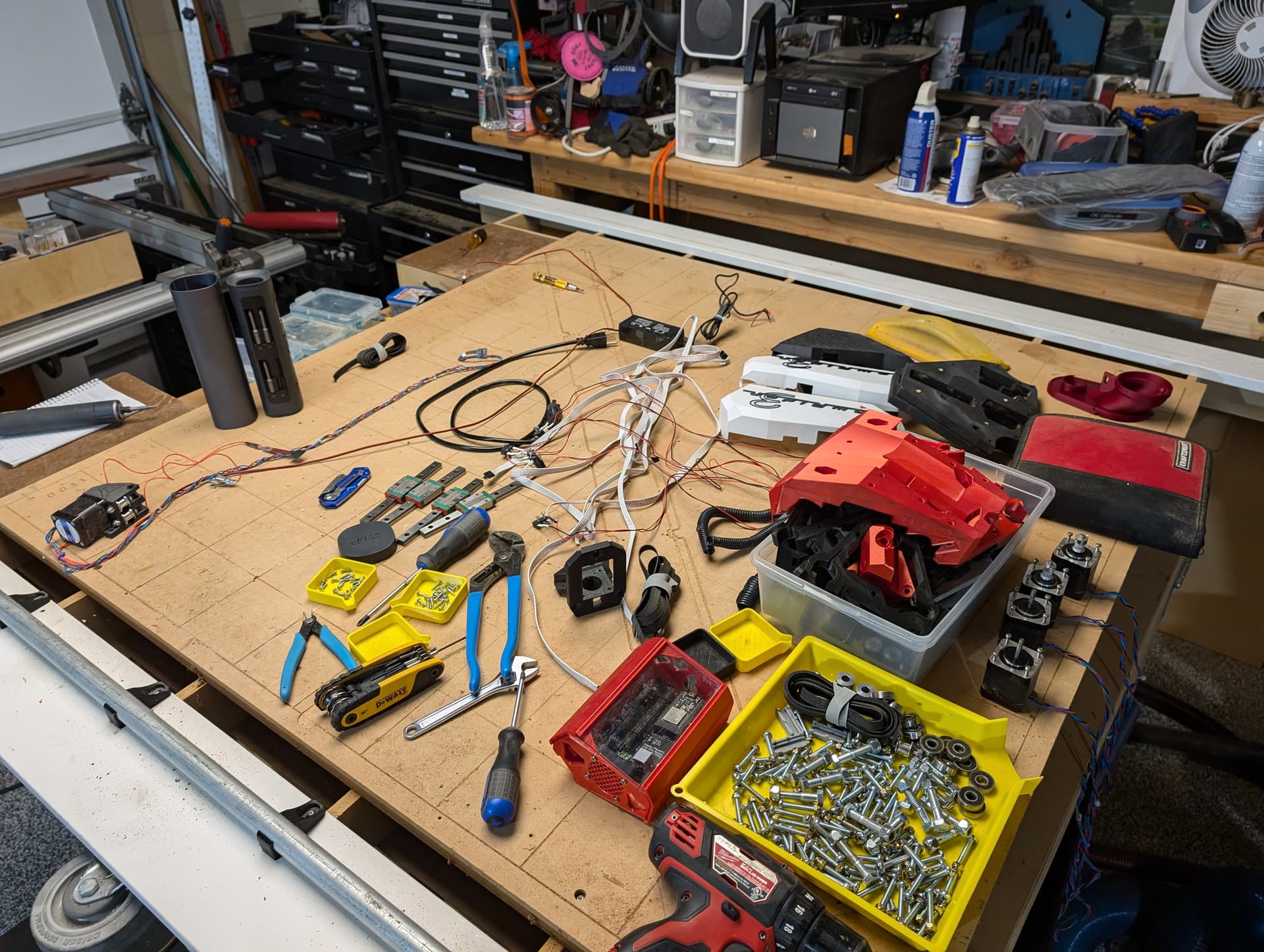

Teardown complete. Ryan’s table design will hopefully not need adjustment for the LR4 other than a new thicc Y rail. Bought 1" EMT conduit. Next is assembly. Sounds like the Core assembly instructions will be out any second now. (edit: refreshed, and there they are! Woohoo)

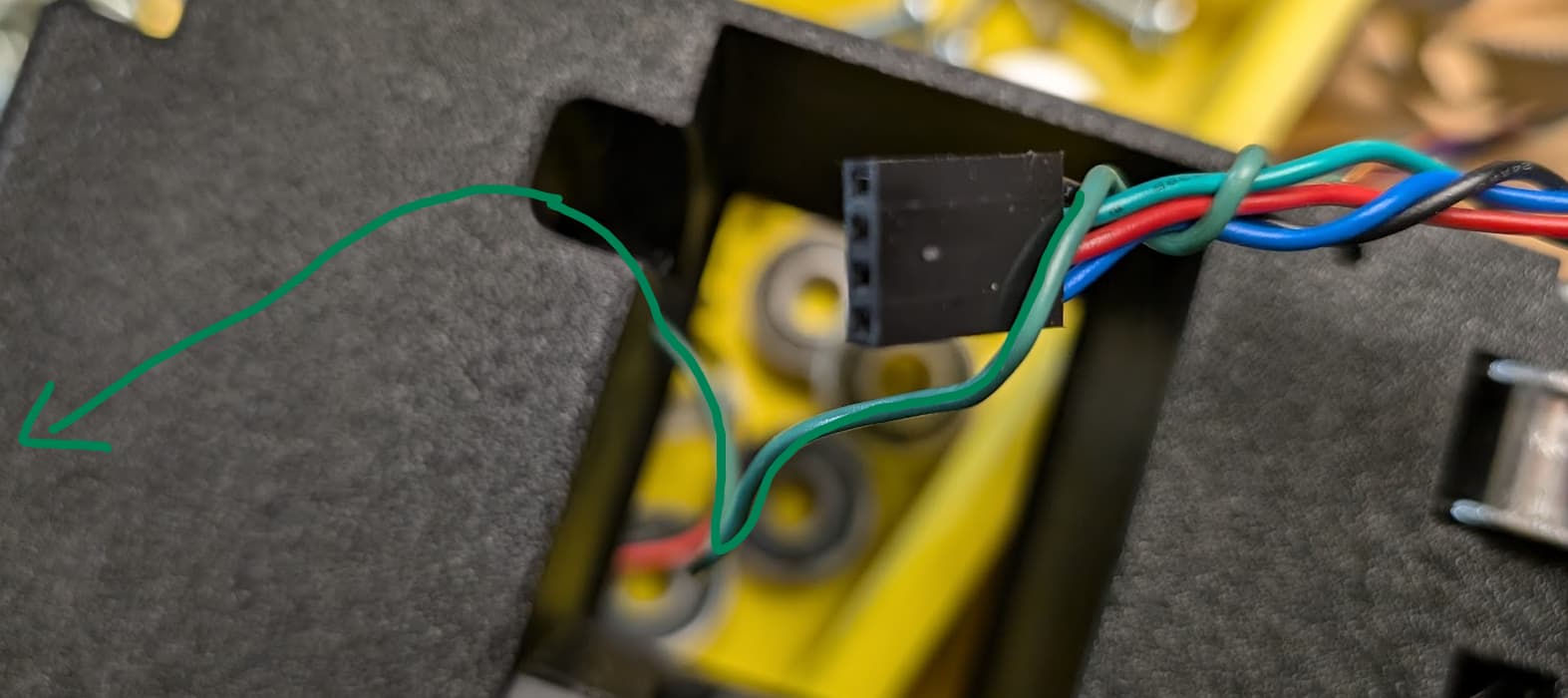

Good progress tonight, couple tiny tips: my biggest “pain” was getting the Z stepper motor wires through the “tunnel of love.” I had to feed a solid core wire in, wrap it around the end, and pull it back through, which worked fine. It’s probably because I have my motor wires twisted. Oh, and remove any little zip ties you have on your stepper motor wires, or they will bind up or prevent the other wires from sliding through.

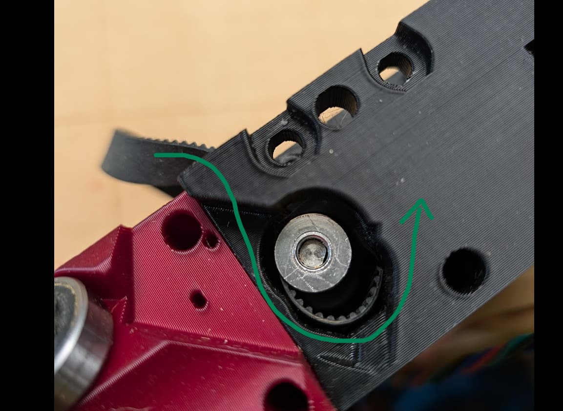

Other “tip” is that is easiest to feed in the Y belt in this direction. I tried the other way, it was hard.

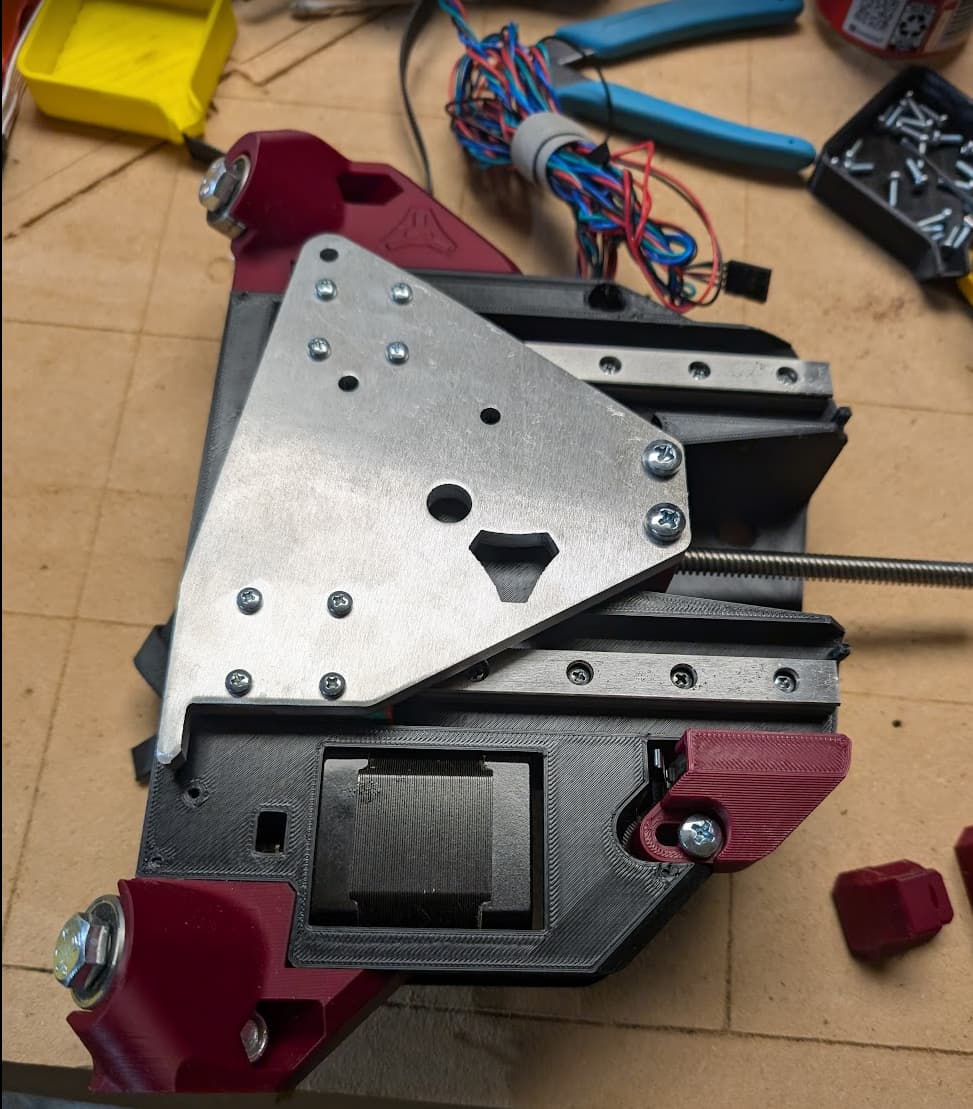

Finished the other “cheek.” Getting the last Z motor wires through was tough, but the solid core wire “fish tape” trick worked again. Not sure why its such a tight fit, seems like it is the connector squeezing through (wires relatively loose when it’s pulled through.) Love the internal wire routing!
To protect the microswitch levers, I prop up that side on the nice soft bundled belts. Somehow during disassembly of the lr3 I lost a lever, so had to order a new sack of switches.
Total labor so far about 2 ish hours, not counting teardown of the lr3.
I am intrigued by the two piece Z axis connectors. Excited to see how that all goes together, considering that was my most problematic axis for lr2 and lr3.
