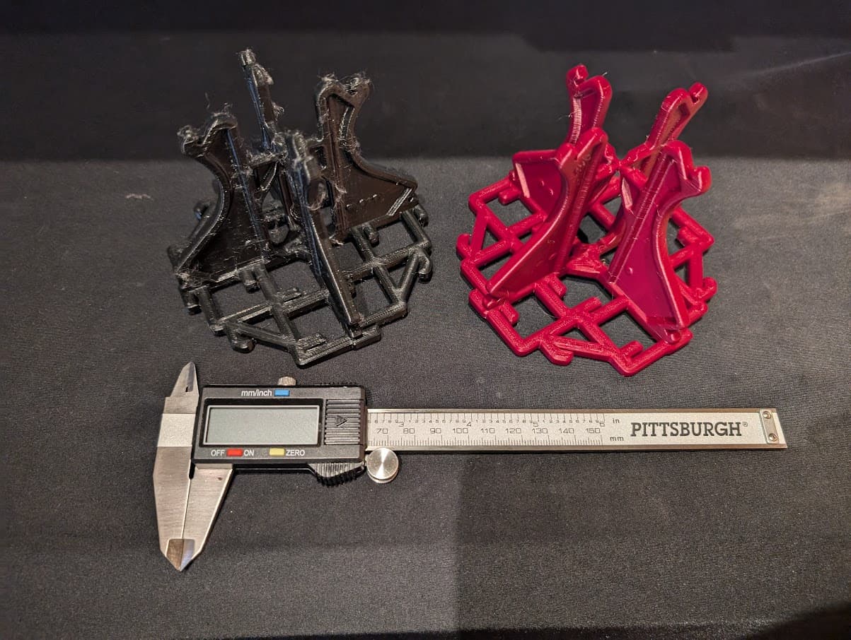

  3. Using my somewhat crappy Harbor Freight digital calipers, measured the calilantern as instructed, 3 times (starting over each time, 1-14, 1-14, 1-14.) I had a few “off” measurements which the the excel sheet flagged as suspicious, so that was cool; I re-measured and all was green checkboxes.
  4. I mistakenly tried to measure the lantern by referencing from above, not below. I basically had it rotated wrong. Started over. Hold it “upside down” when you measure it.
  5. Result 1: Not great, not terrible :radioactive:

  11. All good! Printed second Calilantern in PLA Pro, layer height 0.16. 4 more hours. Pictures look hairier than reality, stringing wasn’t so bad (have since ran the OrcaSlicer retraction calibration and set retraction to 0.3mm which seems to have fixed it.)
  12. Create a new spreadsheet labeled #2 so I don’t accidentally overwrite it. Zero out all the values. Measure. Measurements showed that improvements were made! Result 2:

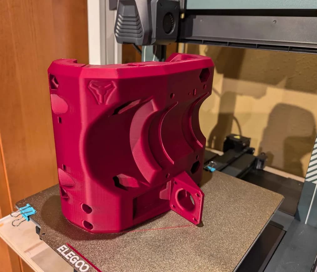

  13. Run auto bed leveling again. Set the layer height to 0.28. Maybe this will throw things off a tiny bit, but I think skew is skew, so should be fine. Print the Core, .28 layer height takes 10 hours 20 minutes. Beautiful!
  14. I realized that the spreadsheet #2 can take in Existing Calibration values, and make refining tiny adjustments, but this is after I’ve printed the Core (which seems perfect, test fit a few nuts and the stepper, glorious.) So, I’ll just do it for the next parts.

  16. I should probably print yet another Calilantern (maybe at the .28 layer height, would be faster than 4 hours) to see where I am now, but the Core results were so good that I think I’ve reached the limit of my crappy HF calipers.

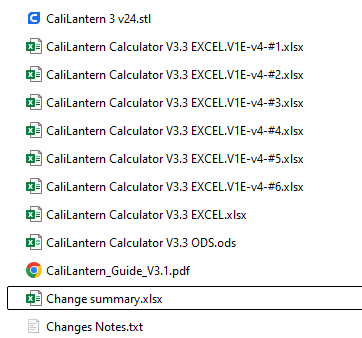

Below is a summary of my understanding of the sections in the spreadsheet. Hopefully this info helps, however, I strongly recommend reading through the Calilantern .PDF. The .PDF covers bunch of stuff that’ll save you time overall.
  • Existing Calibration section where you enter dimension/skew information you’ve currently configured for your firmware (e.g. Marlin or Klipper):
  • Measurements section containing a table where you enter measured dimensions:
  • Results section showing overall score, helping to gauge how far off from ideal you are. Shoot for 950+, but prints in low 900’s seem to be fine.
  • Fix Skew and Fix Size sections provide actionable guidance on what configuration changes to make to firmware configuration, and slicer configuration.
To help track changes, I ended up saving a snapshot of each test iteration. This paranoia paid off and helped me track down and root cause an embarrassing copy-paste error I made. So, consider saving snapshots too, backup via github or similar.
